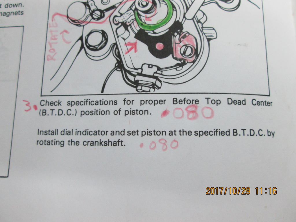

Retired Wrencher 6,375 #6 Posted October 28, 2017 Bttatro it is like KC9KAS said the key way is very important to the timing. I have the # for it if you need it. Timing is easy also as long as you have a magnetic base for the dial gage. I have the process for that also if needed. Good luck and enjoy the project. Share this post Link to post Share on other sites
Bttatro 94 #7 Posted October 28, 2017 @Retierd Wrencher Any info you have would be great. Thanks everyone. Share this post Link to post Share on other sites

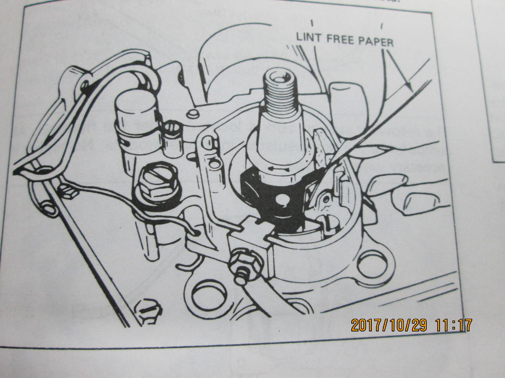

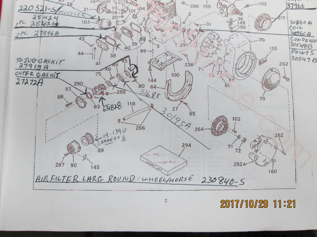

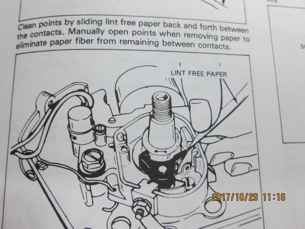

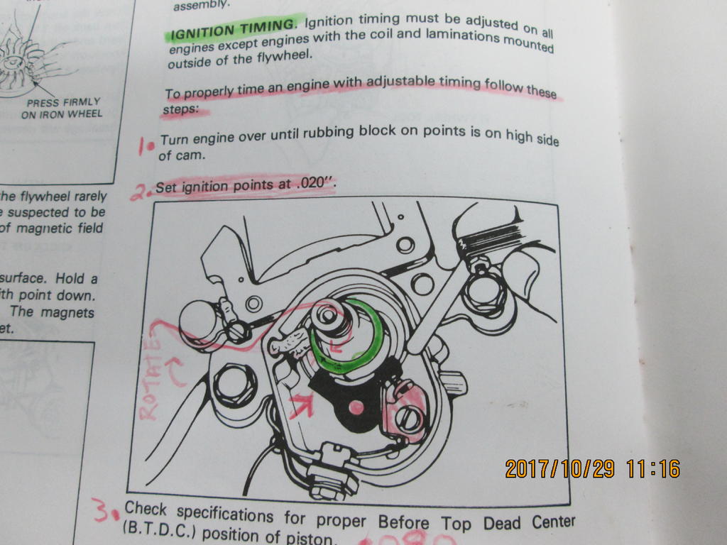

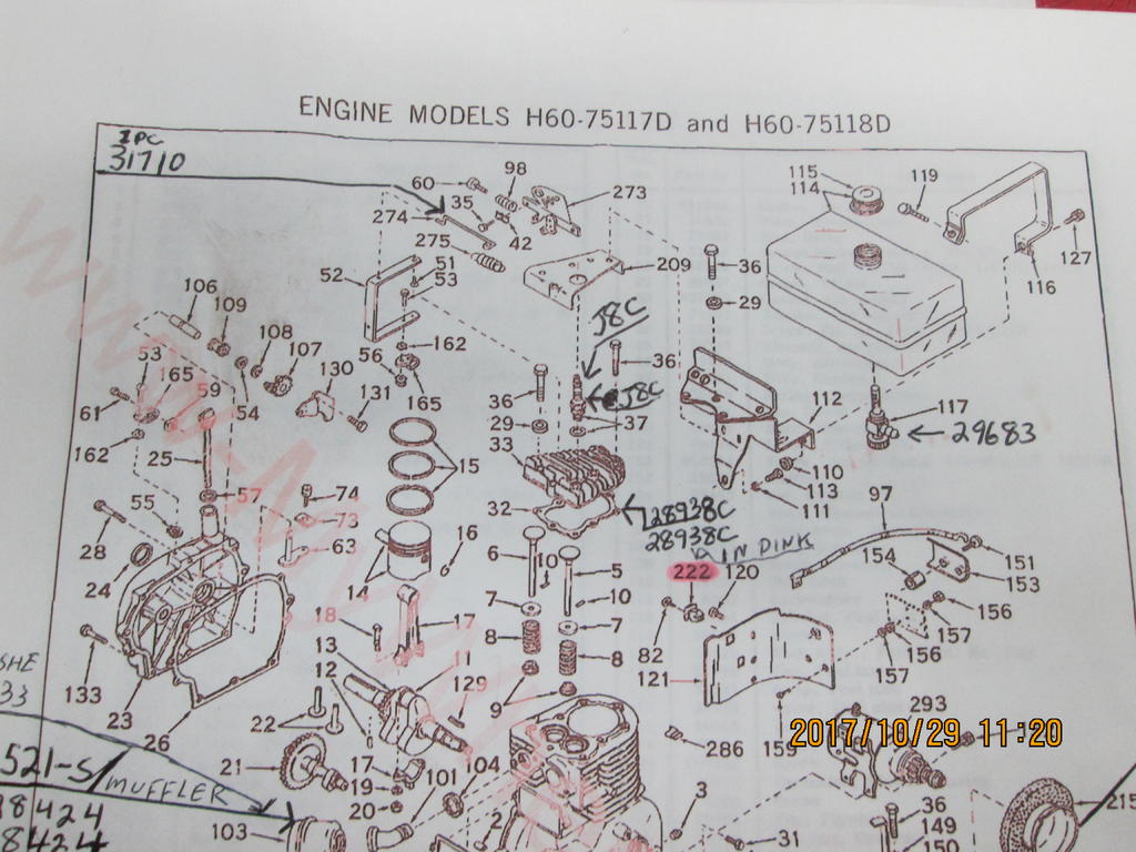

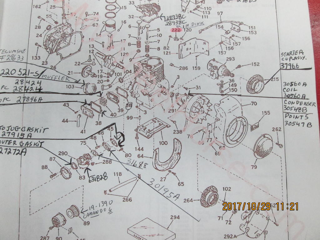

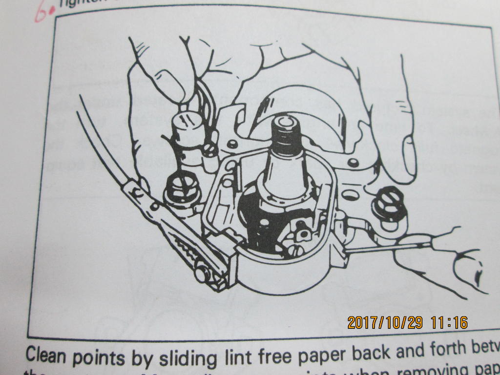

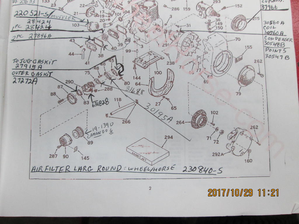

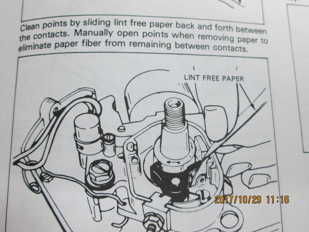

Retired Wrencher 6,375 #11 Posted October 29, 2017 (edited) Bttatro I hope this helps. Let us know if you have any questions. Dis regard this>>> MVI_0780.MOVMVI_0780.MOVI did not get all the #`s let me know what you would like to see I will redo them.>>>>>MVI_0780.MOVMVI_0780.MOV. Edited October 29, 2017 by Retierd Wrencher Share this post Link to post Share on other sites
