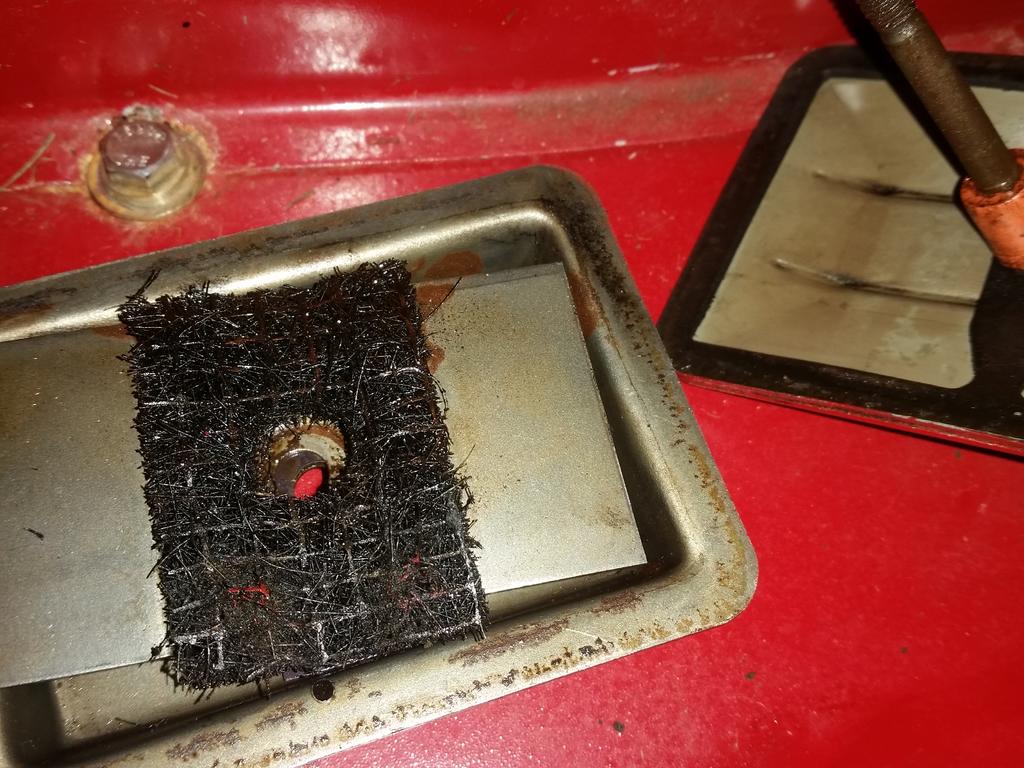

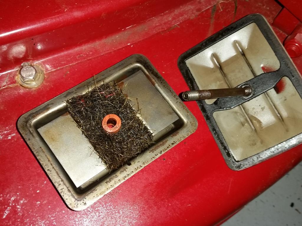

AlexR 3,137 #38 Posted October 21, 2017 Can anyone tell me why there are little puffs of smoke coming from a louver right under the carb? Share this post Link to post Share on other sites
JimmyJam 542 #39 Posted October 21, 2017 That is the cover to the oil breather. Inside you see a small mesh-like filter. You can buy them. Share this post Link to post Share on other sites
AlexR 3,137 #40 Posted October 21, 2017 4 minutes ago, JimmyJam said: That is the cover to the oil breather. Inside you see a small mesh-like filter. You can buy them. That makes sense thanks! I probably need to check my compression now.. make sure its not low and blowing back into the crankcase. Share this post Link to post Share on other sites
Ed Kennell 47,807 #41 Posted October 21, 2017 Looks like a good time to take the breather off for a cleaning. And check the valve clearances while you are in there. Make sure you put the breather back together correctly. Check the manual....do not assume the PO put it together correctly. 3 Share this post Link to post Share on other sites

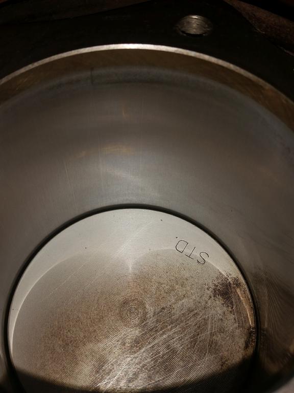

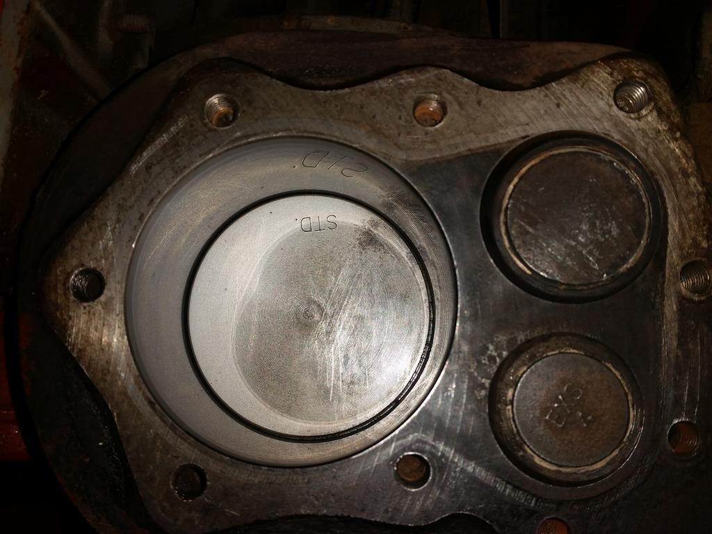

AlexR 3,137 #43 Posted October 24, 2017 Removed the breather checked it checked valve clearances it was in spec .008-.010 for intake and .017-.019 for exhaust checked compression it was 70 psi so I took off the head and cleaned everything there was a bunch of crap that I cleaned off lightly ran some high grit sandpaper around the valves to clean them off put head back on (i know I used the same headgasket) but compression was the same after I was worried until I read the manual which said its hard to get accurate reading because of the automatic compression release. Share this post Link to post Share on other sites

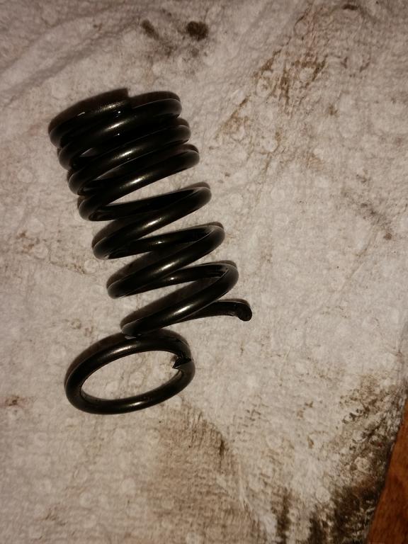

AlexR 3,137 #46 Posted October 27, 2017 Bought some stuff for the tractor today gotta wait for it to ship here but once I get it I will have quite a bit to post. Got a air filter, sparkplug, headgasket, a cheap carb gonna see if it works if not I will use the gaskets from it. (Don't worry I will keep the old carb and probably get rebuild kit for it later) and I got a valve spring for the intake because it looks like it collaped a little. And I did add seafoam to the oil as it looks like there was some moisture in the engine. I confirmed the exhaust valve lifts a little bit on compression stroke which is why my compression reading is not good. Glad its not the rings. Also cleaned the breather the reed is still good as well. 1 Share this post Link to post Share on other sites
AlexR 3,137 #47 Posted October 27, 2017 I stand corrected just removed the spring.. it is broken, good thing I bought one. 1 1 Share this post Link to post Share on other sites

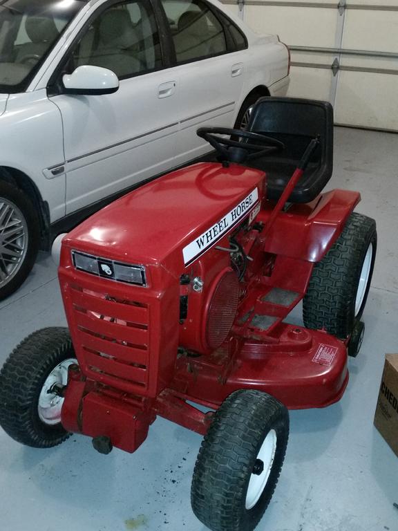

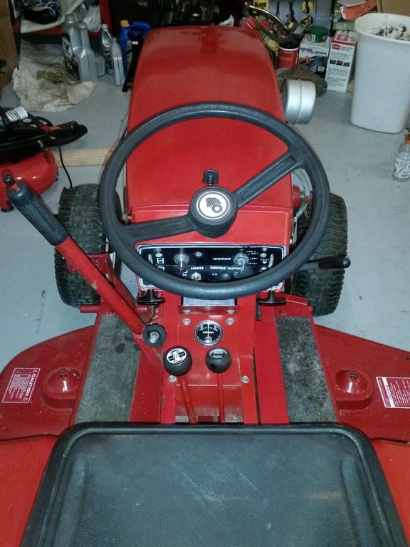

AlexR 3,137 #48 Posted October 28, 2017 Cleaned up the horse today. Really cleaned off the steering wheel. And worked on the wiring a little bit. Just waiting for parts right now. 4 Share this post Link to post Share on other sites
Sarge 3,473 #49 Posted October 28, 2017 Aerospace 303 will keep that seat and wheel like new for a very long time . Nice 120 , btw... Sarge 2 Share this post Link to post Share on other sites
