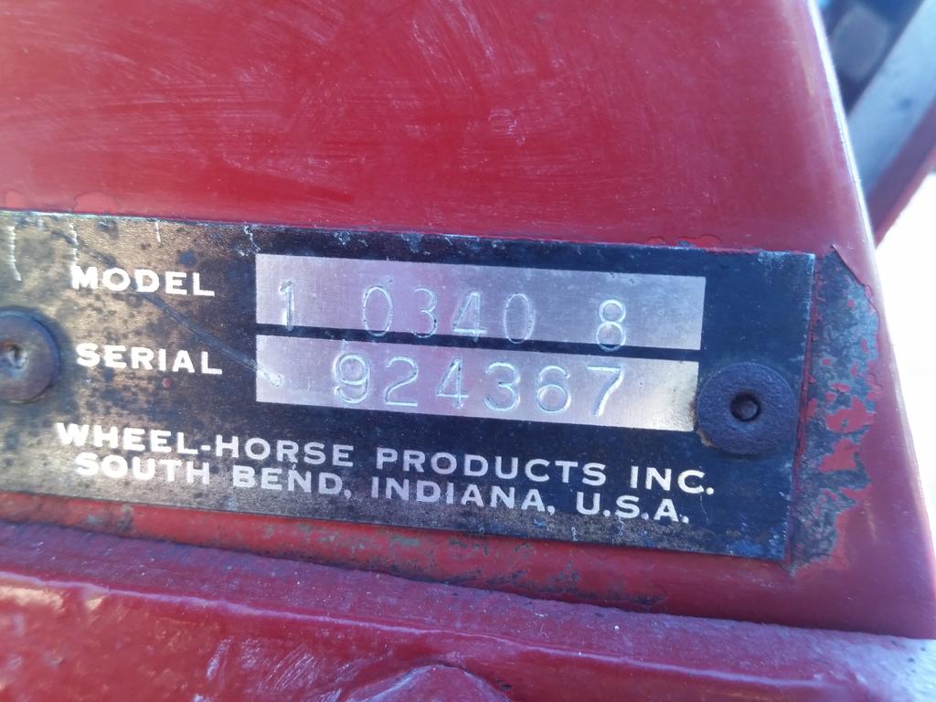

608KEB 854 #2 Posted October 17, 2017 Is there a ID Tag? It's on the left side of the tower. 1 Share this post Link to post Share on other sites

AlexR 3,137 #17 Posted October 17, 2017 19 hours ago, 608KEB said: Is there a ID Tag? It's on the left side of the tower. 10 hours ago, 953 nut said: That is a fine looking unit, obviously well cared for and ready for a few more decades of service. If you add some Seafoam to the gas it will probably help. Also, only use non-ethanol gas, the ethanol does nasty things to the fuel system. I probably will use seafoam sometime as and I will probably take the carb apart sometime as well to see if its all clean and passages are clear as well as inspect the gaskets. 10 hours ago, Racinbob said: Interesting. That's a 76 or 77 based on the steering tower, solid mount engine and no hood ornament but the hood decal looks to be what they used starting in 78 but shortened probably to eliminate the model designation which was on that decal at the time. Outstanding looking machine. In addition to what Richard suggested check the points. I checked the points a little last night I need to buy a feeler set though to set them. 7 hours ago, Ed Kennell said: Really nice C-120. Any welder will be able to lengthen that plow frame or there are extensions made for the 520 tractors that just might work. Yeah I will probably weld it myself whenever I get fed up with not being able to rotate the plow, I do professional snowplowing in the winter so it will probably irrate me haha. 7 hours ago, WHX12 said: Holes are there for it Bob... no matter ... but someone at some time has loved that tractor, very clean looking! Sounds like you did good on the price too! Any chance that could be a plow for a short frame fellas? I know nothing about the different plows made through the years. Carb may need cleaning/adjusting or seafoam as Dick suggested. LOL I think he drains his oil INTO the pan like yer supposed to Pete! My pan has runneth over No I can see where someone cut it and rewelded it as well as the mounting brackets are homemade. The house is actually my father-in-laws he built a new house so I am renting his old house from him. So its a matter of time before that floor gets kinda dirty haha 1 Share this post Link to post Share on other sites

Racinbob 13,275 #21 Posted October 17, 2017 Yup, a 73 'no name'. Most definitely a mixture of years but what the heck. That's one of the wonderful things about Wheel Horses. Parts interchangeability as well as attachments. I've already had many comments about the fact that I'm running a 76 1948" mower deck on my 2005 and the 42" deck from the 2005 on the 1976. 3 Share this post Link to post Share on other sites

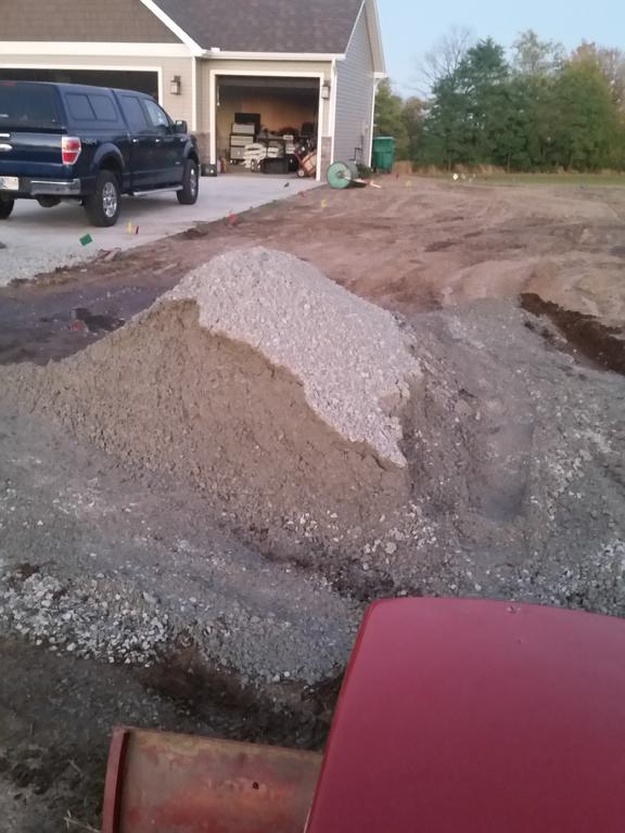

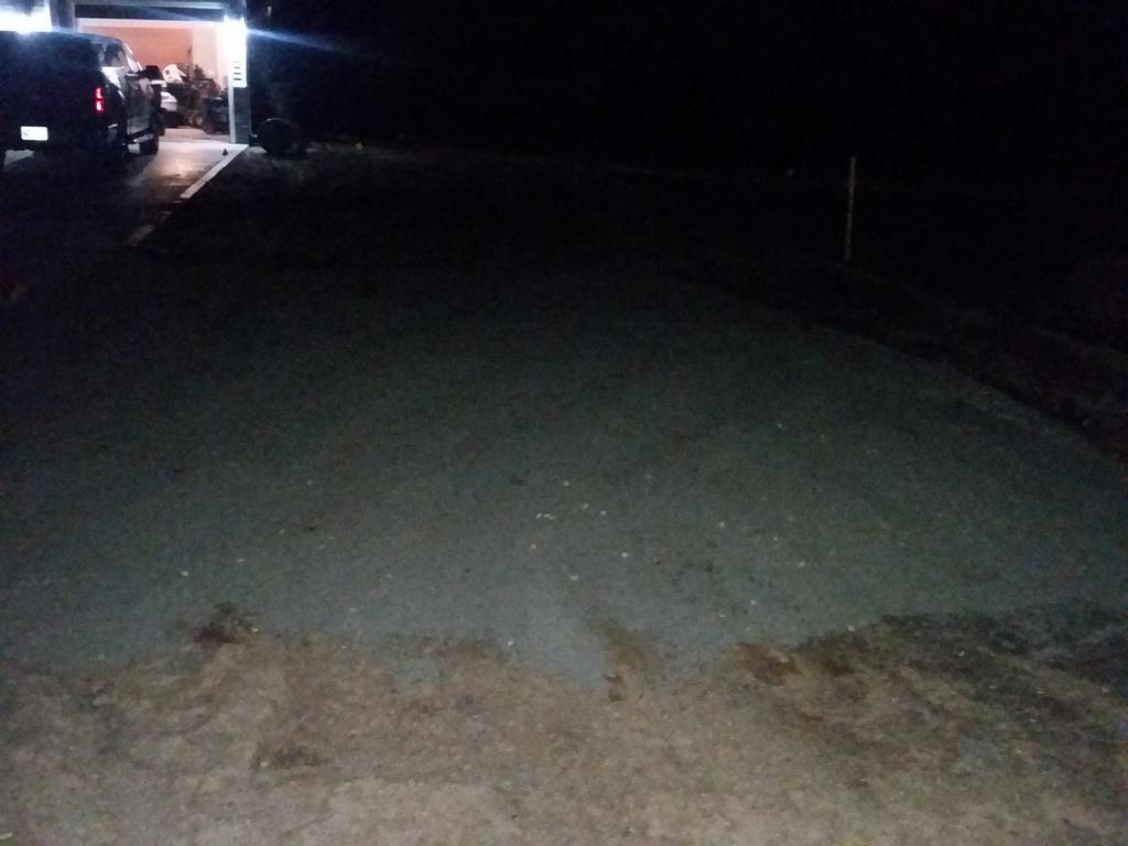

AlexR 3,137 #23 Posted October 18, 2017 1 hour ago, ericj said: sorry I looked and didn't see the latch lever for the pan to flip. I'm use to the Auto not the 8 speed, when I looked closer I see the latch on the left side on the frame rail side panel. I have a 73 12-8 speed that's been on the back burner for way to many years, but it don't look god to get to any time soon, some day though, good luck and by the way it is a nice looking tractor eric j Yeah its easy to miss. Thanks! Pushed some limestone for my father-in-law tonight. So at 0 choke the engine cuts out pretty bad and between 1/4 and 1/2 choke it runs good other then a little sputtering and when you idle down it sometimes really sputters and died once or twice. 3/4 and full choke are pretty much what you would expect from being choked. 1 Share this post Link to post Share on other sites
AlexR 3,137 #24 Posted October 18, 2017 1 hour ago, Racinbob said: Yup, a 73 'no name'. Most definitely a mixture of years but what the heck. That's one of the wonderful things about Wheel Horses. Parts interchangeability as well as attachments. I've already had many comments about the fact that I'm running a 76 1948" mower deck on my 2005 and the 42" deck from the 2005 on the 1976. So its not actually a C120 then? Probably someone put those stickers on? Would explain why all the stickers look so good. And its 14hp? Share this post Link to post Share on other sites
Racinbob 13,275 #25 Posted October 18, 2017 Probably not but it doesn't matter. The decals are newer and some parts swapping has gone on but there's not many 40+ year that haven't seen that. Info off the engine sticker would tell us what HP it is. Share this post Link to post Share on other sites
