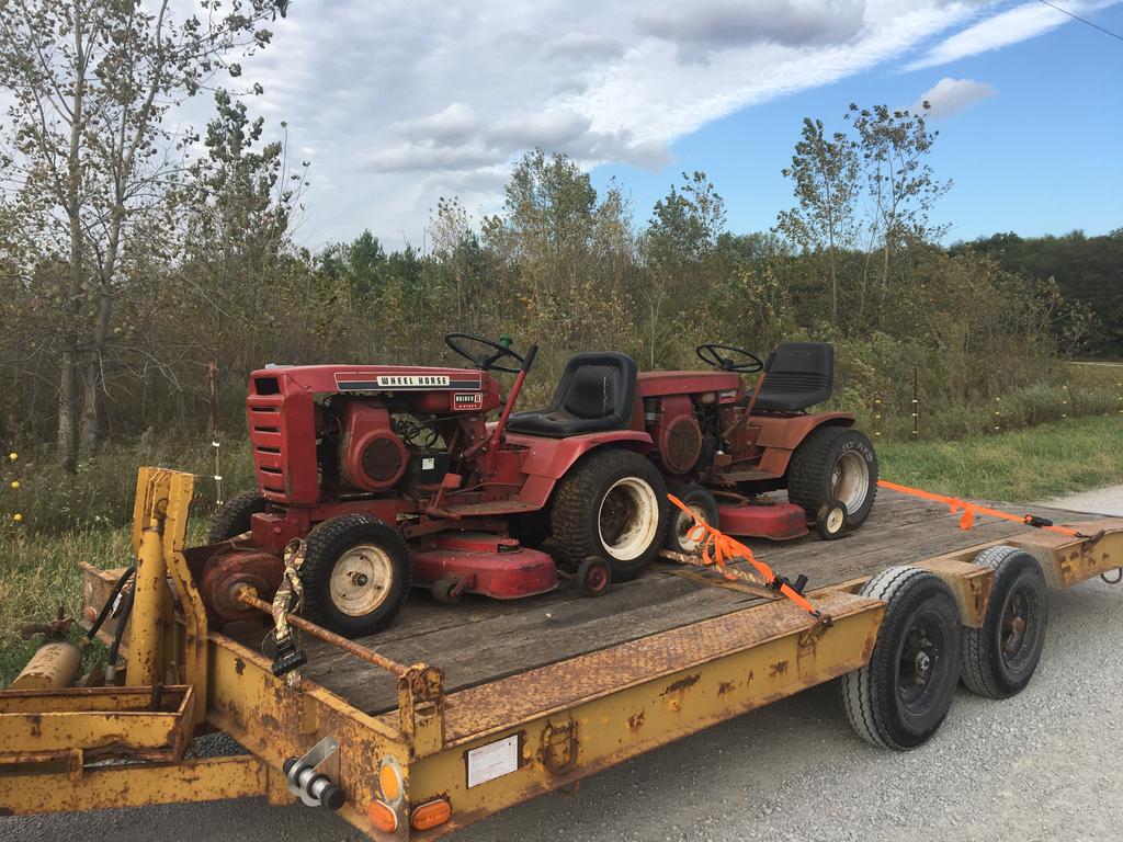

Hey all,
i recently picked up a Raider 8 and and Charger 12 to add to my small but growing collection. Both need restored including paint and I have never had much painting experience when it comes to auto paint. Can someone give me some helpful tips on prep , like if i need to strip it to bare metal or not and what colors to use? As well as how to mix the paint with hardener and clear coat.

Can't answer your questions, but I would love to have any of my :wh:'s look as good as the one in your first picture...
I think I just got lucky and found a good one! It's even original paint!

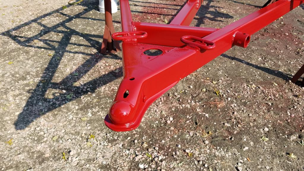

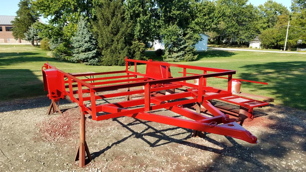

Took a gallon and 3/4 of IH Rustoleum Red Implement paint to get this trailer done -
A buddy brought his mid size Kubota over yesterday and I rigged straps/chain to pick it off the jack stands to set it back on terra firma - no damage to the paint due to the added hardener . In another month or so , it will be fully cured and tough as nails .
