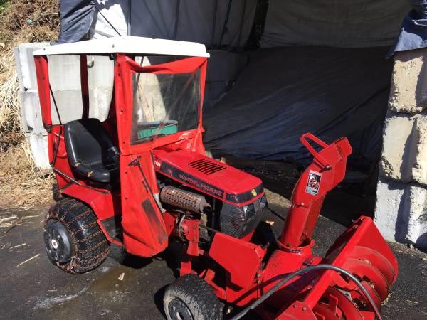

Steve_O 25 #17 Posted October 11, 2017 (edited) Seller was asking $800 for 520h w/ 44" blower, basically unused plow, f/r wheel weights, chains, aux fuel tank, 9/17 battery, and cab (minus one door). 600 hrs and change. Compression 127/125 psi. The bad: One tire doesn't hold air for more than 2 min. Doesn't run on idle circuit (bounces off governor). Some wire-nuts on the electronics (someone's been in there). Has been exposed to elements.. has sat unused for years. Hydro was low. Spins the tires after filling. Need to print off the manuals. Fwd is not fully engaging hydro cam. I'm guessing I need to lengthen the tie rod between motion control arm and brake pivot. Edited October 11, 2017 by Steve_O 2 Share this post Link to post Share on other sites
ericj 1,580 #18 Posted October 11, 2017 don't sound like a bad deal, I personally don't think you will go wrong at the price if you are capable of doing some of the repairs your self that need done. at that price you are almost buying the attachments and getting a free tractor. there has been several 2 stage blowers listed in my area in the $ 650.00 range and they have disappeared, so either they were sold or the add was pulled, this is just my opion and you know what they say about them they are like a body part that everybody has eric j 4 Share this post Link to post Share on other sites

Searcher60 209 #20 Posted October 12, 2017 (edited) Looks like a 1996 anniversary edition. At that price buy it, that is low hours, NOW! But, if you have to pay someone to do the repairs, it's going to cost you. A good 48" deck is going to cost you. Edited October 12, 2017 by Searcher60 Share this post Link to post Share on other sites

Steve_O 25 #23 Posted October 12, 2017 Searcher - I bought it yesterday AM. I figured the attachments were worth more than the asking price, if there was a major issue with the tractor. But I'm not finding any major issue, just some neglect. Need to buy some front tires, clean carb, change fluids. See where I am from there. 5 Share this post Link to post Share on other sites
