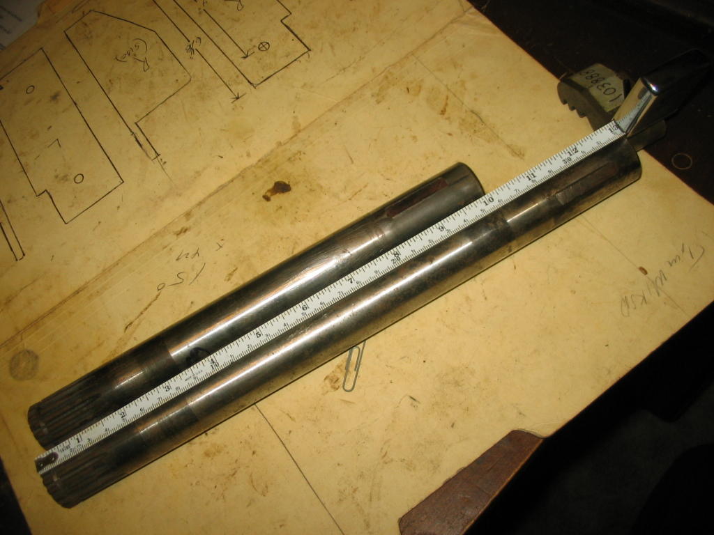

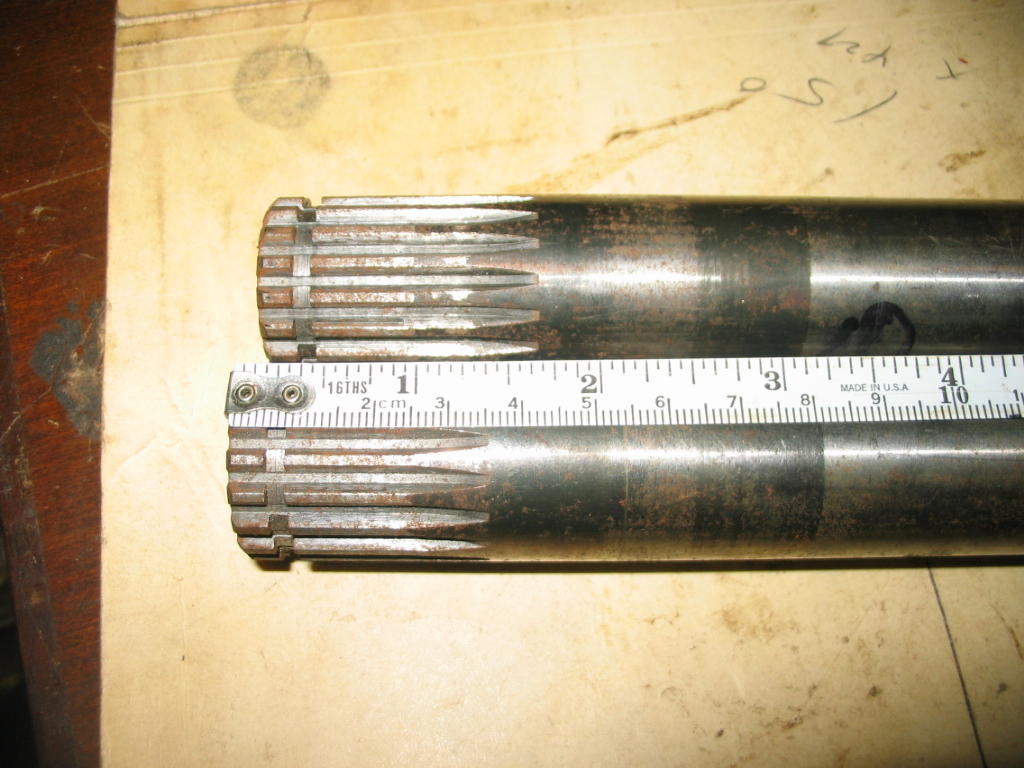

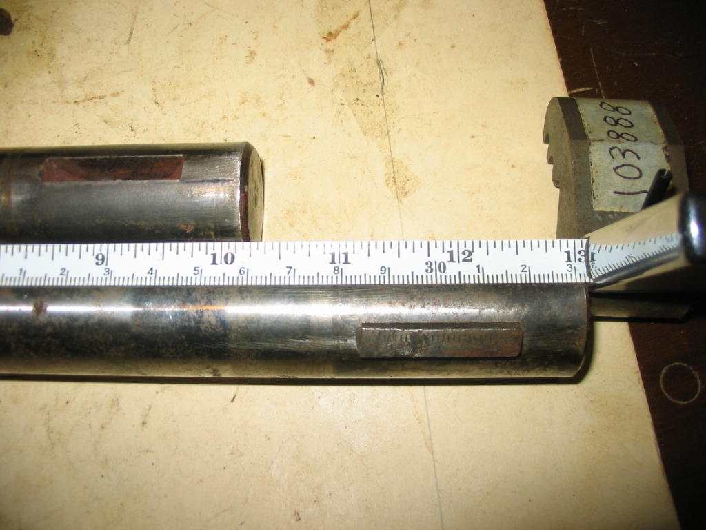

daveoman1966
I ahve a pair....10 and 13" .  Which do you need?
