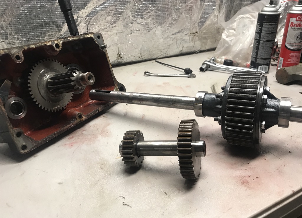

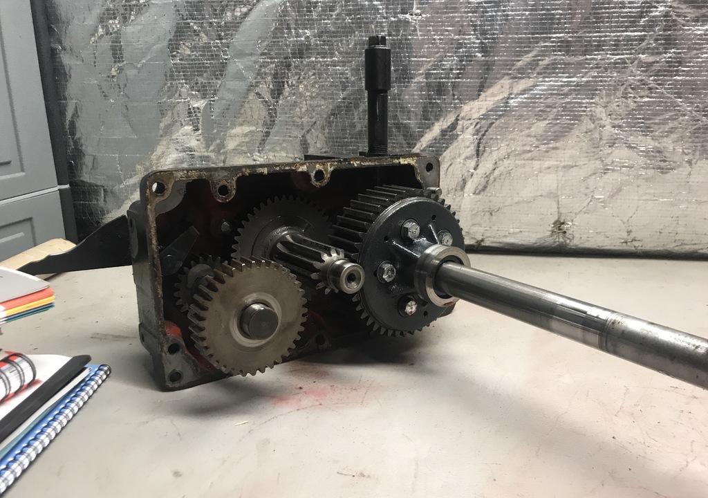

Aldon 4,832 #2 Posted August 3, 2017 The answer is maybe. The shafts insert into capped needle bearings. Except the axles. And depending on how well you clean up the axles you may be able to remove the housing without additional rubber mallet assistance. the good news is that the transaxle is less challenging to put back together than the 8 speed. In my opinion. the smaller shaft and gear set up towards front is actually 5 pieces. 1 shaft, 2 woodruff keys and 2 gears. Easy as long as you don't lose the keys. 4 Share this post Link to post Share on other sites

Aldon 4,832 #7 Posted August 3, 2017 It is doable. A bit tedious but not difficult. @pfrederi can explain it via phone. Although I myself have avoided but now having seen the inside and accessibility I would not hesitate. I imagine you will pull hydro gear. Can't see doing it otherwise. This gives you added benefit of being able to pull and clean the metal screen filter. Inspect for large metal debris. The damage to your pawl may have left you with a schrapnel time bomb that could shred the pump. 3 Share this post Link to post Share on other sites
