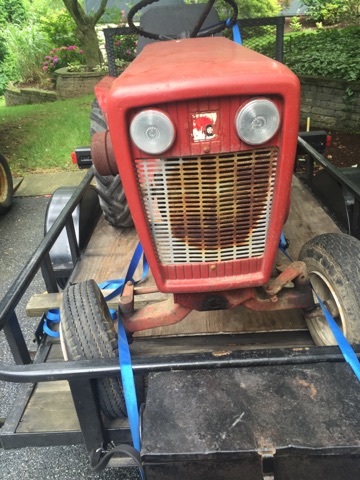

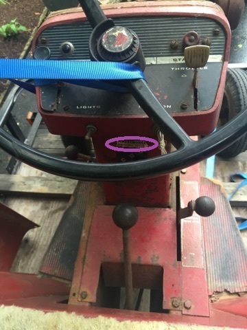

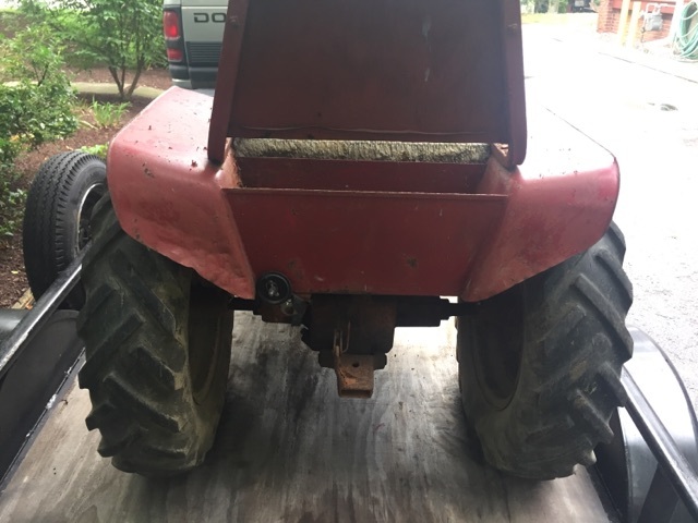

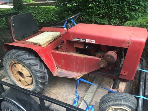

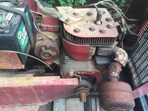

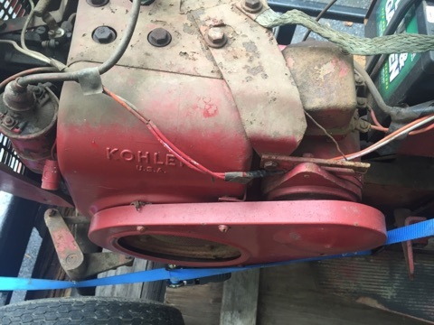

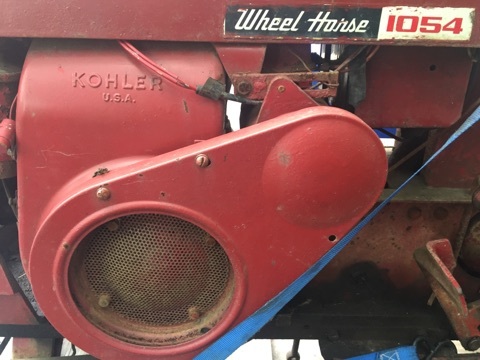

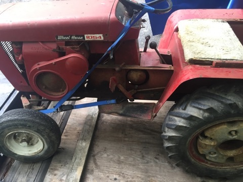

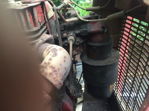

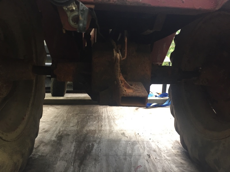

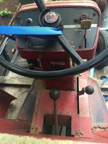

Big_Red_Fred 1,548 #1 Posted July 22, 2017 Well , here you go Fellow Nuts LOL, i drove to above Pittsburg Pa, Thought i was in the Deliverance Movie, dirt road to a line of old homes on the side of a mountain, my Butt was hurting hahahaha, he said a 1 room school owned it, after the school closed the district stored it for 30 years, this Man acquired it, then he needed cash, said theres no work up there, He was eyeing me up like dinner, Hmmm, maybe he didnt eat Big Red Fred cuz the Ruger SR 1911 was bulging off my hip , you know us Old Soldiers go prepared ! Its all there, Flat tire right front, all tires dry rotted, wheel weights, 953 & all you other owners, i need help on this one, Heres sum pics, Wheres the Model number at ? 12 Share this post Link to post Share on other sites
BOB ELLISON 2,983 #2 Posted July 22, 2017 (edited) The serial number is right below the steering wheel in front of shifter. By the way nice 1054. I wish mine was that nice. It's still in pieces waiting for me to get it going. Edited July 22, 2017 by BOB ELLISON 5 Share this post Link to post Share on other sites
Borncountry10 28 #3 Posted July 22, 2017 Very nice tractor! Looks very complete! Serial number like bob said is on your shift pattern decal in front of shifter. 3 Share this post Link to post Share on other sites
953 nut 69,100 #4 Posted July 22, 2017 looks like it is complete with the exception of the cover near the brake peddle, one will turn up. Serial number is right here. 3 Share this post Link to post Share on other sites
Big_Red_Fred 1,548 #5 Posted July 23, 2017 I have the cover for side, he said it was rubbing some thing ? I'm working on C125 first Sunday after i do a starter on a cummings & a/c compressor on a Cat, 1054 wont run unless its fully choked, figuring carb, mabye pump, it will be fully tuned soon, My Son's butt was glued to seat, i could see the Wheel Horse spark in his eyes, Hey Dad, wheres that C165 ? Mine Mine Mine All mine i said, he laughed, I need all the Knowledge i can get from you all, sorry if i pester you, but that 1054 i want it right & shined up like new. 2 Share this post Link to post Share on other sites
jay bee 915 #6 Posted July 23, 2017 1 hour ago, Big_Red_Fred said: 1054 wont run unless its fully choked, figuring carb, More than likely dirty carb or bad float. 1 hour ago, Big_Red_Fred said: sorry if i pester you, I'm sure no one feels pestered. Questions are what this place is all about!!! And answers always seem to come to the surface from some very experienced members. Myself not included in that elite group. 2 Share this post Link to post Share on other sites

Tuneup 1,459 #9 Posted July 23, 2017 MY! you are the definition of a collector. I hear there's one at the bottom level of a coal mine in WVA. Go get it! With your luck, it'll be an intact Suburban. Seriously, those hoods are my favorite and remarkable that you found one in such good shape. Speaking of dangerous pickups, we went to pick-up an old cycle a county away from me - my boy and I ride 70s Japanese fours. You had to pass the poles with the flashing yellow light that said "No police or government authorities past this marker" so I knew they were armed. They respected my 1911 (but mine's a Rock). Liked my teen's Sig even better. Just good 'ole boys that preferred cash and I had it in hand. Makes one feel at home. That carb is a Walbro - they were gummy when I worked on them as teen (had a 6 HP Tecky on my minibike). I can just imagine what they'd look like today! Well, off to church to hold up a few snakes, chant and thank the good Lord. 1 Share this post Link to post Share on other sites
953 nut 69,100 #10 Posted July 23, 2017 9 hours ago, Big_Red_Fred said: 1054 wont run unless its fully choked, figuring carb, mabye pump, Old fuel, point need to be cleaned, carb. gunked up; the list goes on. 9 hours ago, Big_Red_Fred said: 1054 i want it right & shined up like new. The paint looks like it will probably come back to life with a little rubbing/polishing compound. For the old tires, get some rubber lubricant and apply a heavy coating to them, then bag them up in plastic for a few days and the will look a lot better...... Wonder if this stiff would get rid of wrinkles for us old codgers? 1 Share this post Link to post Share on other sites

Big_Red_Fred 1,548 #13 Posted July 23, 2017 I tried to get the tire sizes on 1054, worn off, can someone tell me correct size's please, i hate seeing her lean like that, looks like a Northern Lot Lizard having a bad day, I did'nt say that Share this post Link to post Share on other sites

953 nut 69,100 #15 Posted July 23, 2017 3 hours ago, Big_Red_Fred said: can someone tell me correct size's ple Front tires were 4.00/4.80-8 and the rears are 6.40-15. 3 Share this post Link to post Share on other sites

BOB ELLISON 2,983 #17 Posted July 23, 2017 7 minutes ago, 953 nut said: Front tires were 4.00/4.80-8 and the rears are 6.40-15. The fronts can be had at tractor supply but the brand is hi-run for $20.00. The rears are hard to find unless you go with ags. 1 Share this post Link to post Share on other sites

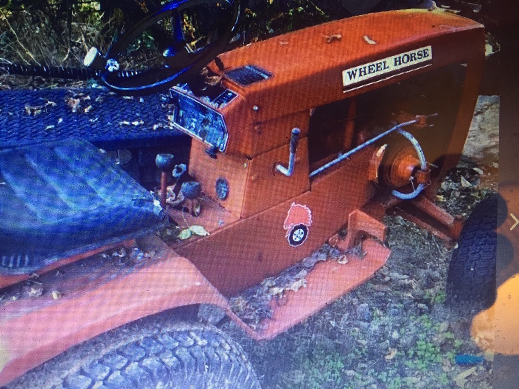

Big_Red_Fred 1,548 #25 Posted July 23, 2017 What is this Red boogie wagon called with its 16hp pipes & smooth body, Dam im getting worked up Hahaha 3 Share this post Link to post Share on other sites
