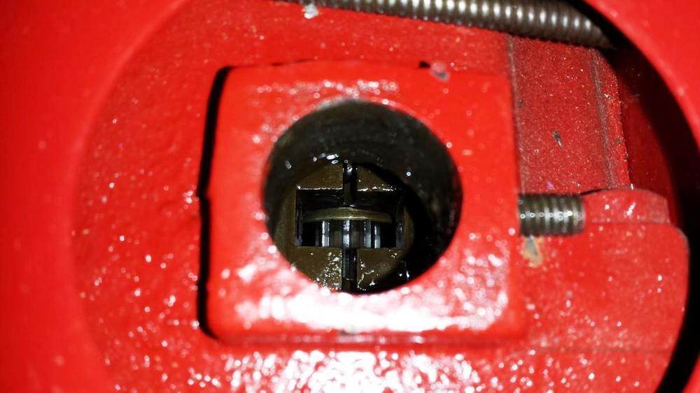

953 nut 64,275 #3 Posted June 29, 2017 The shift lever is held in place by a "Dog point" screw. the shift lever has a round doughnut attached where it goes into the transmission, it has a hole drilled into it. Use a screwdriver to align the two shift forks to neutral, back out the dog point to allow the shifter to be inserted with the dogpoint screw aligned to the hole. Tighten the dogpoint into the hole and check the shifter to see that it will move. When it is adjusted to be snug but easy to shift then tighten the lock nut on the dogpoint. 7 Share this post Link to post Share on other sites

stevasaurus 23,620 #5 Posted June 29, 2017 I'd pull the shifter out, put the horse rearend on blocks and use a large screwdriver to shift those forks to verify nothing works first. The picture above show the trans in the neutral position. 4 Share this post Link to post Share on other sites

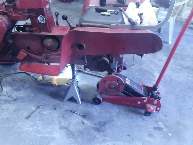

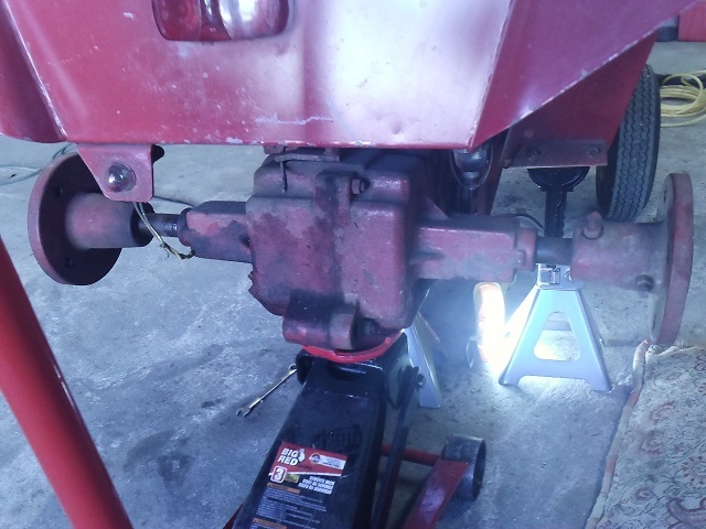

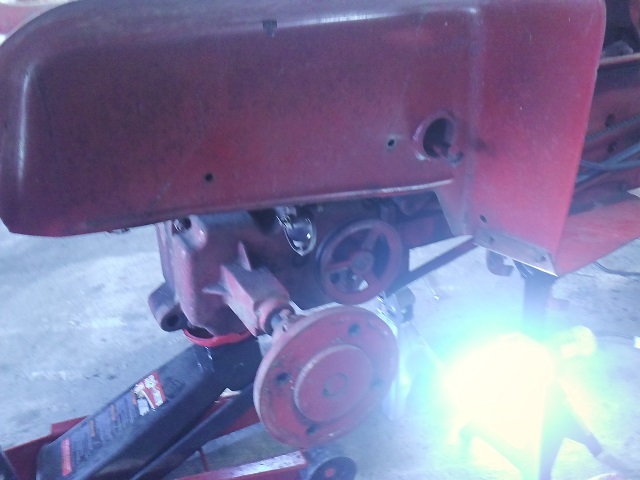

TravelinJavelin 621 #18 Posted July 4, 2017 ok well finally got some time to take it out this morning between the honey do's and work but anyways it has begun so anyways after pulling it out my shifter I noticed that it seemed in neutral position turned the wheels back and fourth and go in reverse direction of each way you spin couldn't feel any binding to speak of but will have to split the case anyways the gasket is junk and is leaking like siev but form what I could see in the hole everything looked clean no shaving the one thing that kinda concerned me was that the shifter looked like some one had broke it off and re welded it but here's some pics to start I apologize for the crap pics 1 Share this post Link to post Share on other sites
stevasaurus 23,620 #19 Posted July 4, 2017 It is hard to tell in those last 2 pictures, but that does not look like neutral. 1 Share this post Link to post Share on other sites
TravelinJavelin 621 #20 Posted July 4, 2017 ok Steve I think I found my problem why everything let go but anyway need you to verify? so anyways I stick my shifter back on and notice the dog set screw is not starting at where I think the shifter should set in to adjust so the threads in the very begining almost start then slides out or looses its bite now i'm wondering if this where I should set the shifter at to tighten up? or the little nub on the screw possible to file down a whisker to get the threads started or tap it out and get a bigger screw? Share this post Link to post Share on other sites

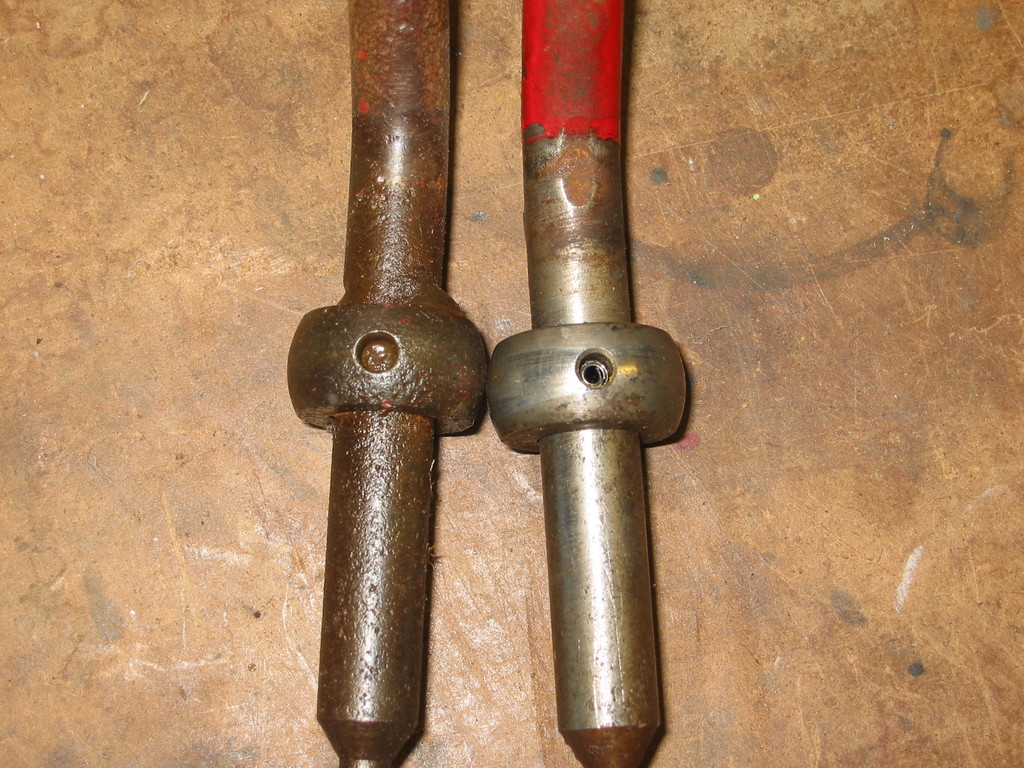

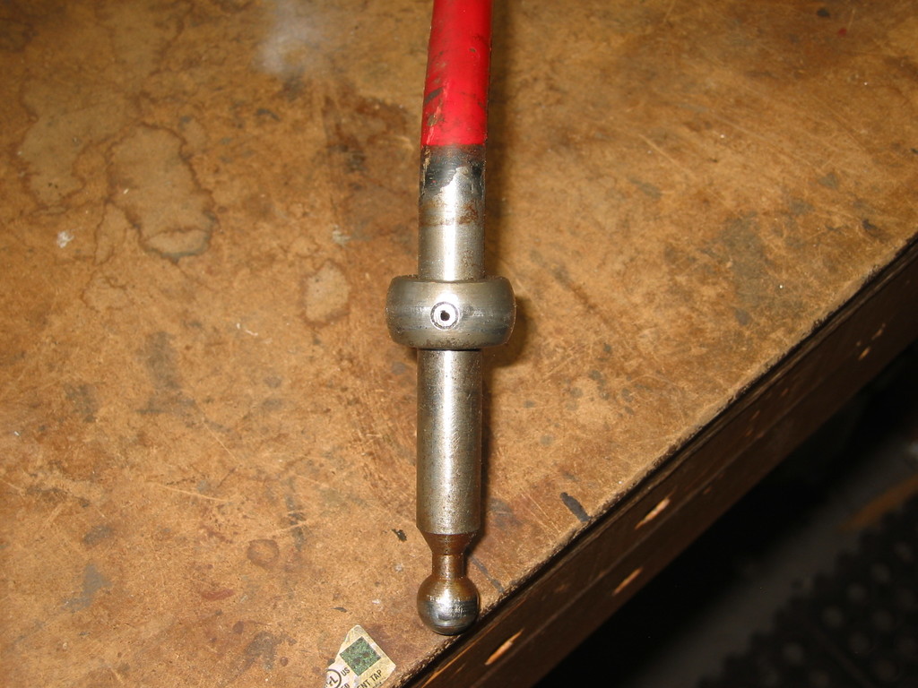

pfrederi 19,941 #21 Posted July 4, 2017 The small hole in the "Donut" of the shifter needs to align with the threaded hole in the tranny case. Yours looks like it is sitting to high. The top of the donut is usually a bit below the top of the tranny case. Run the set screw in as tight as you can by hand (no wrench) if it is seated correctly you will not be able to pull the shifter up nor push it down. Then back it out bit 1/4 to 1/2 turn before you tighten the lock nut 3 Share this post Link to post Share on other sites
TravelinJavelin 621 #22 Posted July 4, 2017 the only thing that I see to line up is where the donut has a like a roll pin and had wondered about it but we'll look a again see what we come up with...thank for your help Share this post Link to post Share on other sites

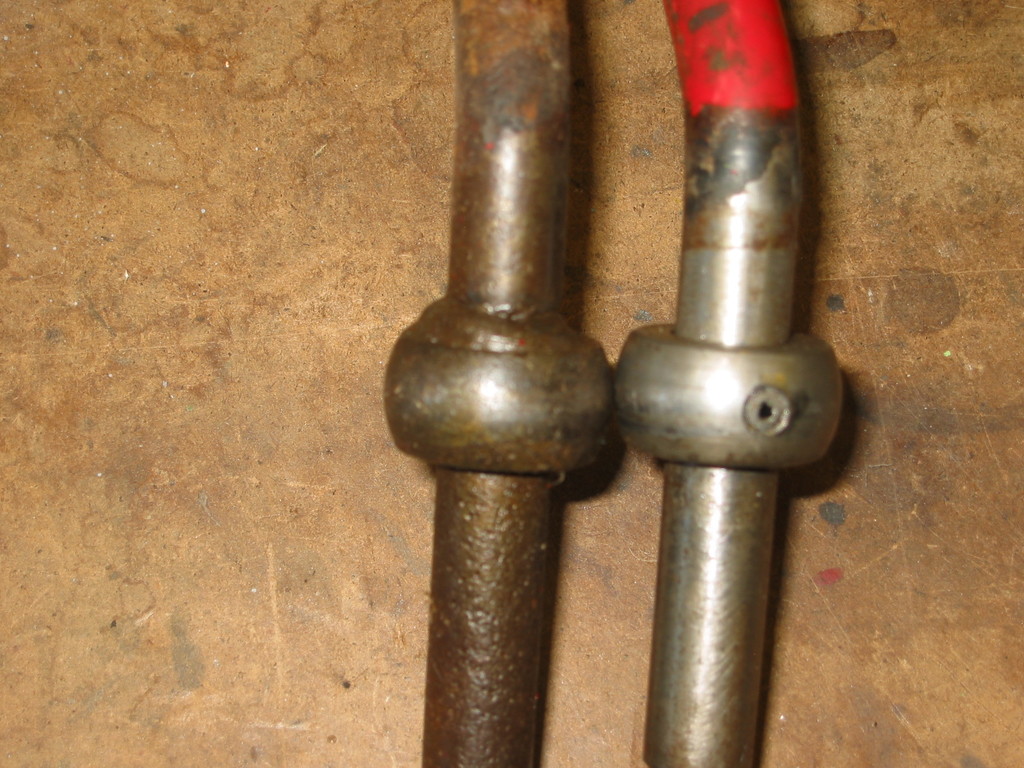

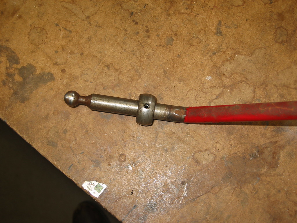

pfrederi 19,941 #23 Posted July 4, 2017 The roll pin should be about flush with the back of the donut but recessed about 1/8th inch from the front side. that is the hole the set screw has to get into. From your picture it looks like your set screw would wind up underneath the donut. On all the stick shifts I looked at the top of the donut is a bit below the top of the case. 3 Share this post Link to post Share on other sites
TravelinJavelin 621 #24 Posted July 4, 2017 well I guess I need to put pic of mine then not even close to being that smooth and the roll pin is slightly longer too Share this post Link to post Share on other sites
pfrederi 19,941 #25 Posted July 4, 2017 Some years WH welded the donut to the shift lever. Your pic isn't clear enough for me to see if that is the case Welded on the left 3 Share this post Link to post Share on other sites
