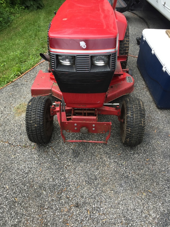

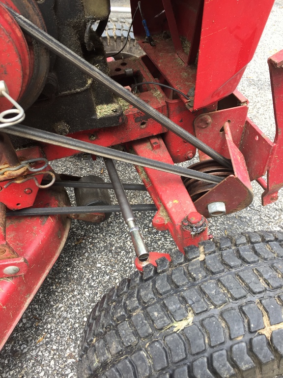

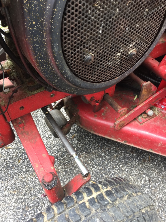

nylyon-(Admin) 8,911 #1 Posted June 15, 2017 I just received my tie-rods from @wheelhorseman and couldn't wait to put them on. First I took the broken one and removed the old non-adjustable tie rod. Using it as a template, I adjusted the new adjustable tie rod and installed, then did the same for the other side. My steering wheel seemed to have been a tooth out, so while I was doing this I moved the steering wheel one tooth which corrected that. Then I did my measuring tape alignment, and gave it a very slight tow in for easier steering. Hopefully it doesn't wander, but if it does, the tie-rods are adjustable I can fix it. These tie-rods are very good quality and really tightened up the steering. I haven't painted them yet, but I suspect that the rod itself should be painted to prevent rust. Thank you to Lowell for making such a good product, and for the added bonus in the box. I gave it a good test fit and it's perfect, thank you so much that's the last missing part and I had a snowball's chance of finding it! If anyone is interested you can visit his new store at https://www.wheelhorsepartsandmore.com and pick up a set of tie rods or other very heavy duty reproduction parts! 19 Share this post Link to post Share on other sites

elcamino/wheelhorse 9,363 #5 Posted June 15, 2017 @nylyon What is that do hickey on the front of the mule drive? Send a picture get a question. 2 Share this post Link to post Share on other sites
nylyon-(Admin) 8,911 #6 Posted June 15, 2017 When I picked up my 414-8 years ago, it came with a "John Deere" dethatcher, that is the mounting bracket screwed onto the mule drive for that dethatcher. 2 Share this post Link to post Share on other sites
