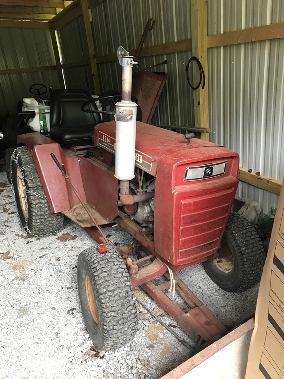

cafoose 3,836 #1 Posted June 1, 2017 I have a Nelson muffler and I was wondering if anyone has ever put one on a GT-14. I was wondering if it was possible and if the gas tank would be in the way? Share this post Link to post Share on other sites
953 nut 69,106 #2 Posted June 2, 2017 You would need to replace the elbow and pipe to get it out away from the tank and hood. I put a stack on mine, no problem. 5 Share this post Link to post Share on other sites
cafoose 3,836 #4 Posted June 2, 2017 3 hours ago, 953 nut said: You would need to replace the elbow and pipe to get it out away from the tank and hood I'm kind of thinking maybe a stack currently all I have is a short pipe coming from the block. 1 Share this post Link to post Share on other sites

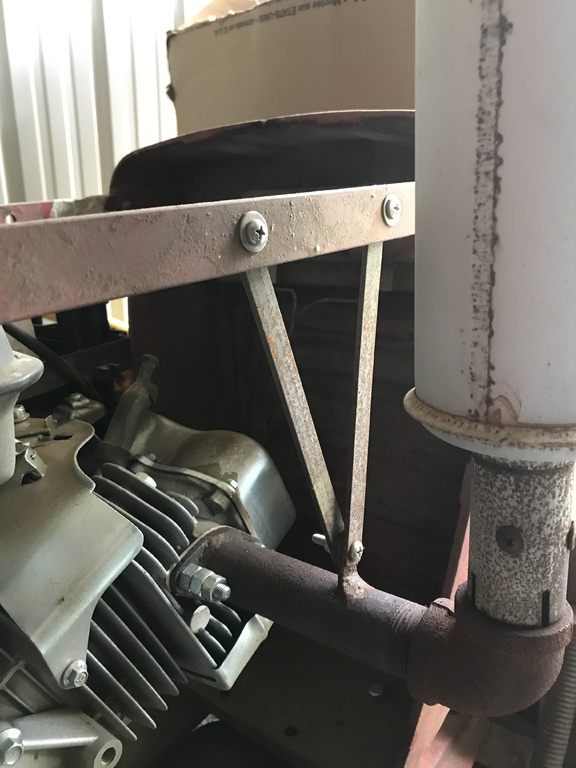

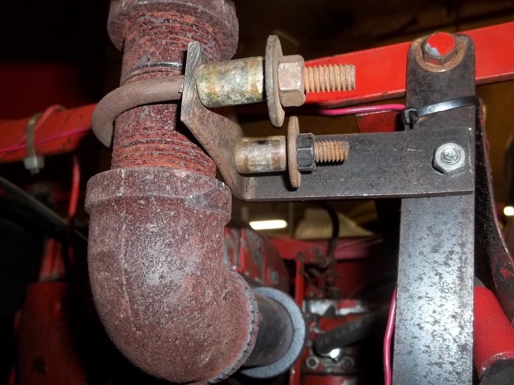

dells68 7,499 #5 Posted June 2, 2017 man, my ears are already hurting just looking at that picture!! I say put a stack on the ole gal - just be sure to support it somehow to prevent the weight from cracking your block. I just welded a tab on the pipe I used to extend it past the hood and ran a support up to the bar that connects the dash to the grill. Been about a year and a half and has worked great. Share this post Link to post Share on other sites

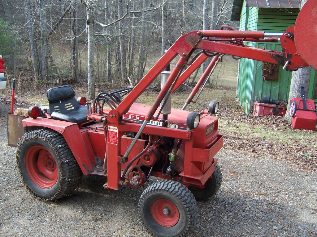

dells68 7,499 #9 Posted June 7, 2017 Slow but sure! Here are some pictures of how I supported the muffler on my worker GT14. I repowered it with a predator, but the same idea would work with a kohler. Hope this idea helps! 3 Share this post Link to post Share on other sites
cafoose 3,836 #10 Posted June 8, 2017 On 6/6/2017 at 10:03 PM, dells68 said: Slow but sure! Here are some pictures of how I supported the muffler on my worker GT14. I repowered it with a predator, but the same idea would work with a kohler. Hope this idea helps! Looks good I never thought of doing it that way. My exhaust should be in today's mail but the mail arrived after I left for work 2 Share this post Link to post Share on other sites

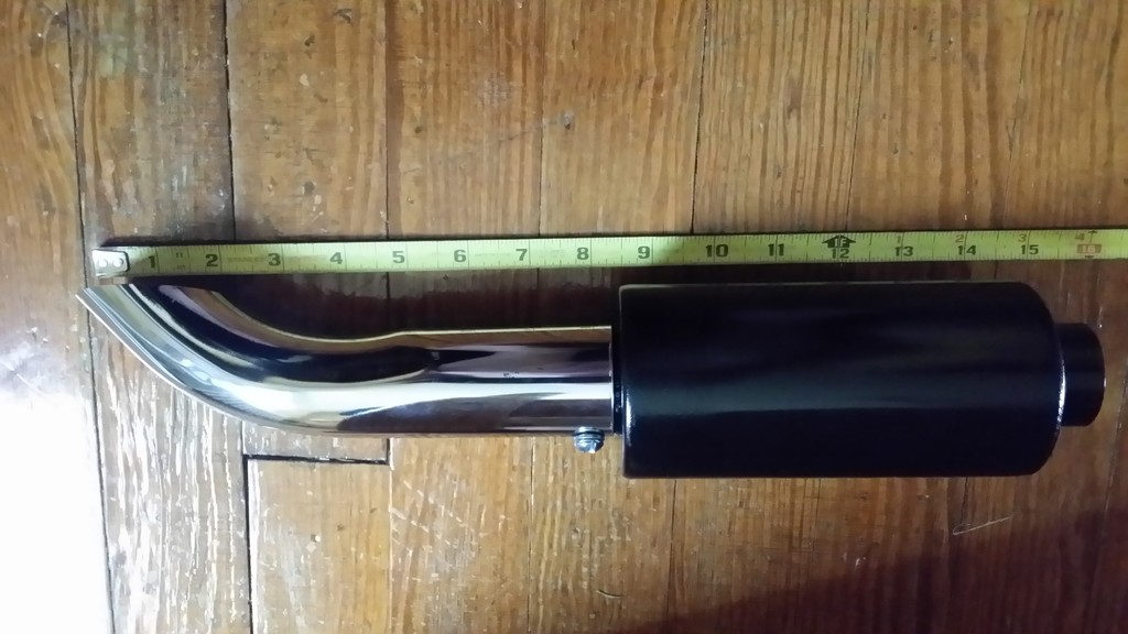

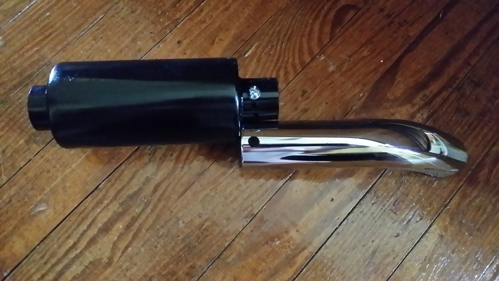

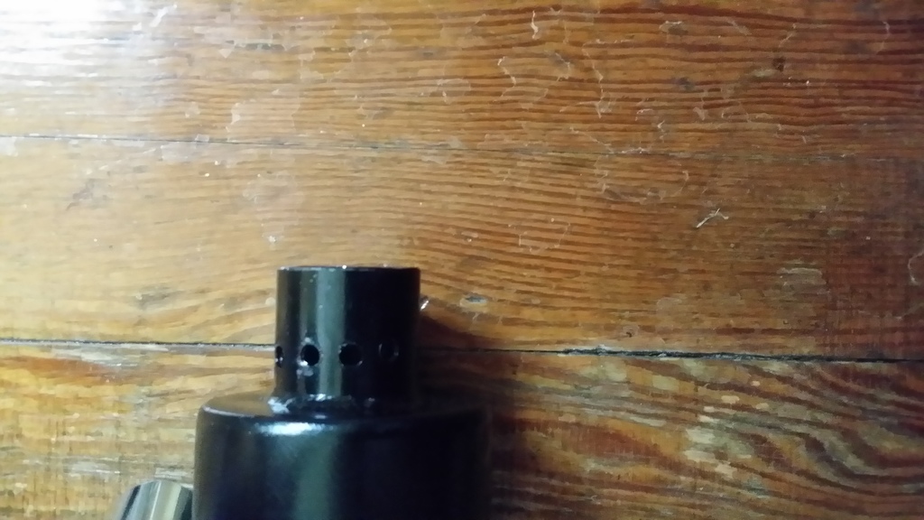

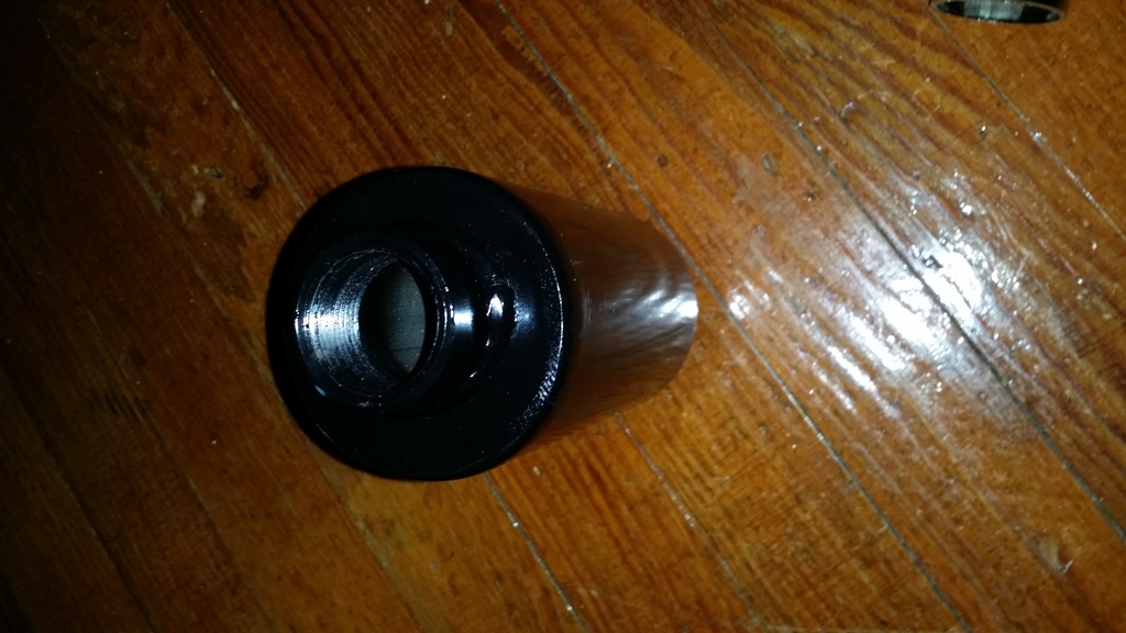

cafoose 3,836 #11 Posted June 8, 2017 I just looked at the muffler I got from @jimkemp and I think it will work great. Jim for the excellent product. I really like how the holes are drilled all around the end where the chrome piece goes to allow for adjustment 5 Share this post Link to post Share on other sites

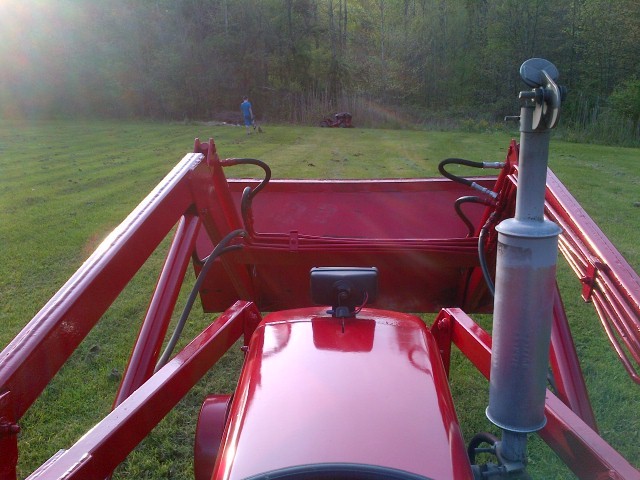

953 nut 69,106 #12 Posted June 8, 2017 Much nicer looking than mine! Here is a snapshot of the brace on my stack. A bar runs from the frame up to the cross-member going to the grill, The electric fuel pump is on it and a brace for the stack. 2 Share this post Link to post Share on other sites
