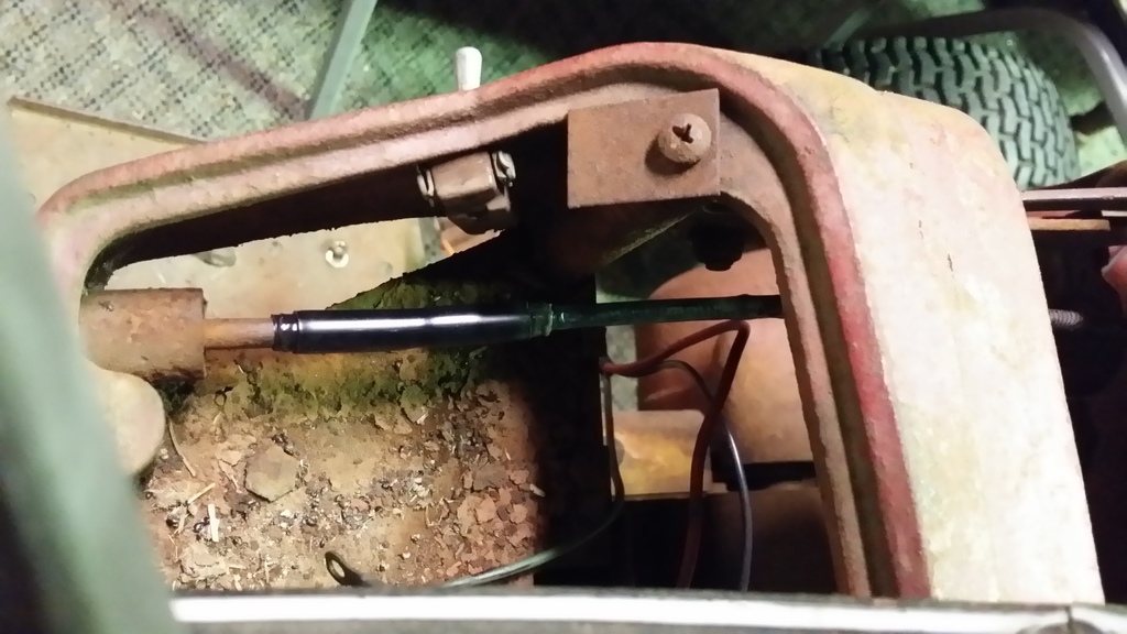

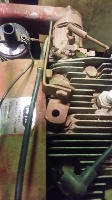

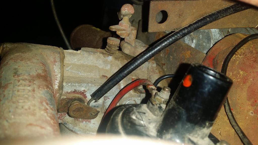

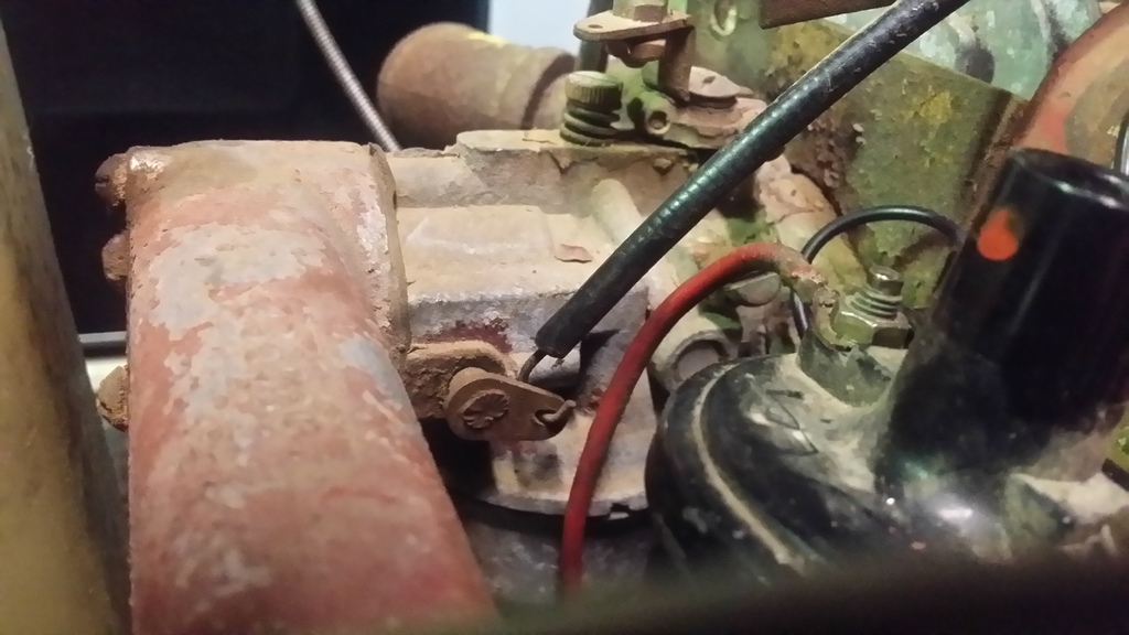

cafoose 3,600 #1 Posted June 1, 2017 Could someone please post some of how the choke cable is routed and hooks up on my GT-14? Here are some pictures of what it looks like now: 2 Share this post Link to post Share on other sites

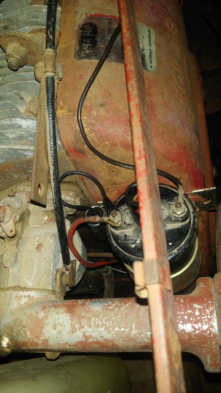

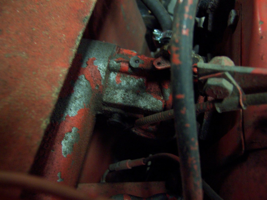

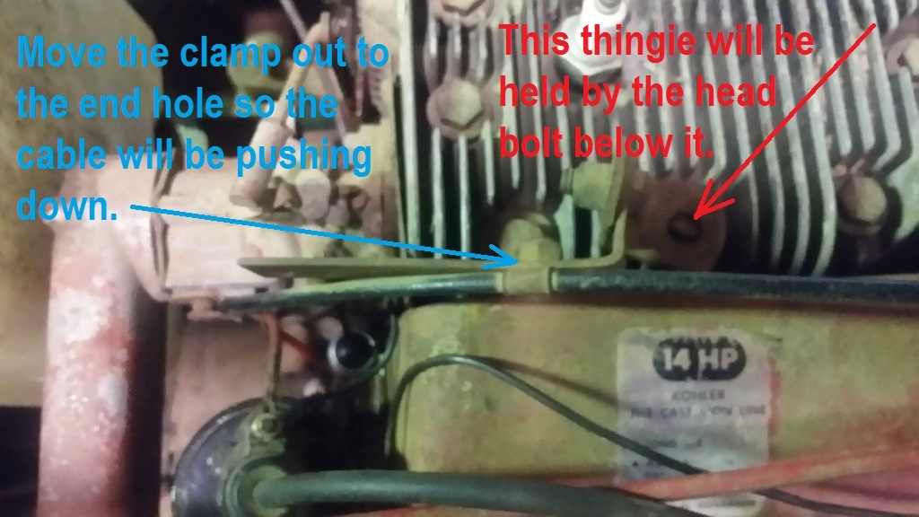

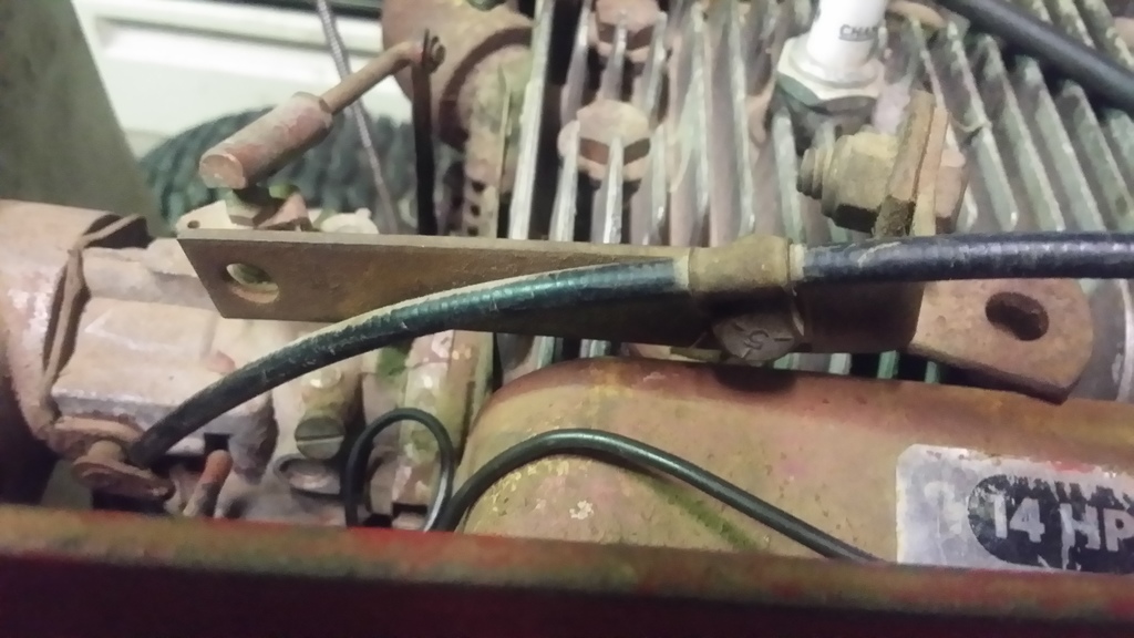

953 nut 64,160 #2 Posted June 1, 2017 (edited) You showed us yours, now I'll show you mine! looks about the same except mine is at the end of the bracket. Edited June 1, 2017 by 953 nut 1 Share this post Link to post Share on other sites

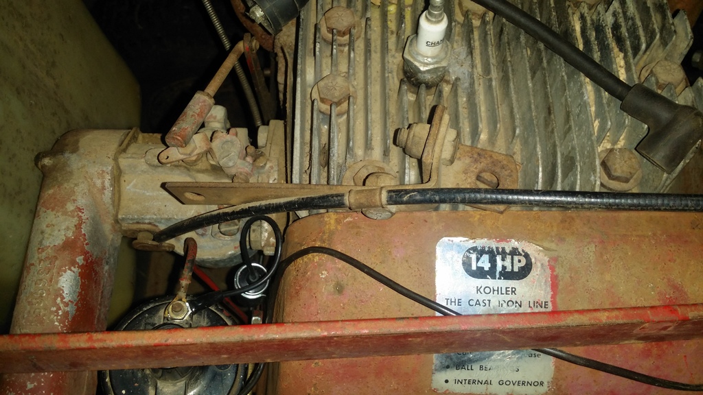

cafoose 3,600 #3 Posted June 1, 2017 38 minutes ago, 953 nut said: You showed us yours, now I'll show you mine! looks about the same except mine is at the end of the bracket. now I see that I have the correct cable and brackets but my bracket was not bolted down anywhere. How do I bolt it down and which bolts on the engine do I use? I never saw it bolted down. The PO unbolted the bracket. 1 Share this post Link to post Share on other sites

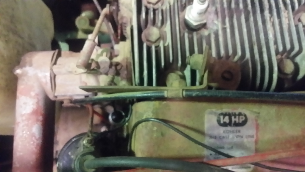

953 nut 64,160 #4 Posted June 1, 2017 2 hours ago, cafoose said: How do I bolt it down and which bolts on the engine do I use? 1 Share this post Link to post Share on other sites
cafoose 3,600 #5 Posted June 1, 2017 48 minutes ago, 953 nut said: Richard I really appreciate it. I will hook it up tomorrow. 1 Share this post Link to post Share on other sites

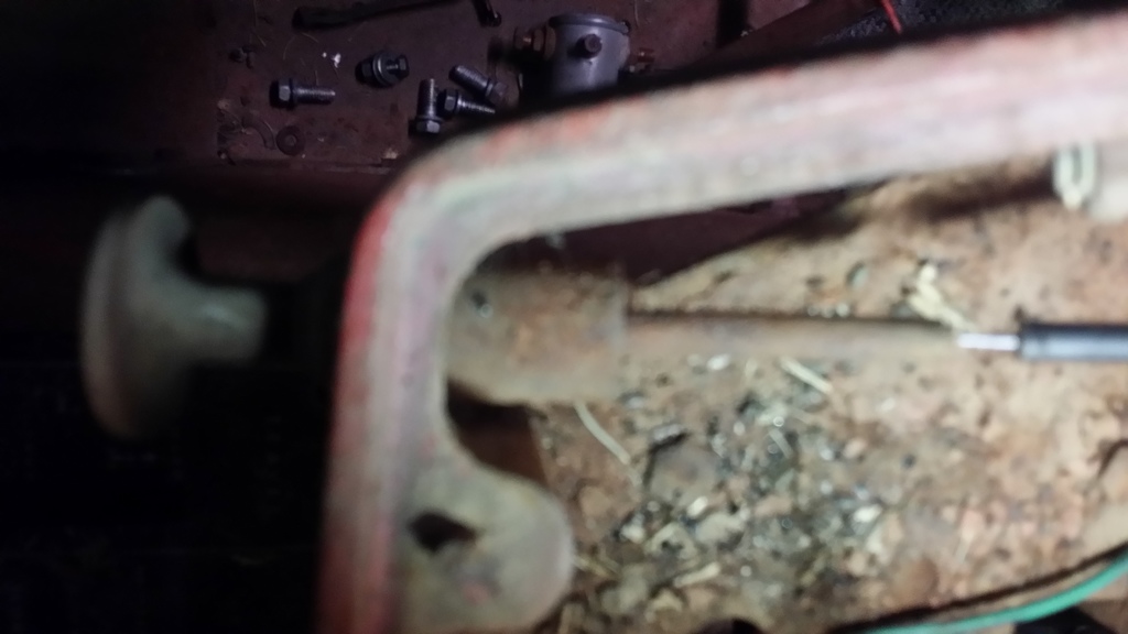

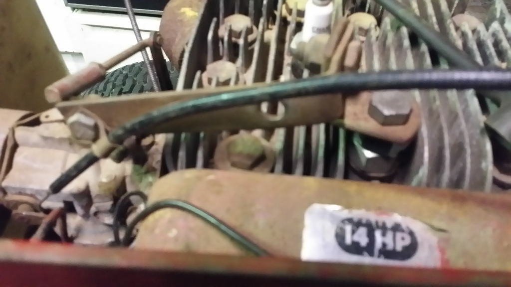

cafoose 3,600 #6 Posted June 2, 2017 This is how I hooked it up now but the cable housing separated at the other end. Is there a way to refasten it or do I need a new cable? 1 Share this post Link to post Share on other sites

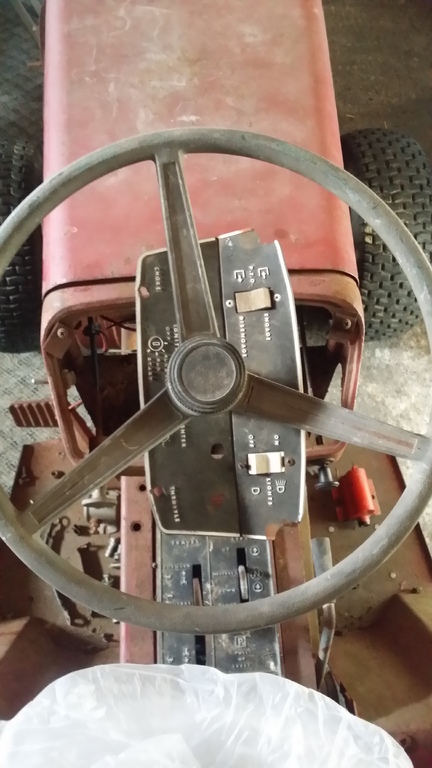

953 nut 64,160 #7 Posted June 2, 2017 (edited) First question, how the heck did you manage to get the picture of the under side of the dash? If I attempted that I would have to call 911 to get back out! I have never attempted to attach the jacket back into the thingy on the dash, hope someone can tell us how it is done. Edited June 2, 2017 by 953 nut 1 Share this post Link to post Share on other sites
dells68 7,499 #8 Posted June 2, 2017 The outer sleeve on mine broke about half way down. I found a piece of heat shrink tubing to fit and snugged her up. Still works great. Maybe do the same on yours and slide a length of small rubber fuel line up over it for extra support - should be fine. 2 Share this post Link to post Share on other sites
cafoose 3,600 #9 Posted June 2, 2017 6 hours ago, 953 nut said: First question, how the heck did you manage to get the picture of the under side of the dash? If I attempted that I would have to call 911 to get back out! I removed the screws from the dash and slid it up the steering shaft and turned it 90 degrees. 6 hours ago, dells68 said: The outer sleeve on mine broke about half way down. I found a piece of heat shrink tubing to fit and snugged her up. Still works great. Maybe do the same on yours and slide a length of small rubber fuel line up over it for extra support - should be fine. I'm gonna have to try that sure beats installing a new cable 2 Share this post Link to post Share on other sites
dells68 7,499 #10 Posted June 2, 2017 50 minutes ago, cafoose said: I removed the screws from the dash and slid it up the steering shaft and turned it 90 degrees. I'm gonna have to try that sure beats installing a new cable Yup, beats the cost of a new cable too. My wallet likes those home fixes. If you're careful, no one will ever know you fixed the cable - looks fine. 3 Share this post Link to post Share on other sites
19richie66 17,810 #11 Posted June 2, 2017 Get good heat shrink with glue in it. Buy some of those blue butt connectors with the heat shrink coating. Push out the connector part, that stuff works reall good. Super stiff when cooled off. 1 Share this post Link to post Share on other sites
cafoose 3,600 #12 Posted June 2, 2017 8 hours ago, dells68 said: The outer sleeve on mine broke about half way down. I found a piece of heat shrink tubing to fit and snugged her up. Still works great. Maybe do the same on yours and slide a length of small rubber fuel line up over it for extra support - should be fine. I found this on amazon: https://www.amazon.com/Ginsco-152Pcs-Shrink-Tubing-Adhesive/dp/B01N07O1GO/ref=sr_1_1?s=sporting-goods&ie=UTF8&qid=1496429811&sr=1-1-spons&keywords=Adhesive+Lined+Shrink+Tubing&psc=1 1 Share this post Link to post Share on other sites
19richie66 17,810 #13 Posted June 2, 2017 That should work good. 1 Share this post Link to post Share on other sites
cafoose 3,600 #14 Posted June 6, 2017 My heat shrink came today and I put one piece on a little larger than the cable, hit it with a heat gun, and then put a slightly larger piece over it for more strength and hit that with the heat gun. Then I hooked up the clamp and choke lever and it works great! @dells68 and @19richie66 I used adhesive based shrink tubing and I'm very pleased with the results and @953 nut for the 2 Share this post Link to post Share on other sites
