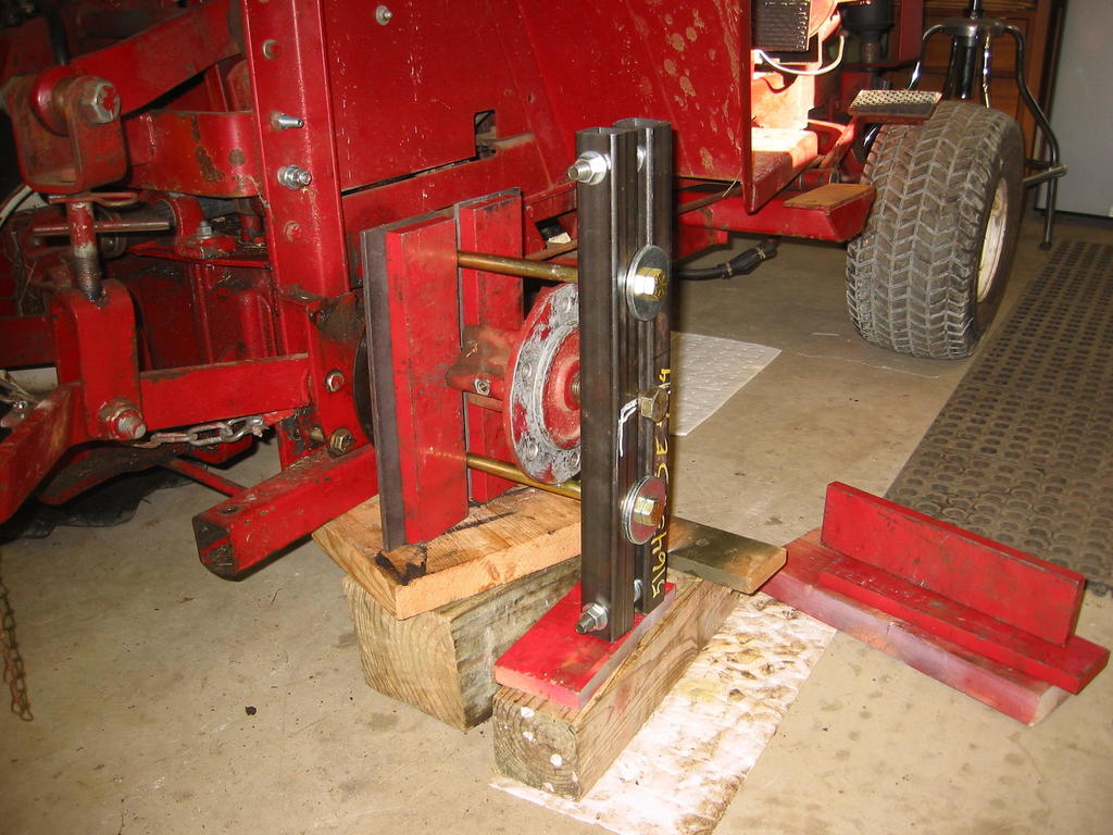

rmaynard 17,644 #2 Posted May 28, 2017 Get an old hub and some nuts and bolts and make your own. Here is the one I made: 6 Share this post Link to post Share on other sites

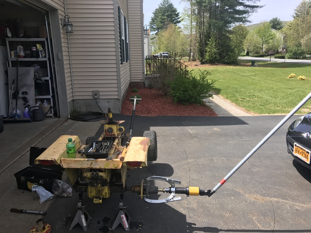

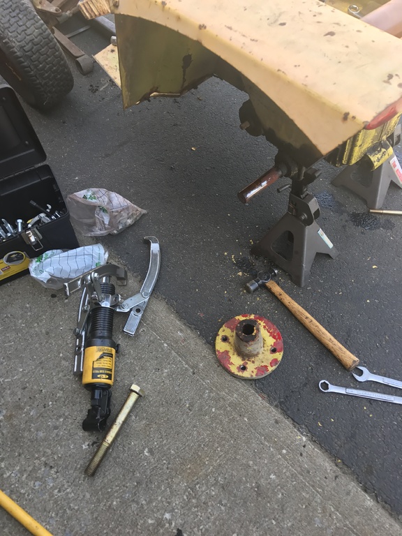

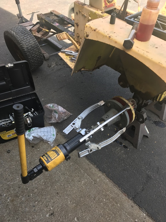

Aldon 4,834 #4 Posted May 28, 2017 And for the really belligerent hub, I add a helper bar. 6 Share this post Link to post Share on other sites

Aldon 4,834 #7 Posted May 28, 2017 The 3 jaw puller is a 10 ton set up from amazon. ~ $100 2 Share this post Link to post Share on other sites

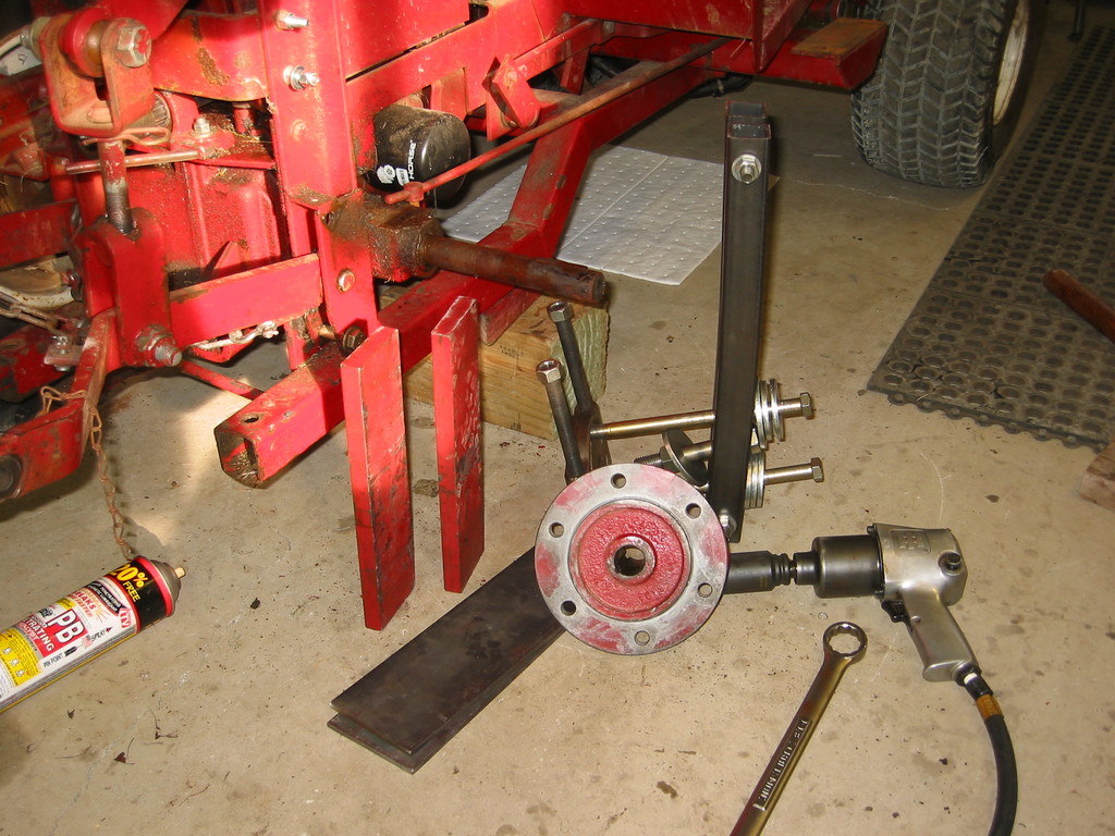

pfrederi 21,306 #10 Posted May 29, 2017 4 hours ago, pacer said: After my SECOND hub breaking with a giant 3 jaw -- I figured that more than 3 points of pull was needed so I built a 5 and a 6 pull point. I havent broke another hub and have successfully pulled several ... but I had a big D-180 make me holler UNCLE! on both hubs no matter how I went at them --- manohman, hubs and steering wheels! whew!! The problem with pulling D series hubs (and GT14s) is the body of the hub is long and the flange is not much thicker than a regular hub. if they are really stuck you have to pull them from the back of the hub not on the flange or you may break the flange. this setup worked on my D and she fought all the way off. It bent the heavy wall square tubing I used a part of the puller but the hubs came off in one piece... finally. 6 Share this post Link to post Share on other sites
