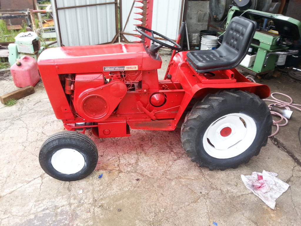

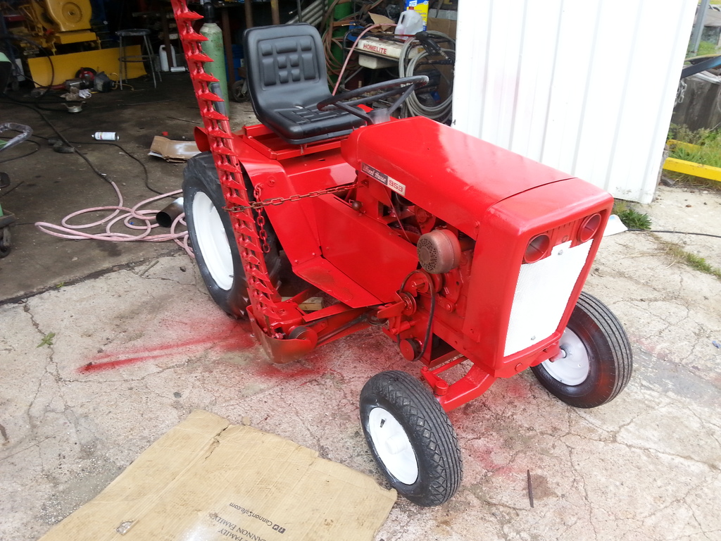

Vernon 3 #1 Posted May 22, 2017 (edited) Hello I'm new here and need help. A friend brought me a 953 that he picked up to fix up for him and I got it running great, Even painted it for him. It has a cycle mower on it. Did a bunch of work on it . I was trying it out and it got stuck in gear and wouldn't come out so pull transmission out and pulled gear stick out and took a screw driver and got it out of gear. thought everything was ok until my wife says is this a crack in the rear of the rear end and sure enough it was.After all this work. Is there anything I can replace this transmission with ? I think this transmission is a 5047. Any help would be appreciated. Edited May 23, 2017 by Vernon 2 Share this post Link to post Share on other sites

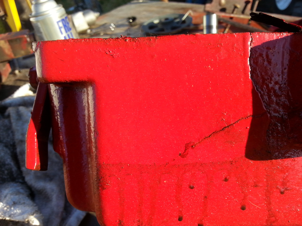

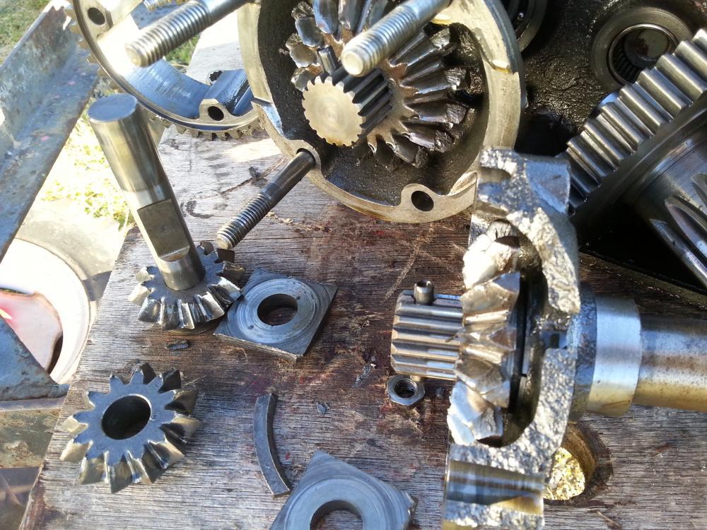

Vernon 3 #12 Posted May 23, 2017 Here are the pics. Where can I find a transmission or parts Share this post Link to post Share on other sites
953 nut 64,271 #13 Posted May 23, 2017 (edited) 6 hours ago, Vernon said: Here are the pics. Where can I find a transmission or parts Pictures didn't attach. I see that the photos are attached to post #1. Edited May 23, 2017 by 953 nut Share this post Link to post Share on other sites

953 nut 64,271 #15 Posted May 23, 2017 looks like we know what caused the crack in the case. Steve listed a lot of potential donors for a transaxle in post #3. As said before, you will need to use your axles and probably the shift lever too. At first I had hoped a little JB Weld on the crack would do the trick, but this is a bit beyond that. Hang on to the good parts, they may be able to save another horse down the line. 2 Share this post Link to post Share on other sites
