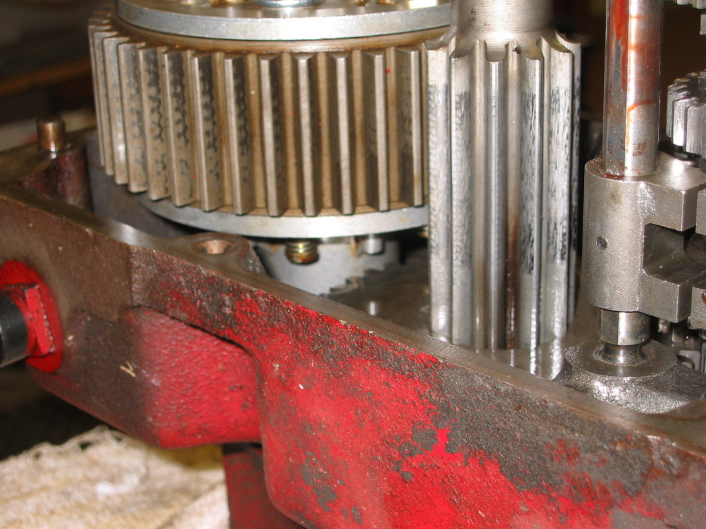

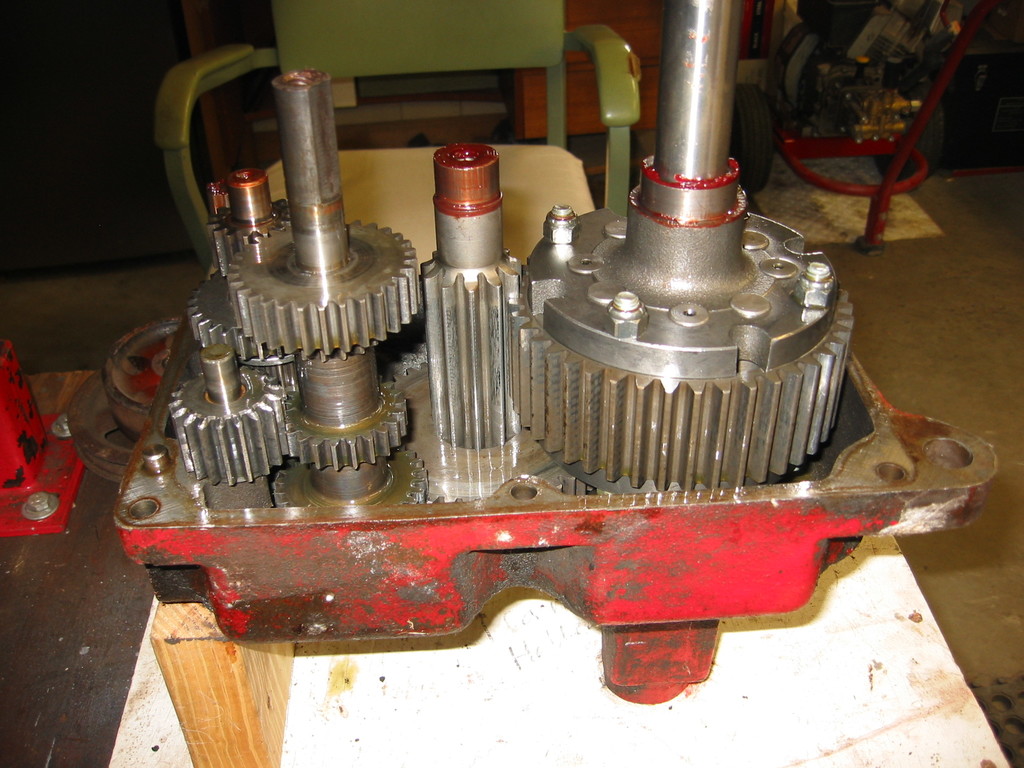

pfrederi 21,274 #8 Posted May 2, 2017 If you have a 1 piece pinion gear (as i think you do) you will not be able to do the direct differential swap. The first pic shows the 8 pinion differential note how close it rides to the pinion gear. The second picture is a 10 pinion diff see it rides way out near the end of the pinion gear shaft. problem is your pinion gear is not machines all the way down. i think the 8 diff pinion would run up against end of your machined splines on the pinion gear. 1 Share this post Link to post Share on other sites

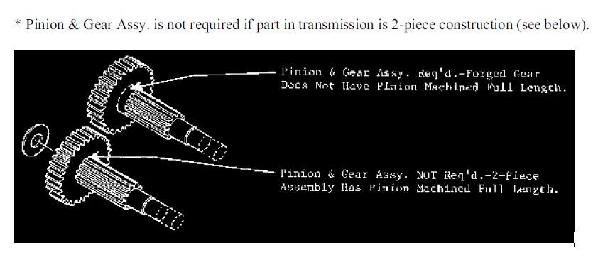

stevasaurus 23,861 #9 Posted May 2, 2017 Right Paul...there is a Service Bulletin in the "Manual" section that discusses this and what to do. It looks like you do have the 2 piece mushroom gear in your 312-8 transmission. Share this post Link to post Share on other sites
