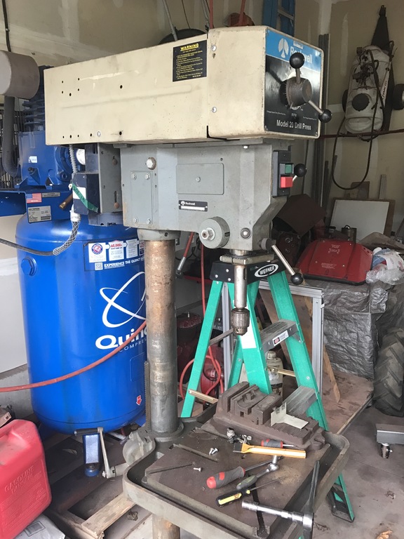

Sarge 3,473 #19 Posted May 25, 2017 For reaming out axles , I use bridge or construction reamers with spiral flutes - they work well but it takes a pretty heavy drill press to handle them . That was the main reason I bought the old Atlas/ Clausing 18" production unit - it's nearly 5 times the weight of the 17" Crapsman I have here that will probably just get scrapped . 3/4" axle pins/spindles are pretty weak on anything bigger than a long frame 12hp tractor - adding a loader or any serious front weight will kill those small spindles/center pins in a hurry , just fyi . I do tend to overbuild things a bit , lol....but they last and my theory is to address it once , and be done with it . Sarge 2 Share this post Link to post Share on other sites
Aldon 4,834 #20 Posted May 25, 2017 Have not sources the bits or tooling yet. i do have this 20 inch drill press which I recently repaired and have operational. 3 Share this post Link to post Share on other sites
