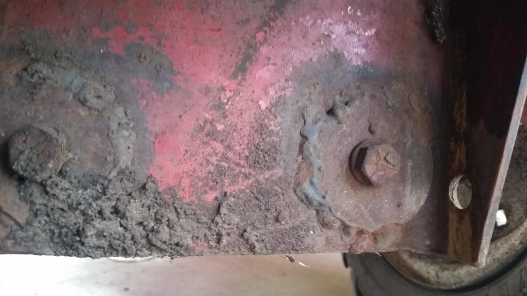

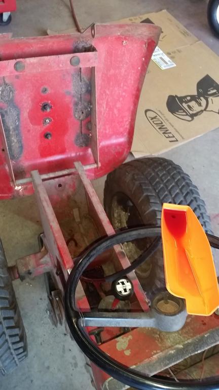

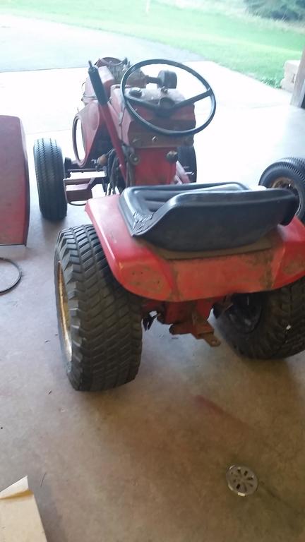

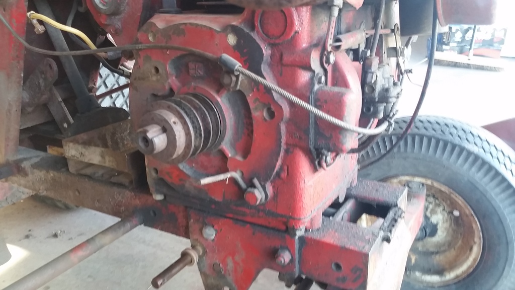

WHX?? 57,903 #1 Posted April 18, 2017 (edited) Had a little time to look over this new to me 1055 last nite and wasn't too surprised as to what I found. After some choice french and a can of PB Blaster did manage to get the belt guard off and deck pedal off. Only twisted off one hooby doo and one broken guard tab so that was a nice surprise as I had expected many more. Transmission is locked up solid so drained the tranny to find nothing but a few drops of brown water goo come out. Turns out it is not stuck in two gears as thought but a careful feel of the shift lever revealed it is indeed in neutral. The shift rails are rusted solid and so is the rest of it. I did manage to free up the input pulley with a chain wrench but it feels rather gritty. My intent is to just get it rolling to move around easier. I am force feeding it a diet of ATF & diesel through the bolt hole in the tunnel just to kinda help preserve it further till I get the time to really tie into it. I would love to dump that love juice mixture down the shifter hole to cover the shift rails & forks but the dog point is snapped off flush so that operation will have to wait till it's on the bench. It was rather messy but I did manage to get some to seep down past the shifter ball. Other noteworthy finds: The SG will spin the motor which is free and a good sign. The rear tires will hold air.... for about five minutes The gas tank and fuel system are fairly clean. The frame has and other items have suffered some stick welding with what appears to be 240 VAC and a coat hanger. Fortunately nothing that can't be ground off and repaired properly. Note the round welded on washers under the lower frame to transmission bolts Paint @Shynon, appears to be original in most areas except I suspect the fender pan has been messed with. See the pics ... a strange yellow undertone, maybe the fenders were yellow at one time? Reminds me of the yellow painted ones guys had pics of that were for park service??? Edited April 18, 2017 by WHX11 10 Share this post Link to post Share on other sites

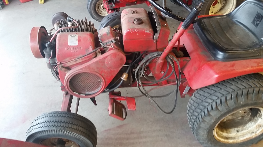

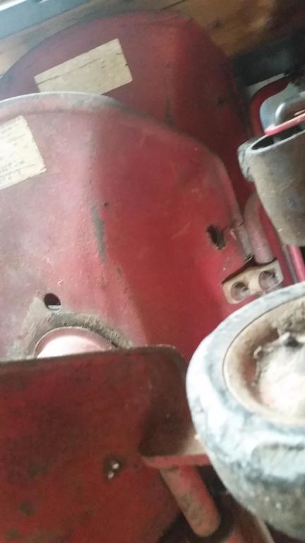

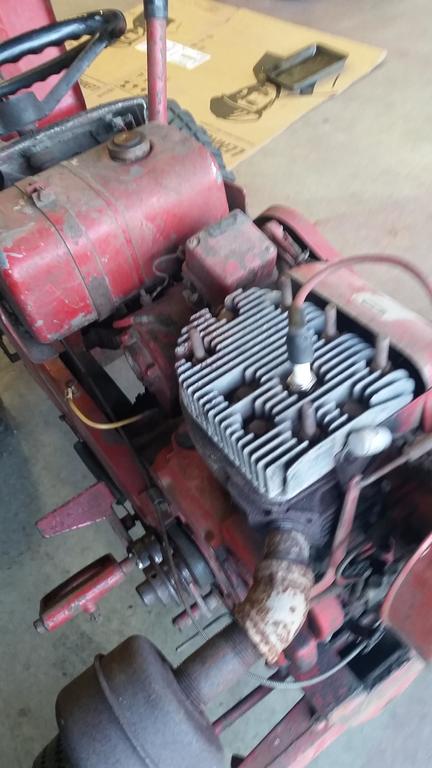

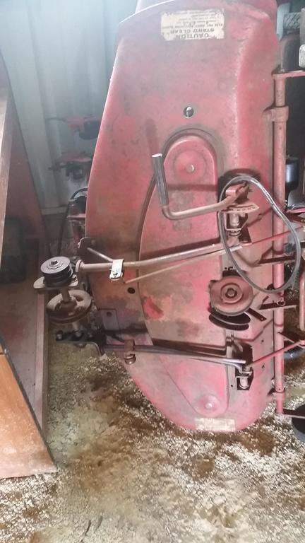

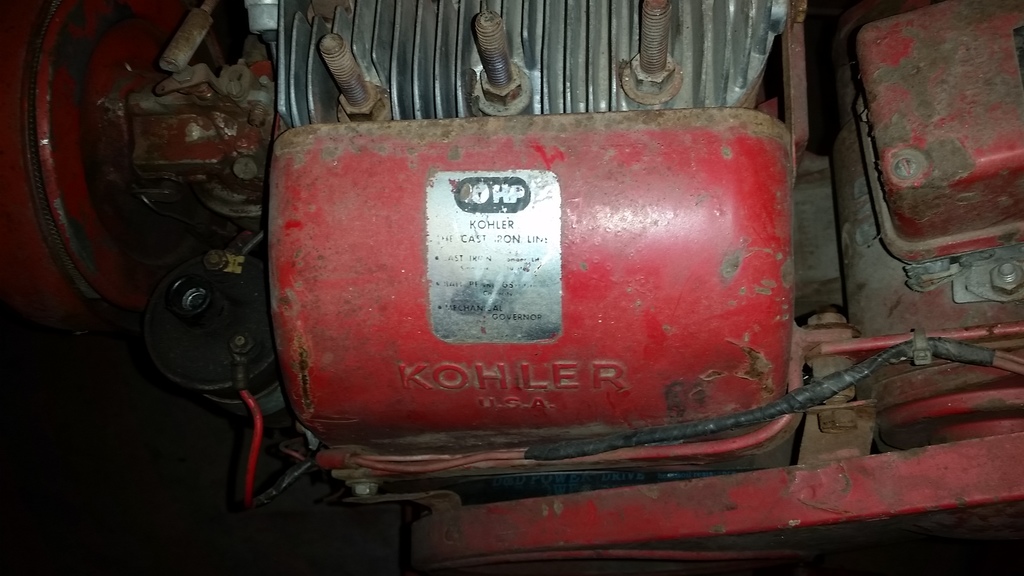

WHX?? 57,903 #2 Posted April 18, 2017 What's with the funky head bolts & missing tin's you suppose? deck that came with it, anyone have an Idea on the model ...no tags but 42" SD Holes in the common spots but other wise solid & spins. 7 Share this post Link to post Share on other sites
Deadguy 864 #3 Posted April 18, 2017 That is a RM425 deck. I have an extra if you are interested in picking it up! 2 Share this post Link to post Share on other sites
Achto 32,463 #4 Posted April 18, 2017 1 hour ago, WHX11 said: I am force feeding it a diet of ATF & diesel through the bolt hole in the tunnel just to kinda help preserve it further till I get the time to really tie into it. I would love to dump that love juice mixture down the shifter hole to cover the shift rails & forks but the dog point is snapped off flush so that operation will have to wait till it's on the bench. I filled my suburban to the top with ATF & left it soak for a few weeks before I tore into it. You could also jack the back end up when you leave it sit so that the ATF is forced to sit by the shifter. Other wise it looks savable if you choose. Nothing that some $ & elbow grease can't fix. 4 Share this post Link to post Share on other sites

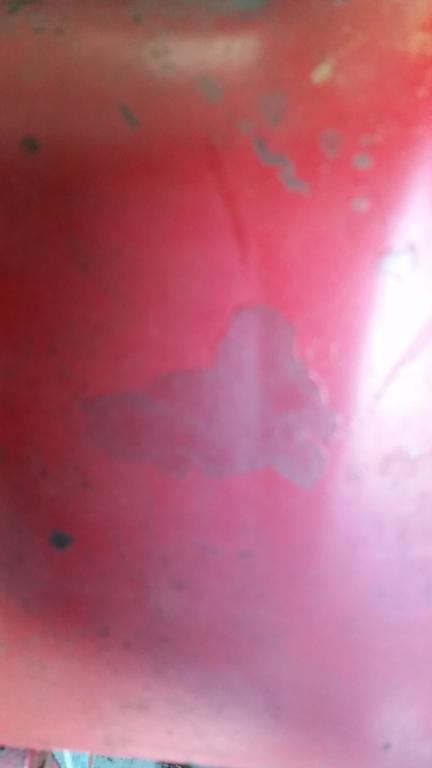

WHX?? 57,903 #7 Posted April 18, 2017 Maybe some kind of primer?? 3 hours ago, Achto said: You could also jack the back end up Hind sight being 20/20 I should have jacked the front up to see what kind of goo was over the hump too. I do have about 2 quarts in it now. 3 Share this post Link to post Share on other sites

Shynon 7,656 #13 Posted April 19, 2017 (edited) 10 hours ago, WHX11 said: What's with the funky head bolts & missing tin's you suppose Jim you should have all head bolts no studs, with a large boss head on it Besides you need another project while waiting for the parts for a project Edited April 19, 2017 by Shynon 4 Share this post Link to post Share on other sites
Dennys502 246 #14 Posted April 19, 2017 Looks like ARP studs - must have been running high compression for pulling! 2 Share this post Link to post Share on other sites
WHX?? 57,903 #15 Posted April 19, 2017 Excuse my ignorance @Dennys502 but what are ARP studs? You might be on to something, maybe a PO removed the tins for short hot runs!?!? I have no idea why he would have took that S/G bracket off and put this on. Explains why the S/G is sitting all kittywaumpus! @HorseFixer I would have to agree with you 100% on your post. Little more update.... the tranny fluid runs out of the axle seals like water. Did get the differential to finally spin tho and fairly smooth so that's a good sign. Not going to force the shifter to avoid fork damage. Will deal with that when it's gets scheduled for surgery. Going to get the fluid back out and shove it in the corner for now. Have to get the 1067 project ready for show season and the 1257 ready for plowing events also get the 400 running decent. You will be happy to know @stevasaurus Lowell has got me a kit coming for it in case of a rainy day. This should be a 5049 right? 12 hours ago, Shynon said: Besides you need another project while waiting for the parts for a project I got that covered Tom! 1 Share this post Link to post Share on other sites
Dennys502 246 #16 Posted April 19, 2017 ARP studs are used for racing for quick head removal and consistent torque of the bolt. They last longer when being retorqued all the time. They are also stronger than stock head bolts. Used also on diesels for their strength. 4 Share this post Link to post Share on other sites
oldredrider 2,553 #17 Posted April 19, 2017 I'm going to hazard a guess on the "funky head bolts". The original head would have been a high boss head. It was replaced with a low boss head and the studs with nuts were used to compensate for the height difference. Have to do it that way in order to use the S/G mount. Location of the studs does seem willy nilly. Share this post Link to post Share on other sites
WHX?? 57,903 #18 Posted April 19, 2017 Thank you Denny, I went to that ARP site and some very interesting stuff on metallurgy and the like there. http://arp-bolts.com/p/technical.php#p7TPMc1_4 I agree Old Red, maybe the old PO just had this stuff lying around or was into de-carboning the head after every mowing so he dreamt this up to make it easier? One would have to been in up that tree he did this under to ever know! We all know the strange thing that got done to old horses in the day and even to this day the things we see that make you shake your head and wonder! Will have to be on the lookout for proper head S/G bracket and shrouds then. 2 Share this post Link to post Share on other sites

stevasaurus 23,816 #21 Posted April 19, 2017 You are not going to know what trans it is by any numbers on the case...in fact...you may not be able to tell when you open it up. It is the same trans as a 5025 that goes in the 702 and such...one of the main differences is that the shift rails will have a flat side because of that suction thingy in the early 2 piece trannys. Looking at the case casting date...if it has a 4 or 5 will tell you that maybe...it is the original tranny. Casting date is by the shifter. The letter is for the month...then the day...then the year. C156= March 15, 1966 3 Share this post Link to post Share on other sites

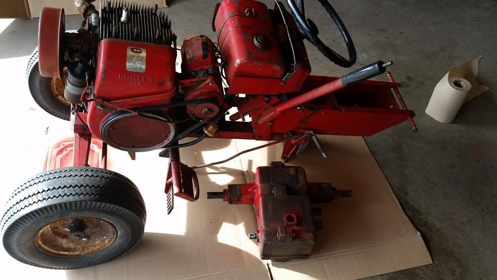

WHX?? 57,903 #22 Posted April 25, 2017 (edited) So here's where we are at on this gem. ....tranny is out and rebuild kit here from Lowell, by the way he screwed up the whole order and didn't include someone to work on it! Thoughts are here to get it open and cleaned up and ready to go back together and maybe bring it to Pioneer Power to put it back together? Might give us something to do other than sit around and wouldn't take long if we can get @stevasaurus to put his cup down for an hour? What ya think? Edited April 25, 2017 by WHX11 6 Share this post Link to post Share on other sites
