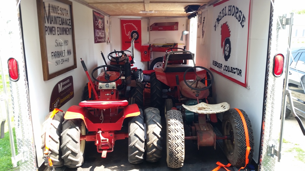

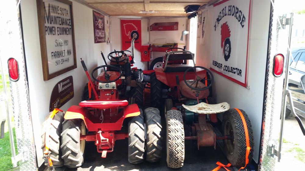

WHX?? 58,308 #2 Posted April 9, 2017 I woud run them close to the sides, about 8-10 inches or even closer which is ideal for horse hauling. You use tiedowns to wrap around the wheels and can get smaller tractors side by side. this may or may not be ideal for hauling other stuff tho. Don't have pics of tractors in it but @Shynon might. You can also get the recessed tie downs that you can litter the floor with and never be short of a tie point. Share this post Link to post Share on other sites

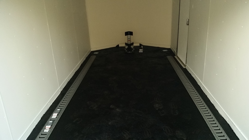

Shynon 7,723 #3 Posted April 9, 2017 I think I put mine 6" from the sides. Use rings that go into the e track then ratchet the downs 1 Share this post Link to post Share on other sites
ericj 1,580 #4 Posted April 9, 2017 I don't have pictures of my enclosed but I put mine closer to the center of the tractors and use 2 tie downs and criss cross them front to back under the tractor, tied to the frame. I do like the idea of strapping over the tire. what happens when you haul a tractor with a deck on, and have to keep it further away from the sides. with them in the center I can still strap the the front and rear axles. I would not want E-track on the floor of any trailer that I would be hauling dirt , mulch, or anything loose like that, that could get down inside the E-track. I might consider using more smaller D rings up and down the bed. I have a 2016 Appalachian 20 foot landscape trailer, I can haul 8 tractors on it. I have been just taking 1 strap per tractor to the side rails to tie them down. I've been considering adding the smaller D rings down the center or under the tractors, but haven't figured out where I want them to best serve my needs. I taking a wait and see what and where I need them eric j Share this post Link to post Share on other sites

WHX?? 58,308 #6 Posted April 11, 2017 On 4/9/2017 at 9:51 AM, ericj said: what happens when you haul a tractor with a deck on That is a problem with them mounted close but Tom nor I seldom haul a horse to a show with a deck so no problem. If we do haul one it will be in alone. If you are going to haul dirt or what not with e track put down a cheapy tarp first ..... will make cleanup easier. You could do eyebolts for on the top or side uprights, get stainless so they won't rust. Share this post Link to post Share on other sites
