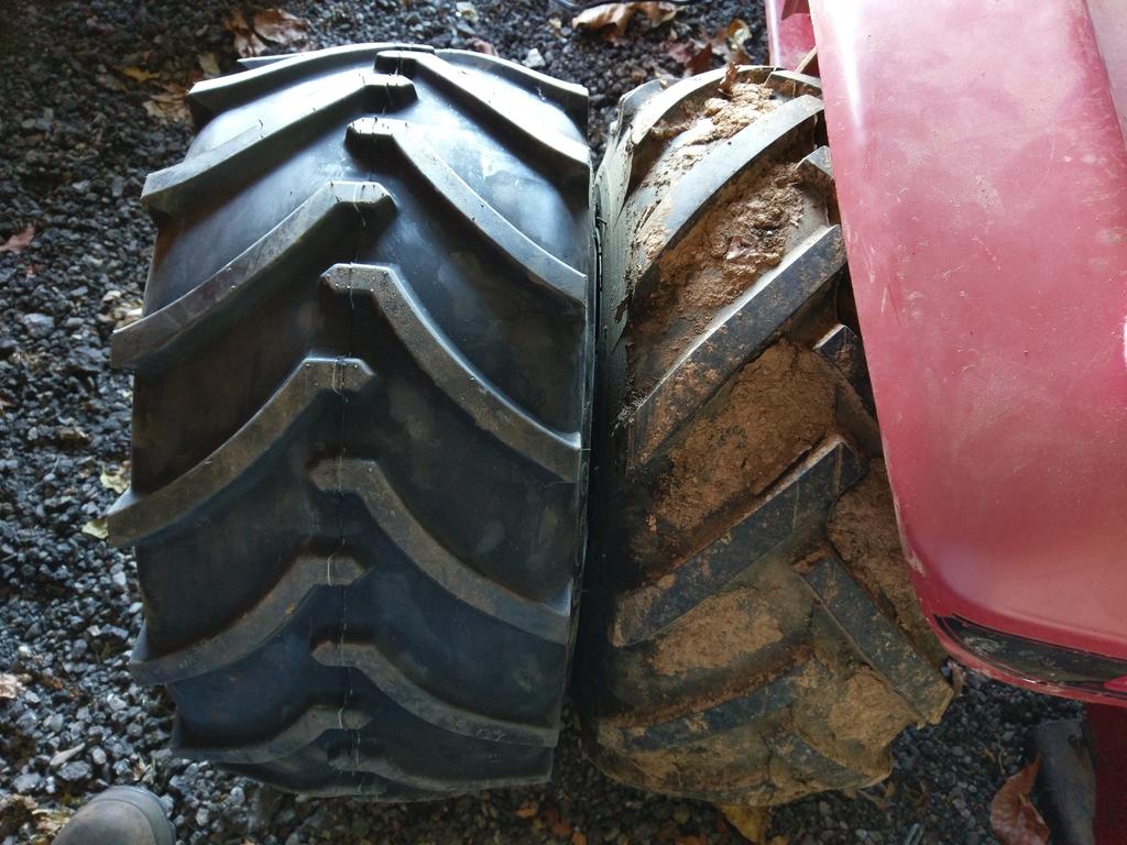

WVHillbilly520H

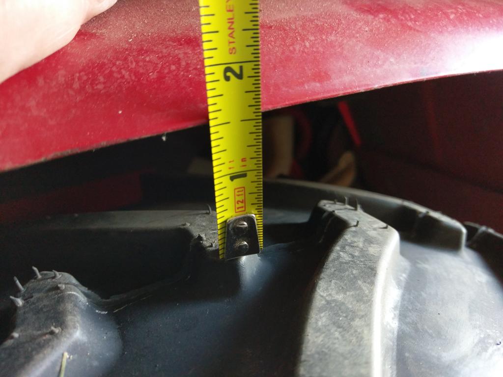

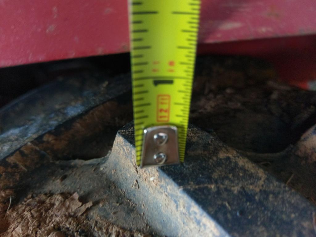

Jim, yep going back on the anniversary snow chucker, and diameter wise being cold in the no door shed the OTRs seemed to have "shrunk" sunk down in the middle vs the old tires still holding fluid and air, and if I remember tomorrow I'll try to get tape measure on them, I really think they're gonna be some "diggers" ,Jeff.

PeacemakerJack
Jeff—I think those tires are going to work very well. There is nothing that I see in the pics that causes me concern.  They look tough and seem to have a fairly square lug.  For furrow plowing, you want as square of a lug as possible to really dig in.  One of the things that I’ve always liked about the TruPowers is that when your tractor is tilted in the furrow, you have a very square lug digging into the furrow on the outer edge of the right tire and on to the land on the inner edge of the left tire.  Many of the cheaper or more basic AG tires have very little lug if any on the outer edge which allows for more spin when the ground is tough. Also note that the TruPower goes from a 45 degree back to about a 23 degree on the last couple inches of lug.  For furrow plowing, that is one of the most important spots. I like what I see with the tires that you picked up Jeff and I can’t wait to see what they look like mounted on your 520.  I’m also looking forward to a report as you use them over the next year or so...:popcorn:

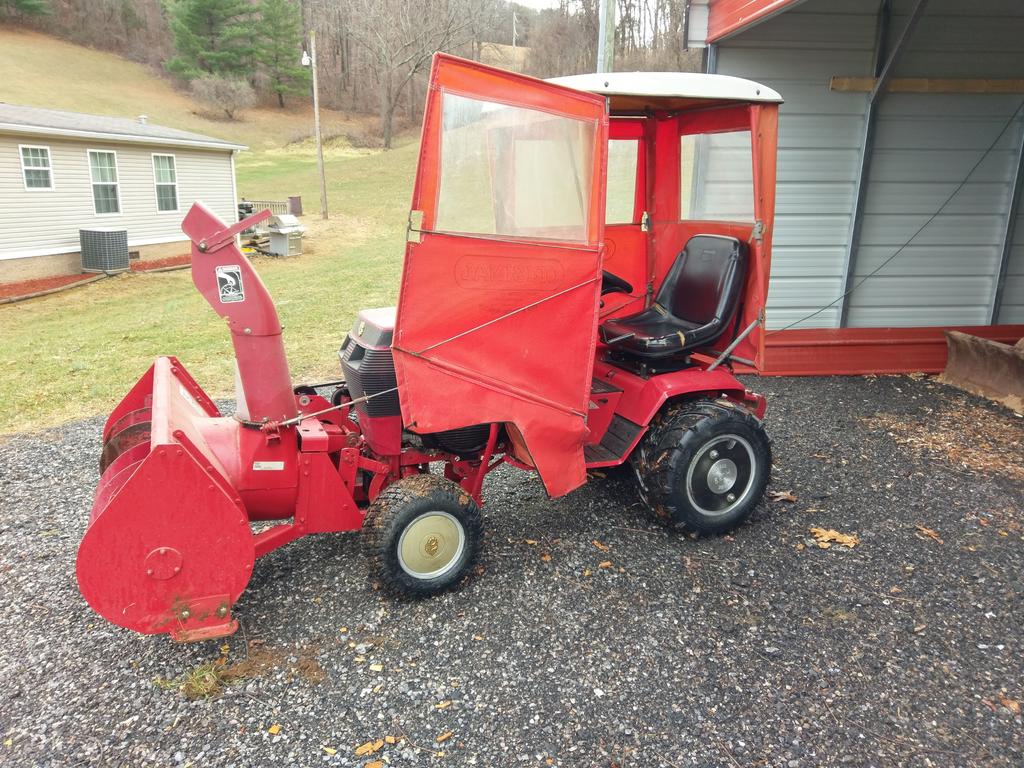

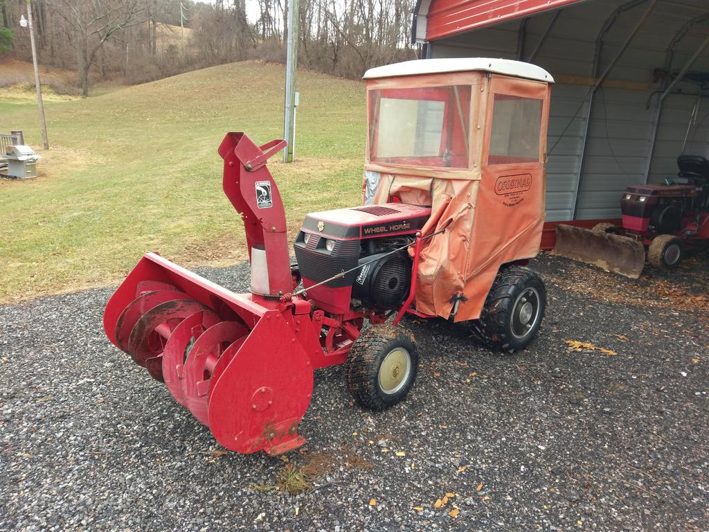

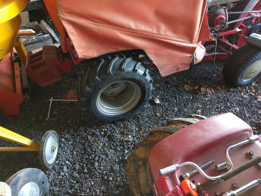

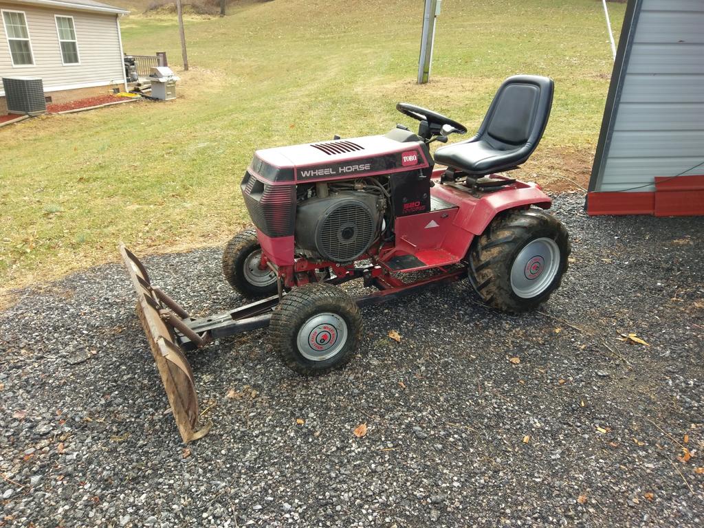

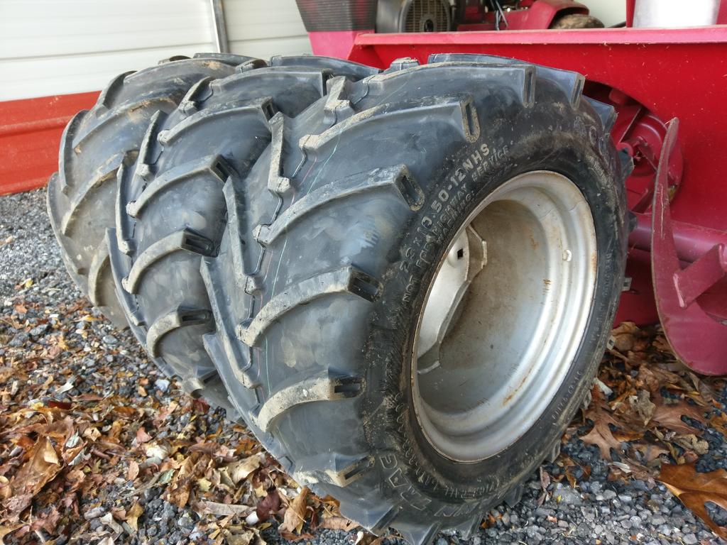

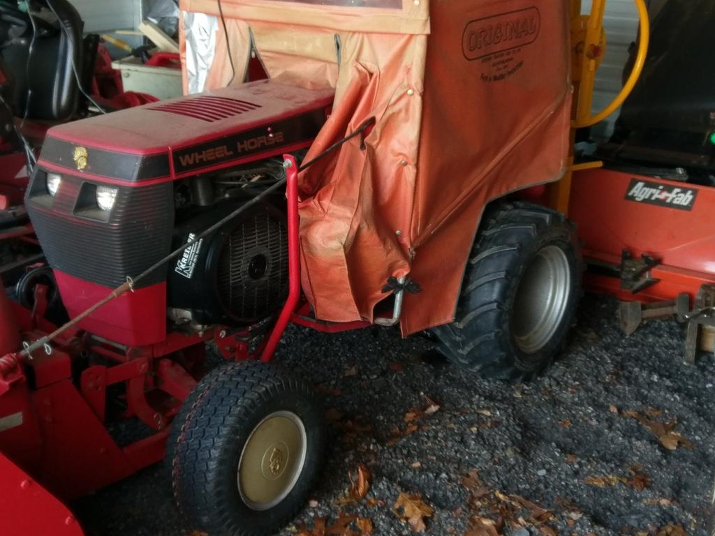

WVHillbilly520H

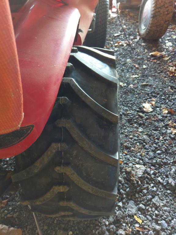

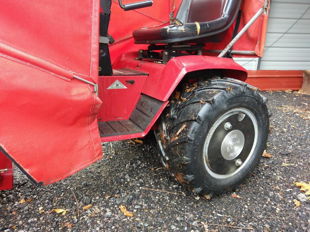

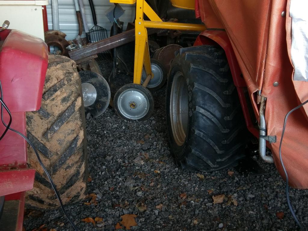

@WHX14,and @PeacemakerJack, here y'all go braved the global warming wind and temps and got them swapped out with the existing fluid I had in the old 2 ply Nankangs that had seen better days and came home and stayed out in the Red Tractor Shed long enough to slide them under, add lug bolts and take a few pics, not quite 1/8" shorter than the new Nanco/Deestones but more than an 1" wider, I'm pretty happy with the stance myself I report back after a ride or 2, hope this helps you out and enjoy, Jeff.
  • Like 1
  • Thanks 1
PeacemakerJack
Those sure look good on there Jeff!  Thanks for the pics and the information.  I certainly think that you made a wise decision...now you get to use them and let us know how they work for you over time...:thanks:
  • Like 1
  • Excellent 1
  • Thanks 1

Yes 'Billy thanks for the pics.:handgestures-thumbupright:. You got me thinkin about those 24-12's now tho. The tale of the tape says they almost might go without fender cutting but I do have an extra set of fenders that could be modded to fit so it's just a matter of bead width on stock rims. Those old tires aren't the worst.. a real hillbilly would run them till they dry rotted off! :laughing-rolling:

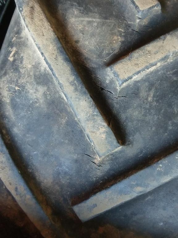

Yes 'Billy thanks for the pics.:handgestures-thumbupright:. Those old tires aren't the worst.. a real hillbilly would run them till they dry rotted off! :laughing-rolling:
Well I figured since I put new ones on the front after nearly 20 yrs why not the rear too, now I reckon I need to find a NOS cab and make it all pretty...

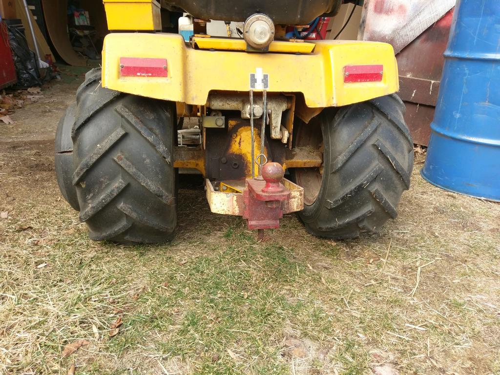

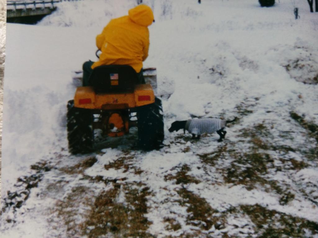

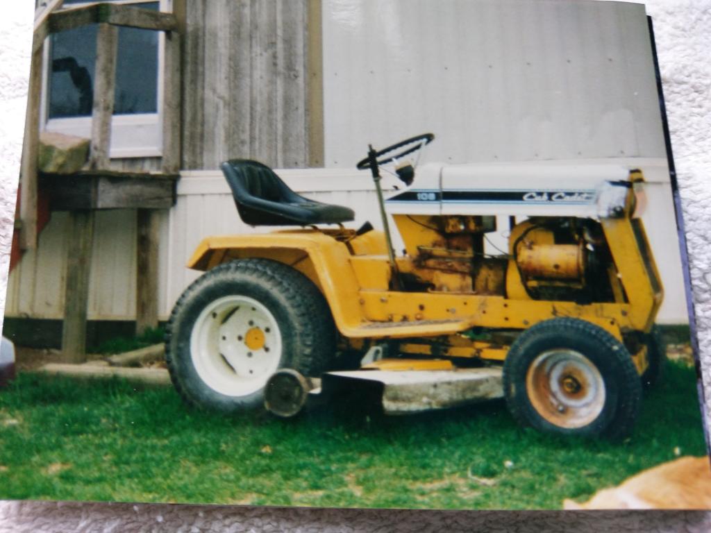

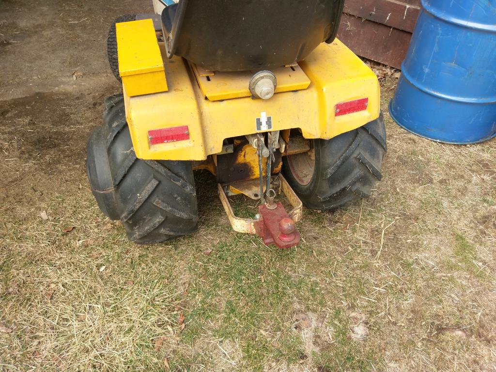

Ok doing the math a 24" tall tire is only a half inch taller in diameter from center shouldn't be an issue there and I put 10.50s on my old CC 106 with the stock wheels for 8.50s didn't balloon too bad...best pic I have of it...

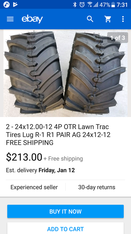

@WHX14, here you go Jim bigger is better right...

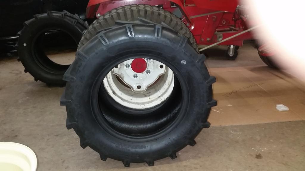

WHX??

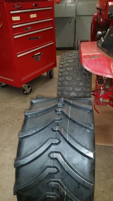

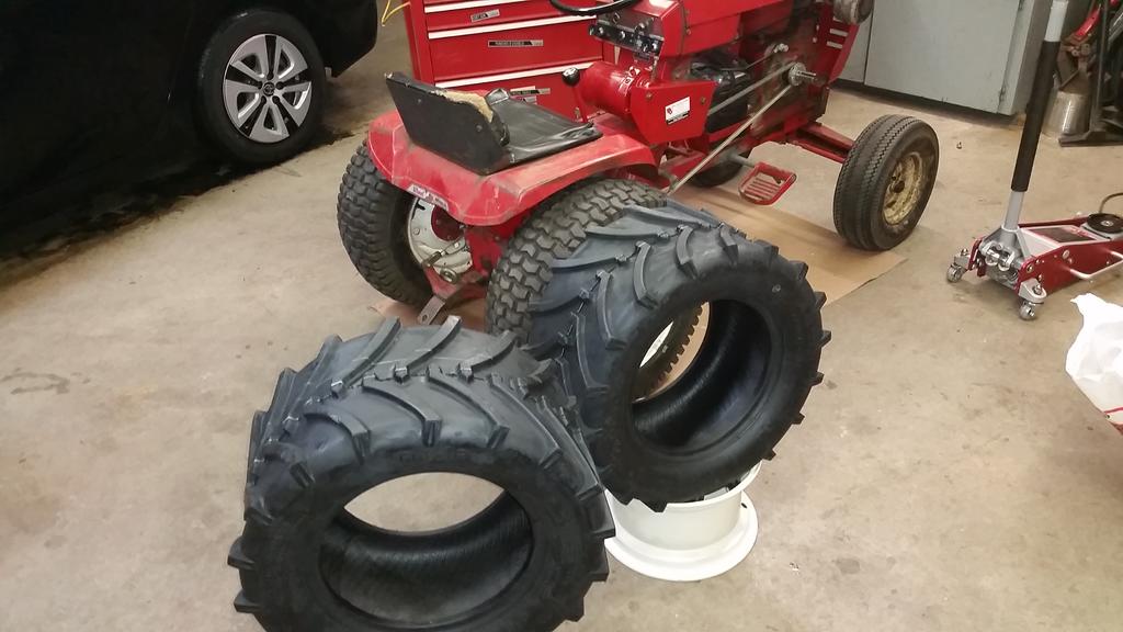

Just showed up yesterday... appear to be a bit short but very wide. ill get them mounted and aired up today. Not sure if I am going to load them or not will have and see how they perform under plowing conditions.
Btw the tires, front and rear on that tractor are orginals from '67 and in beautiful shape no checking or cracking at all. Going to clean up, armor all &  letter the WH on them and on a show tractor!
  • Like 1
  • Excellent 2
littleredrider
Got a link to those 24s? Thinking i want a pair!! Don’t forget they are shorter, but once mounted n aired up should be close or taller.
  • Like 1
PeacemakerJack
Those are good looking tires Jim.  It will be fun to see them in action:auto-layrubber:.  I like them on Jeff’s ride and I can’t wait to see them on yours...:popcorn:
  • Like 1
  • Thanks 1

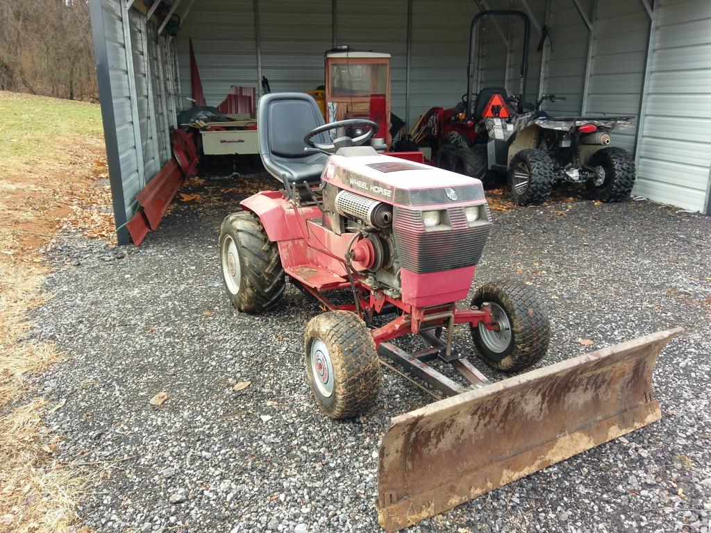

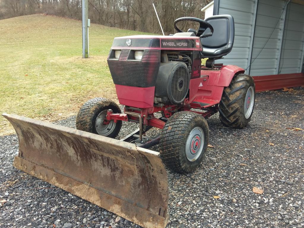

WVHillbilly520H
@littleredrider, when on :techie-ebay:just search for 24x12-12 AG tires and these and Deestone normally pop up, just refer to my post above #62, Jeff.

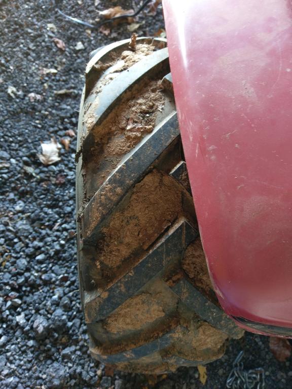

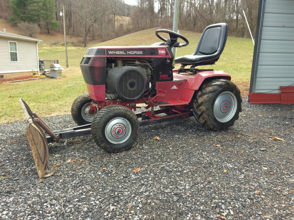

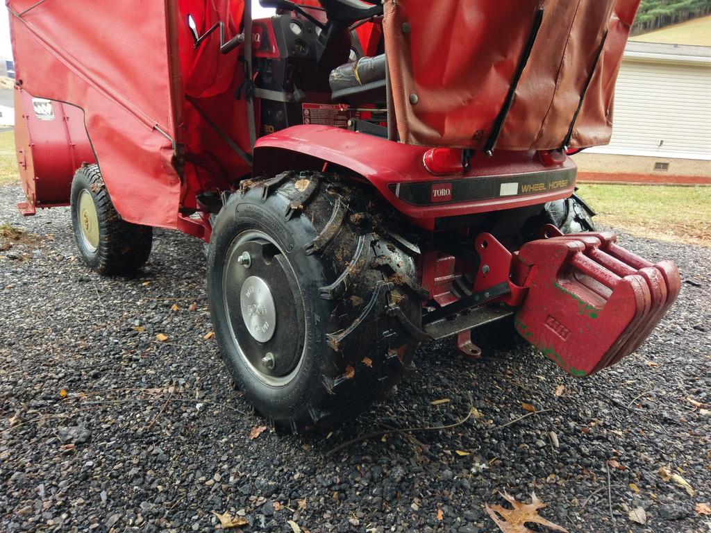

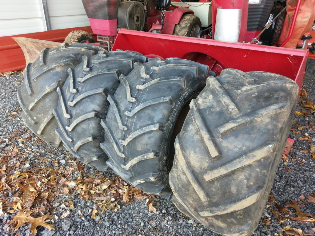

Since it was warm out today I finished up my tire/wheel/weight install and took it out for a ride in the rain soaked yard, took it about half way up the steepest slope next to house never slipped or spun once , if it ever snows gonna try it out unchained first and see how they do, even had the '95 out for a stretch too, Jeff.
  • Like 1
  • Excellent 2

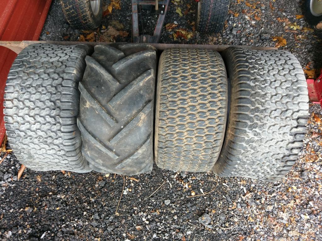

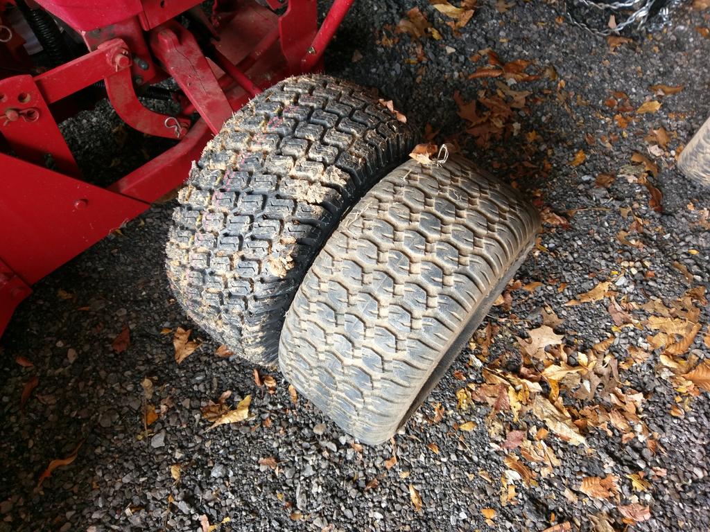

WVHillbilly520H

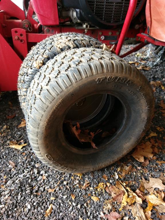

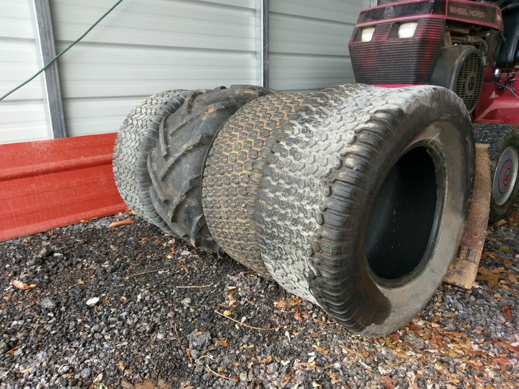

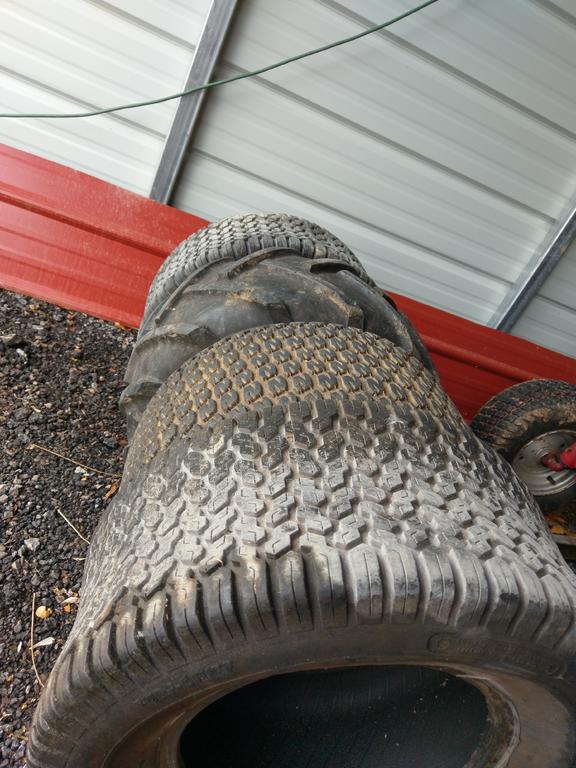

Just for a full round of comparison I found the turf tires that originally came on my Anniversary 520H, when I bought it the dealer said one of the factory installed rear tires was cut during shipping/unloading? either way he replaced them with Carlisle Turf Chief, which I had loaded when I bought it, ran them 9-10 years bought the new/used Nankang AGs and of course just changed them out to OTR, anyways here's the original Dico turfs from the '95, the Carlisle turfs from the anniversary, and the Nankang AGs all in a row for comparison is size, the Carlisle seem to be taller and wider than the other 2 without air, even my new Trac Gard 16x7.50-8 look bigger that the Dicos,  Jeff.
  • Thanks 1

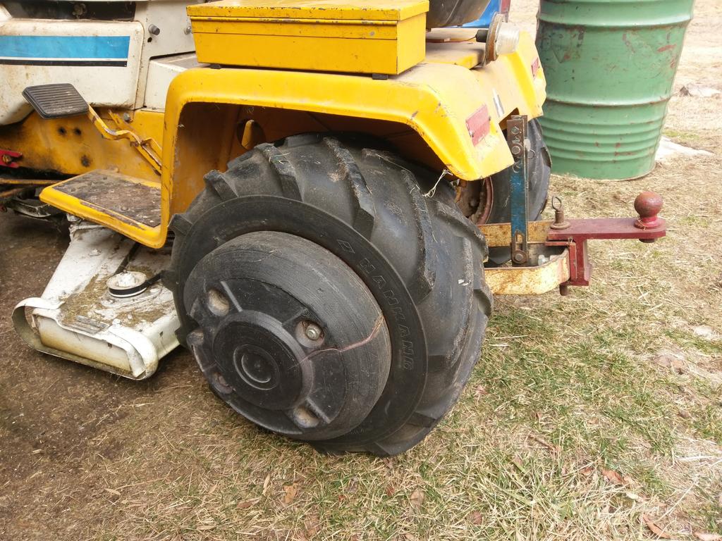

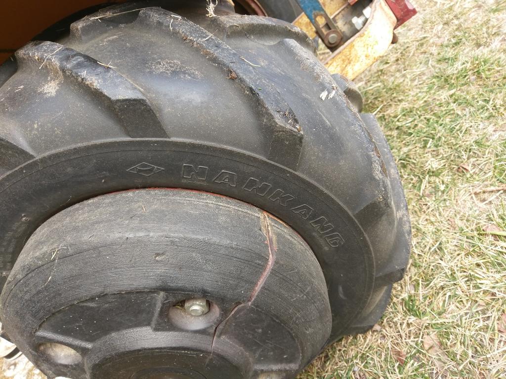

WVHillbilly520H

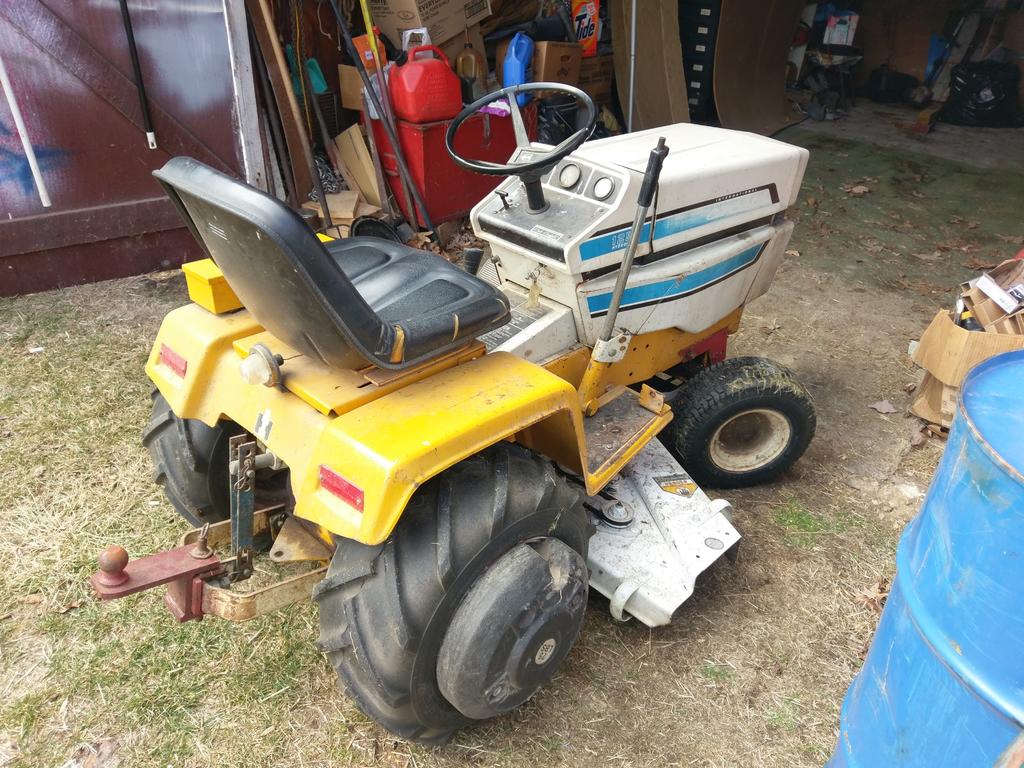

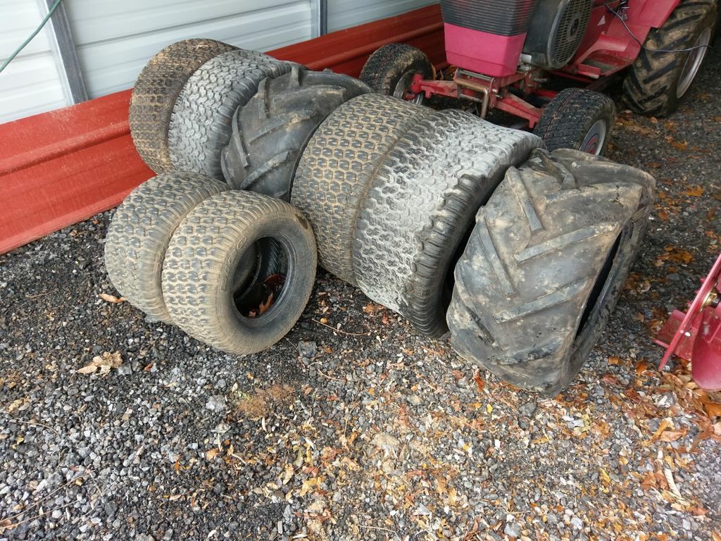

@WHX14 and @PeacemakerJack here's those Nankangs I bought brand new around '93/'94 for the 106 CC,  when I bought the anniversary 520H, I swapped out these tires on dad's CC 1200 before I sold the 106 with his Good Year Turfs, they have been on dad's 1200 since '98 tilling/plowing the garden, pushing/blowing snow, getting firewood and now mowing but always shed kept,  Jeff.
  • Like 1
  • Excellent 2
WHX??
What size did you say those are?
WVHillbilly520H
Jim, all the rears are 23x10.50-12 first on my old 106 then on dad's 1200, Jeff.
  • Like 1

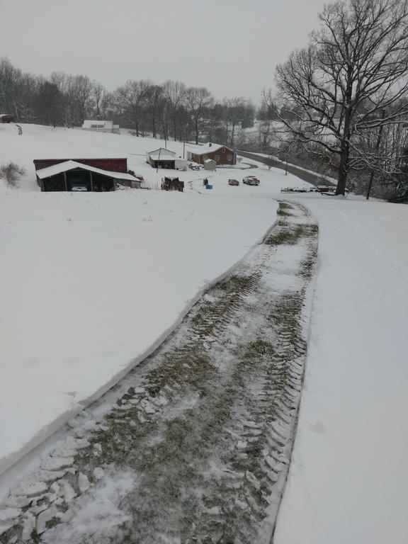

WVHillbilly520H

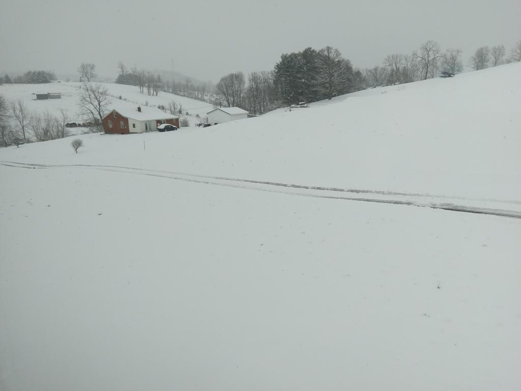

@WHX14, finally got some measurable snow here and went on the maiden voyage with the OTR AGS, NO chains NO complaints pushing the 2stage up and through 7" wet heavy white crap, first impressions (with plenty of weight liquid and iron) I'm very pleased with my purchase had a few places where I wondered if I was going to make it but they found traction and pulled right out, follow the yellow line and that's everything I cleared last evening, on a side note don't install rubber paddles on the impeller if you have a gravel drive way as my BILs gravel ate most of the rubber away 🤕, Jeff.
  • Like 1
  • Excellent 2

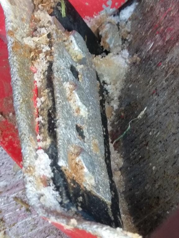

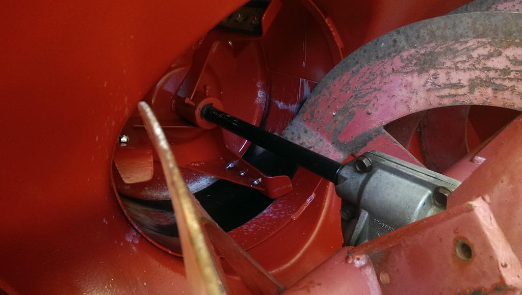

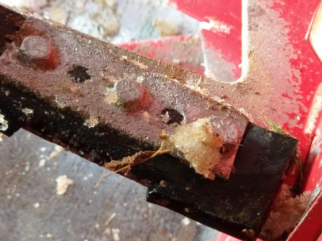

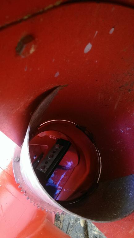

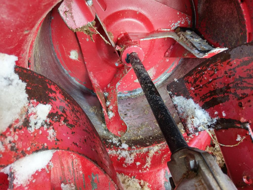

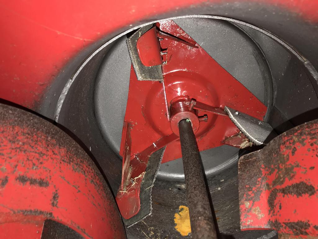

Thanks for the update Jeff on the AG’s. Looks like they were up to the task.  If you get a chance, post a pic of your impeller. I’d like to see what happened to the rubber paddles. I’ve only used mine twice since I installed the belt stock but it seems to be holding up fine so far. Those OTR’s look really good on there for sure:handgestures-thumbupright:
  • Thanks 1

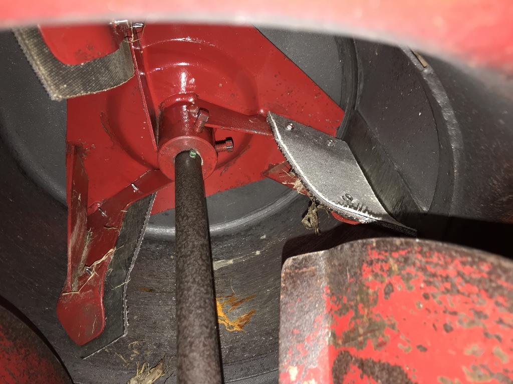

WVHillbilly520H
Here's a few shots of the impeller now and before, the gravel was about 3" deep and hard to keep the blower from digging in  or completely going over the snow, this is where an older single stage could be a sacrificial unit :think:
  • Sad 1
PeacemakerJack
I only have blown snow twice with mine since the upgrade. The first snow was perfect—frozen ground and about 22-25 degrees making the snow a perfect powder. The second time was two weeks ago and it was sloppy—wet heavy snow, soft ground, closer to your conditions.  I only made a path in the drive and cleared the turn around. So far mine are holding, we will see though...ED700AF7-4B85-4109-B9D2-BF175AA98DC6.jpeg.48d66d2bbcb3d6a4bfe6e3405d69a74b.jpeg
you can see that the graphite paint is completely gone from the impeller housing already though.
I’ll keep everyone posted on my findings as I continue to use it through the upcoming years.
thanks again Jeff for keeping us in the loop.  I always tell people that I learn more through product failure than I do through its success.  Unfortunately it seems that way with life sometimes too...
