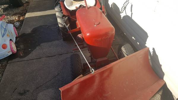

slim67 2,825 #1 Posted March 3, 2017 Has anyone ever had to remove paint that was sprayed over decals? I have some ideas but would like to hear yours. Both hood decals and frame decal have been sprayed over. 1 Share this post Link to post Share on other sites

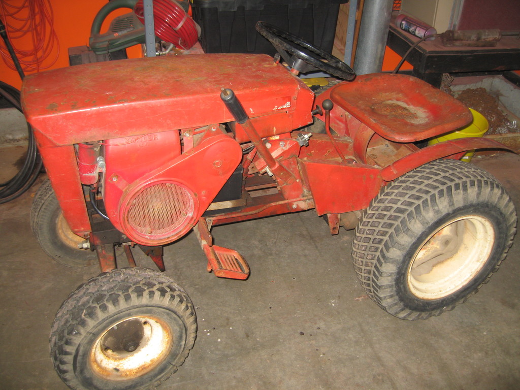

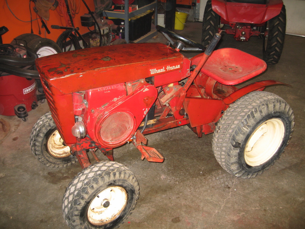

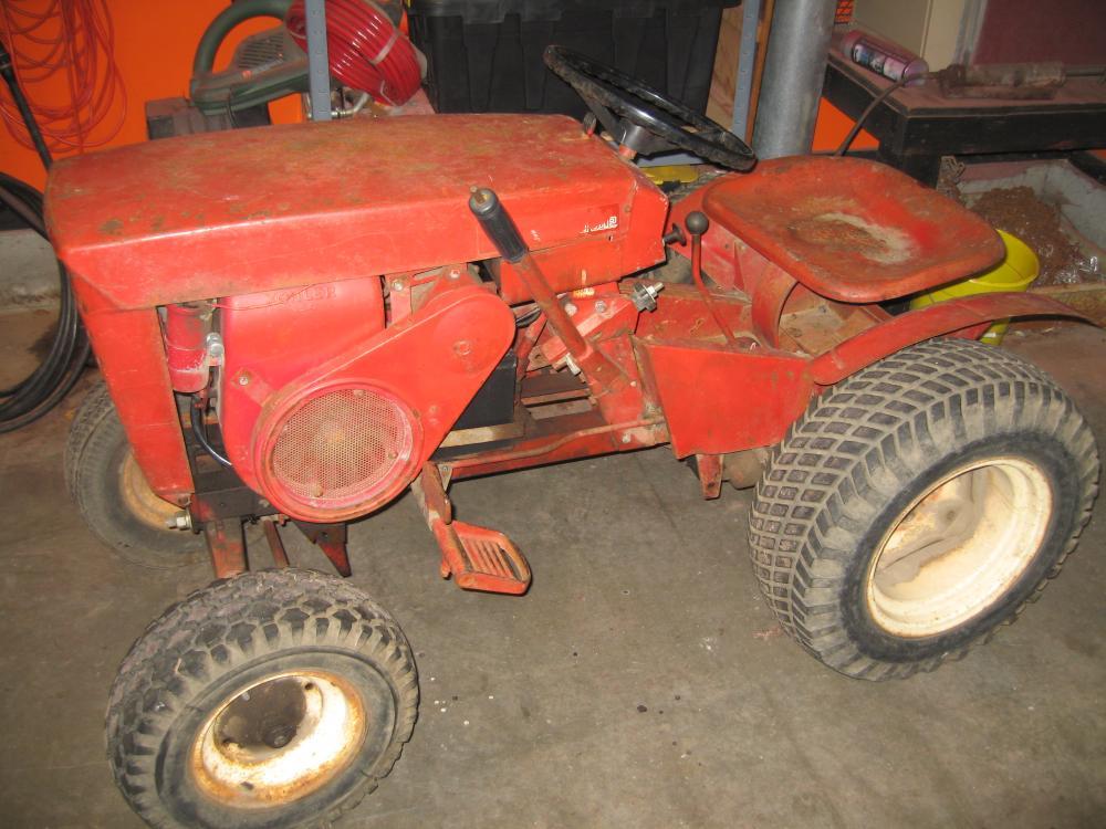

Shynon 7,604 #8 Posted March 3, 2017 1 hour ago, Terry M said: Send a PM to @Shynon...I've watched him remove paint off of original decals with good success.. Just can't remember what he used.. Acetone or Lacquer thinner, you need to be careful with them as they can eat up the decal. PO had spray painted this 1045 with some orange paint, I washed it off with Lacquer thinner. 5 Share this post Link to post Share on other sites
