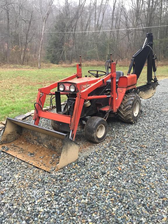

jgrammer243 16 #1 Posted February 28, 2017 So I am new to the wheelhorse game, however I stumbled upon a D160 with a loader and backhoe that I couldn't pass up. After just a few dollars spent I got it running. all hydraulics work, but the tractor wouldn't move. Found axle shaft broken on the drivers side. Dropped the backhoe off and dropped the transmission. Split the case and found all the carnage... 2 needle bearings fell apart, a differential bolt was sheared off in two places. The half of the differential where the axle shaft broke off in was pretty tore up. Finding parts is my biggest issue so far. I've found the axle seals and needle bearings, however the differential seems more difficult. Is there any place anyone is getting parts from that I'm missing? Any help is appreciated. Pictures to follow! jeff 3 Share this post Link to post Share on other sites

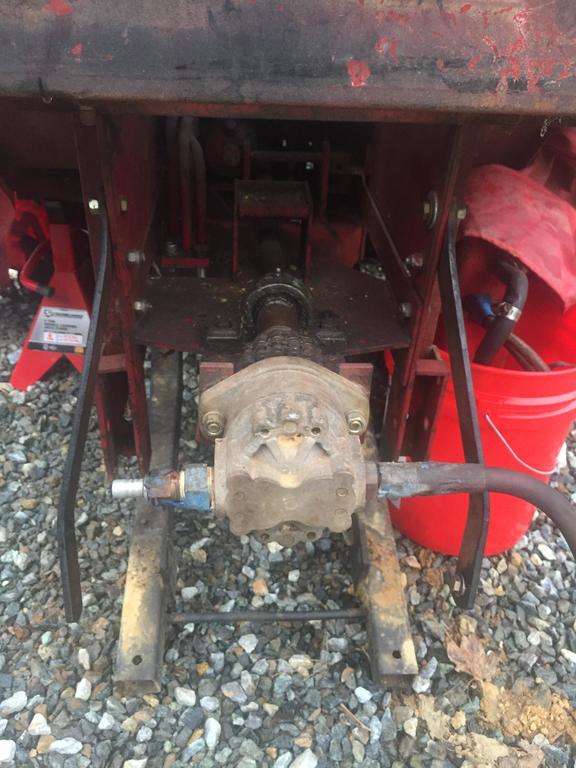

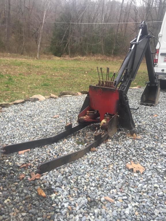

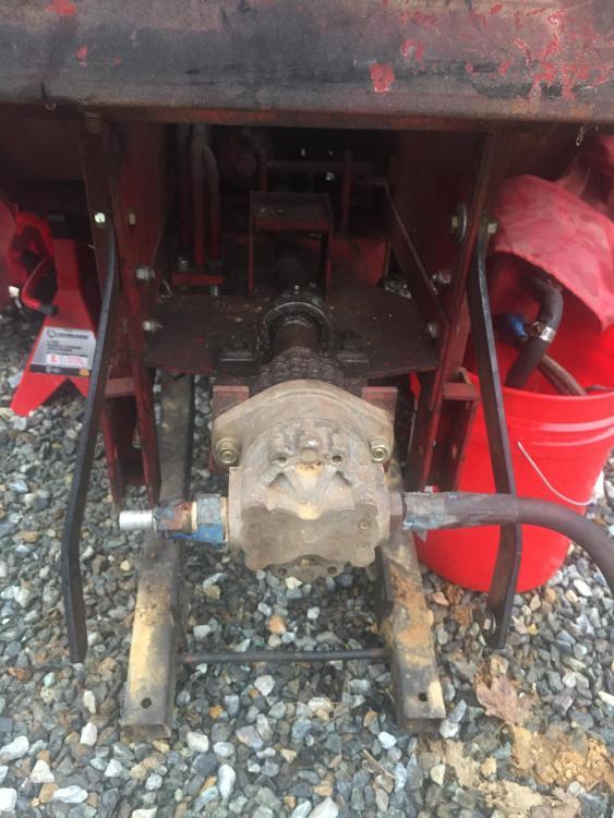

Texas Todd 1,026 #12 Posted March 1, 2017 @daveoman1966 should be renamed "Easy Button" Nice! I'd like to see the how the backhoe attaches. I have a loader but am curious what to look for in a backhoe and if it uses the same hydraulic pump as the loader. Thanks! 1 Share this post Link to post Share on other sites
jgrammer243 16 #13 Posted March 1, 2017 the backhoe has a separate pump!@Texas Todd 1 Share this post Link to post Share on other sites
Texas Todd 1,026 #14 Posted March 1, 2017 Thanks @jgrammer243 ! Man that beats all I ever stepped in. That's a whole lot of structures under the tractor! Seems like there wouldn't be enough space for all of it, with the FEL mount to boot. What do the forks at the front of the two big side rails hook into? I couldn't tell from the pic at the top. It sorta looked like the footrest rods. I guess I could just go find the manual and answer my own questions....I know that's what some of you guys are thinking.... Share this post Link to post Share on other sites
jgrammer243 16 #15 Posted March 2, 2017 haha it's all good i'll take some pictures tomorrow! it's a slotted hole that bolts underneath the frame. FEL is an Ark manufacturing . backhoe is brantly mfg. more pics to follow, as well as the trans rebuild! 1 Share this post Link to post Share on other sites
