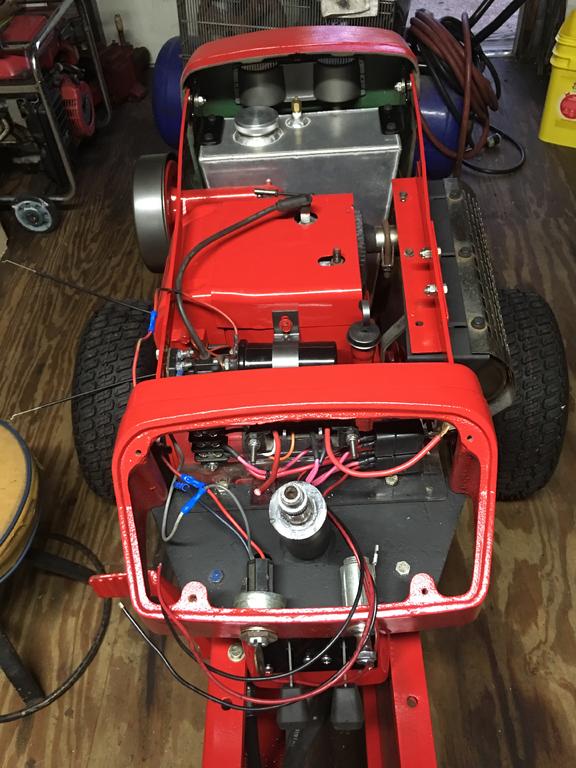

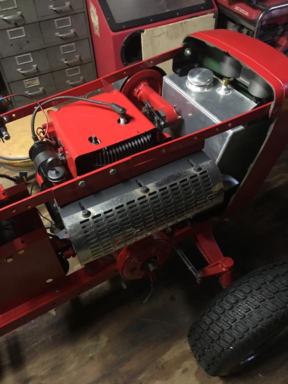

19richie66 17,937 #352 Posted May 15, 2018 (edited) Little more fit, finish and figuring things out in between rain storms. Wanted to get the front on. Lost my battery tray somewhere in the shed, lol. I dont have the correct hole in the block for the belt guard so I have to get something there worked out. No big deal. I have plenty of duct tape. As she sits today...... Edited May 15, 2018 by 19richie66 3 11 Share this post Link to post Share on other sites

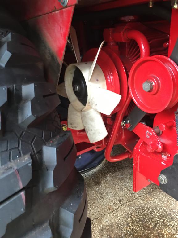

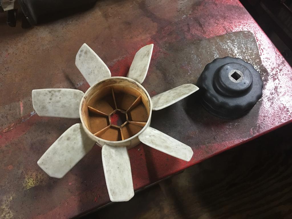

19richie66 17,937 #353 Posted May 15, 2018 (edited) @bmsgaffer This is the fan I am hoping to use. I have an oil filter wrench that I am turning down for a hub to fit inside the fan. Going to cut out the center of the fan so the fan slides over the pulley snout and then I will epoxy the “hub” inside the fan to make it all one piece. The bolt will go through the center and rest on the pulley snout like the original. Crossing my fingers Edited May 15, 2018 by 19richie66 9 Share this post Link to post Share on other sites
bmsgaffer 2,071 #354 Posted May 16, 2018 16 hours ago, 19richie66 said: @bmsgaffer This is the fan I am hoping to use. I have an oil filter wrench that I am turning down for a hub to fit inside the fan. Going to cut out the center of the fan so the fan slides over the pulley snout and then I will epoxy the “hub” inside the fan to make it all one piece. The bolt will go through the center and rest on the pulley snout like the original. Crossing my fingers Nice! That looks like it will move a ton of air. Better than the original! 2 1 Share this post Link to post Share on other sites
19richie66 17,937 #355 Posted May 17, 2018 (edited) All this work to get this fan on here and it was pointed out to me I have the wrong direction fan. Thanks @wallfish. I was looking at it spinning from the wrong way. Back to the drawing board Edited May 18, 2018 by 19richie66 8 Share this post Link to post Share on other sites

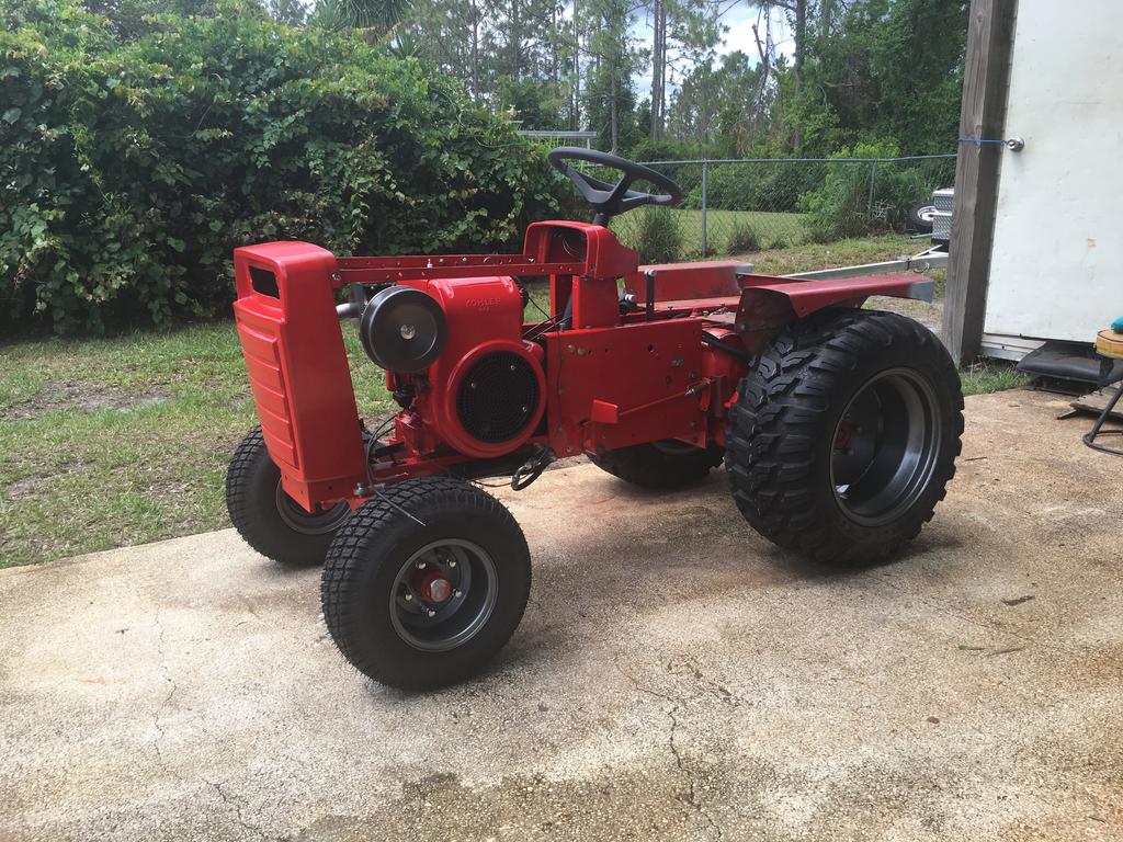

WHX?? 58,301 #356 Posted May 18, 2018 Nice thinking outside the box on the mount ...Can't just flip it around? Wasn't sure if I liked those rears at first Richie but starting to grow on me! I guess I'm just stuck in an AG tire mindset. 1 2 Share this post Link to post Share on other sites
19richie66 17,937 #357 Posted May 18, 2018 I’ll get it figured out. As far as tires, I have ags on the tractor I mow with and they dig up my yard in the back pretty bad. Swapping my deck over to the 417 soon anyways and it has turf tires. I have a very sandy soil lot. Good for water drainage, bad for growing grass. 2 Share this post Link to post Share on other sites
WHX?? 58,301 #358 Posted May 18, 2018 6 minutes ago, 19richie66 said: have a very sandy soil Same here Ritchie, I live on a big sand hill and grass was impossible to grow without hauling in tons of topsoil and even then. Turfs & deck rollers would even dig what little grass I had up. Got real old always dragging sand in the house. Installed a DIY underground sprinkler system and now I can get grass to grow in the cat box if needed! I do have an almost unlimited water source tho. 1 2 Share this post Link to post Share on other sites

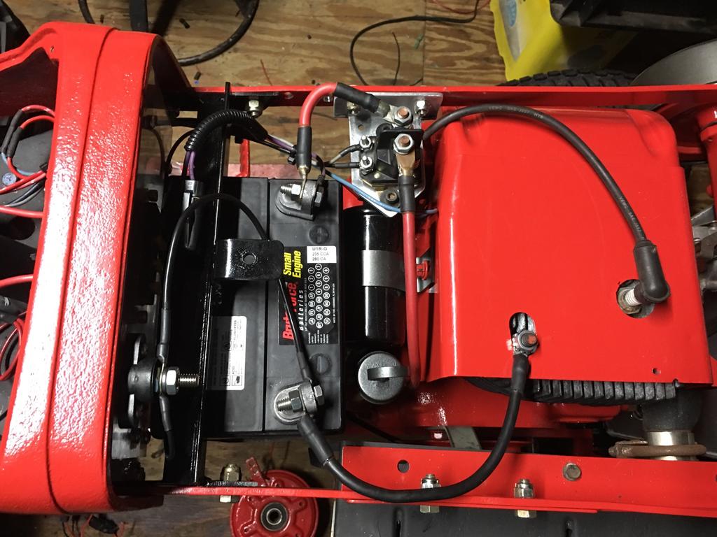

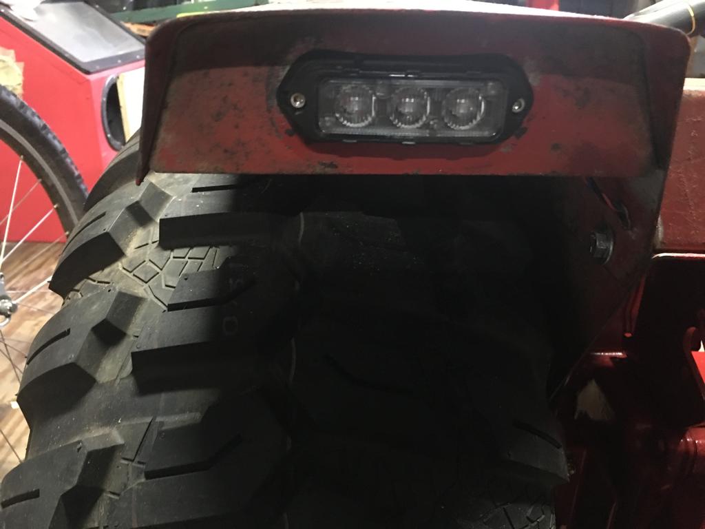

19richie66 17,937 #359 Posted May 24, 2018 Well a little more done. Finally moved her inside so I could work out of the rain. Got my new tail lights mounted, ignition switch in and wiring figured out. All temporarily wired up to get it working correctly. When it is right I will make a complete wiring harness. Fuel tank in, solenoid in. Next up is to run the fuel line, filter, and get the right length belt...... baby steps before leaps and bounds 👍 5 6 Share this post Link to post Share on other sites
19richie66 17,937 #360 Posted May 26, 2018 (edited) Well we have spark and she turns over. Throwing some fuel to her tomorrow. Hope for the best. Edited May 26, 2018 by 19richie66 7 2 Share this post Link to post Share on other sites

RandyLittrell 3,946 #366 Posted May 26, 2018 13 hours ago, 19richie66 said: Well we have spark and she turns over. Throwing some fuel to her tomorrow. Hope for the best. I like the solenoid placement! Your wiring is looking great! Randy 1 1 1 Share this post Link to post Share on other sites

squonk 48,210 #368 Posted May 26, 2018 1 hour ago, RandyLittrell said: I like the solenoid placement! Your wiring is looking great! Randy Sure does but that clutch could use a little alignment! 1 2 Share this post Link to post Share on other sites
19richie66 17,937 #369 Posted May 26, 2018 👁 Eagle eye 👁 1 Share this post Link to post Share on other sites

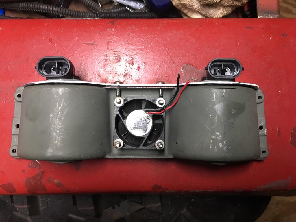

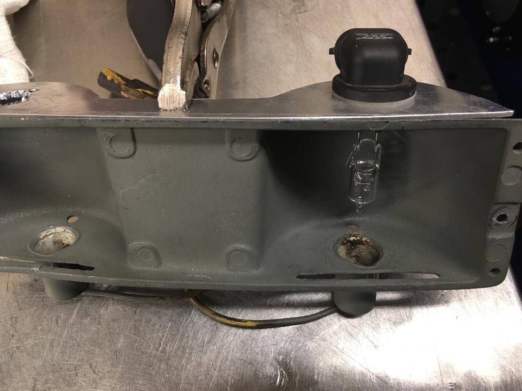

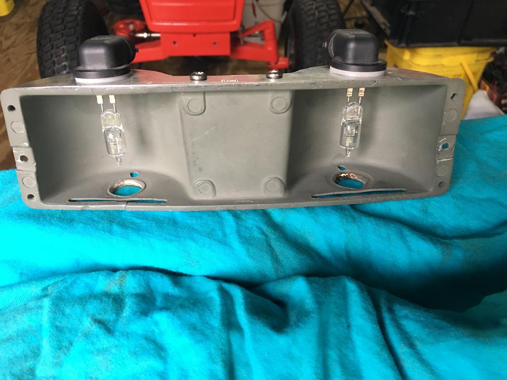

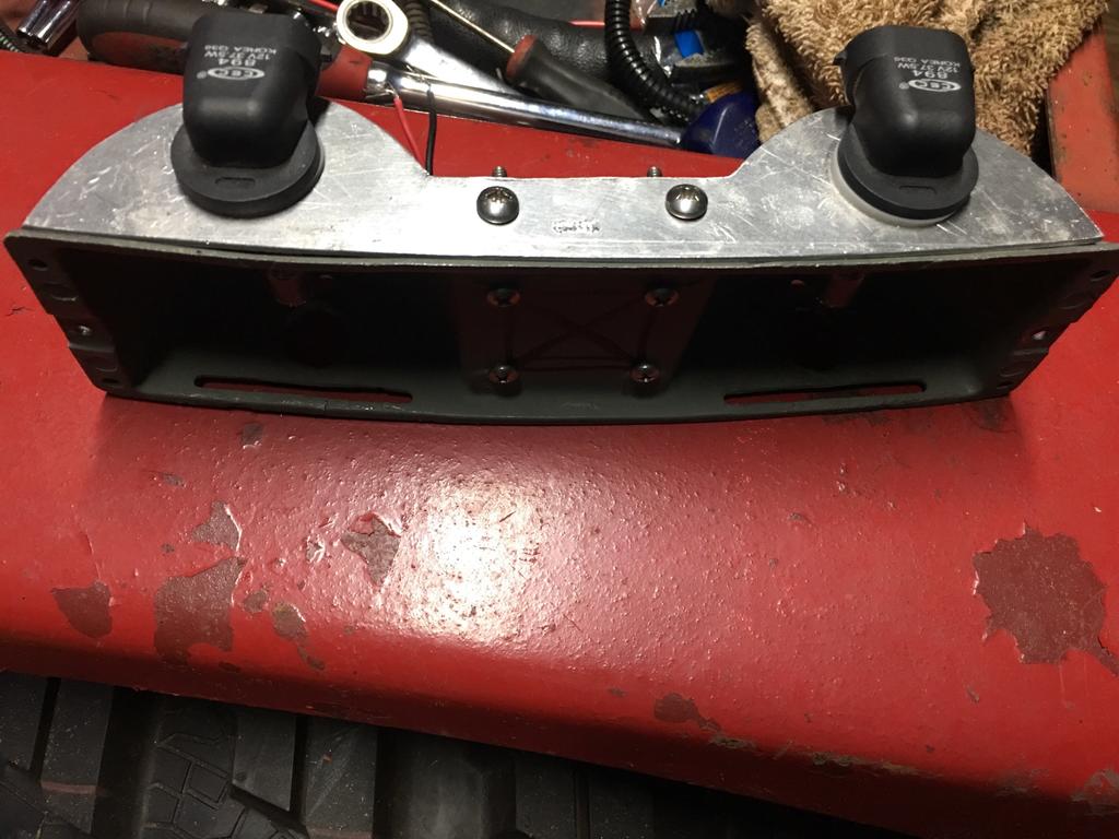

19richie66 17,937 #370 Posted May 26, 2018 (edited) Need new points, plug,condenser. Fuel pump would not pump fuel so off it comes and an electric pump will take it’s place. Building a mount monday. So while I am waiting to get parts, figured I would get my headlight situation taken care of. The factory light housing fits fine with the fuel tank but it hits the wires and presses them into the socket lip. So rather than try to fix it, upgrade it. 😁 I had gotten another headlight housing from Aldon but when I got it, it was cracked from shipping, so I had no problem modifying it. I made a plate for the top and cut my holes for twist in halogen bulbs. I’ll replace them later with LED replacements. I had some small fans from I bought a long time ago from a surplus place. Mounted it up and will drill the air feed later. Should work just fine. Should....... Edited May 26, 2018 by 19richie66 4 4 Share this post Link to post Share on other sites
Texas Todd 1,026 #371 Posted May 27, 2018 Your attention to detail is admirable. 1 Share this post Link to post Share on other sites
Aldon 4,833 #372 Posted May 27, 2018 (edited) The halogens will keep snow from building up if you ever use it in colder clime. Id leave them if the fan provides enough cooling to keep from melting the lens. Edited May 27, 2018 by Aldon 1 Share this post Link to post Share on other sites
953 nut 69,778 #373 Posted May 27, 2018 Air conditioned headlights, what will you Floridians come up with next? 4 Share this post Link to post Share on other sites
