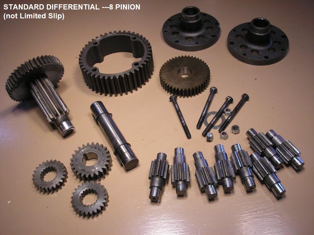

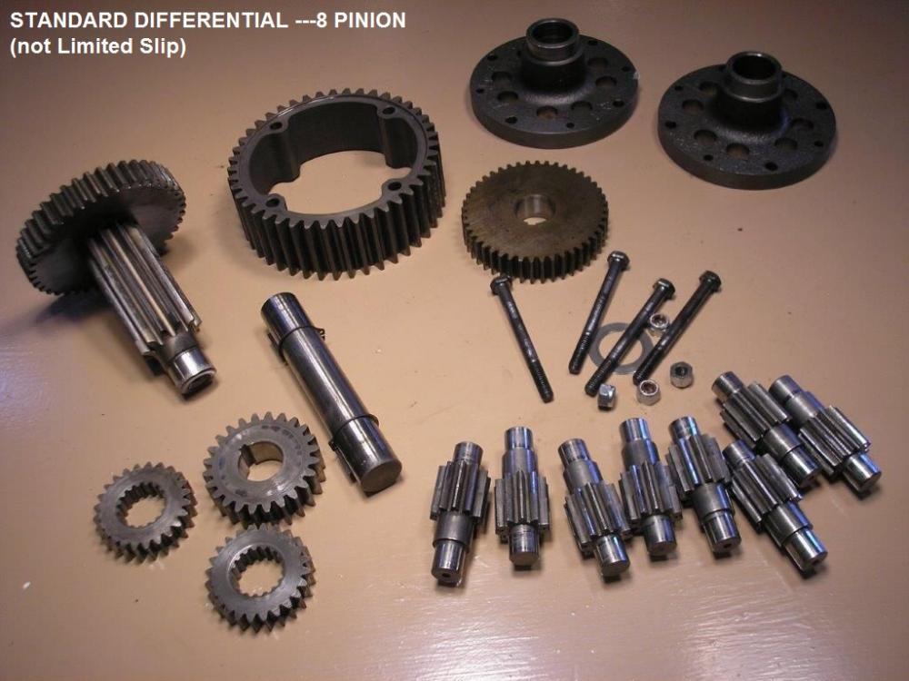

Docwheelhorse 2,992 #3 Posted January 7, 2017 Most Wheel Horses are "peg leggers" aka---one wheel drive. There where the 10 pinion diff 8 speeds but most broke if abused and hence gave way to the common and strong 8 pinion which was available in the autos and manual transaxles. I dont know about the D250s or a few other models. I wouldnt be worried about a rebuild just yet. Tony 2 Share this post Link to post Share on other sites

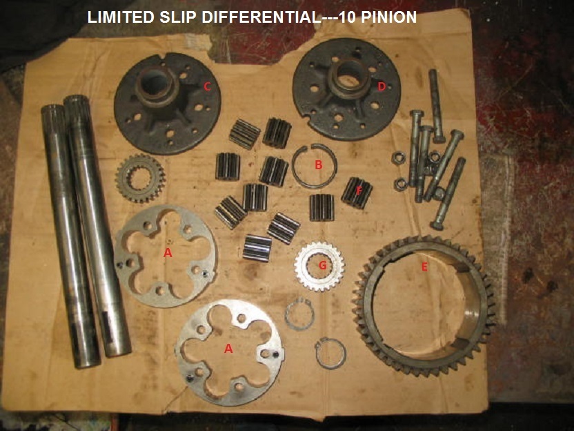

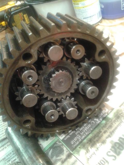

stevasaurus 23,861 #7 Posted January 8, 2017 Bob...your transmission (if original) in your C-160 1974 Model # 1-0480 is a # 5088. It is an 8 pinion differential with 1 1/8" axles. It never was a limited slip...those are ONLY 10 pinion differentials. Maynard is not correct in his statement...hydros did have a lot of 10 pinion limited slip differentials...I'll list them if I need to....you would be surprised at how many there are, but yours is not one of them (if original). What you are describing is exactly how an 8 pinion differential should work. I am not sure why you think you need to go into it...maybe type that in the next post. 2 Share this post Link to post Share on other sites
daveoman1966 3,884 #8 Posted January 8, 2017 Other than opening the gearbox, another way to decide if a 10-pinion LIMITED SLIP DIFFERENTIAL (LSD) or not...do this: Jack both rear wheels off of the ground. Slowly turn one wheel...If the other wheel turns the SAME direction, then it is a 10-pinion LSD. If the wheels turn in OPPOSITE directions, then it is not LSD (4 or 8-pinion gears in diff). This is true for either Sundstrand hydros and Wheelhorse 8-speed manuals (6 speed). Presumably the differentials of Eaton automatics will respond in the same way to determine whether LSD or not.. 5 Share this post Link to post Share on other sites

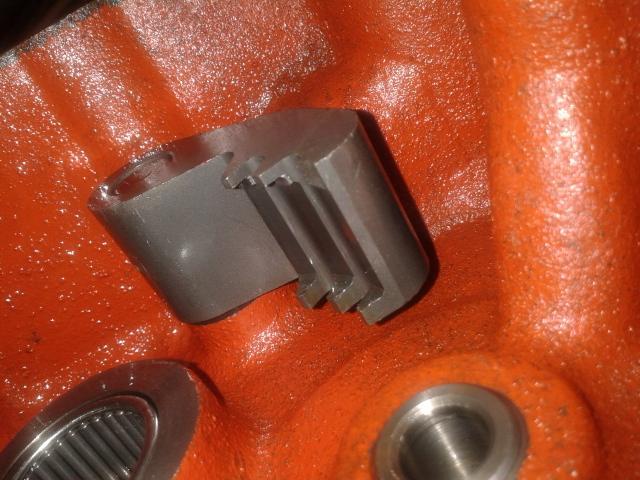

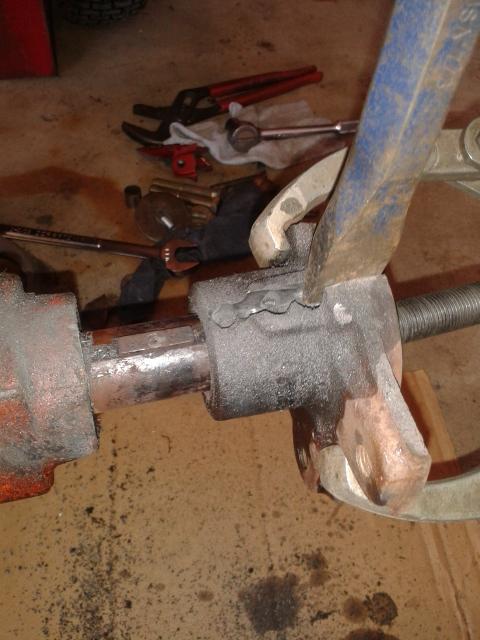

BOB ELLISON 2,983 #11 Posted January 8, 2017 stevasaurus , daveoman1966 and pfrederi THANK YOU for all your help and you all are right on ,I have the 8 pinion differential .But I still have a little jerky motion in reverse and that was why I said I would get into it this Spring. when I first got this tractor it had a bad axle from the PO trying to get the hub off the axle . he beat the snap ring off and I had to replace the axle but while inside I did notice it was very clean. so I just replaced the axle and a 1533 bearing I got from a member here and everything worked good. BUT I did not open the pump. Not knowing then what I know now and I have learned a lot from guys like you and Dave and others about the pumps and how they need to be checked after gear failure .Well the parking pawl was eat up by the gears (I DID GRIND OFF THE TEETH ON THE PAWL ) and this is why the PO probably opened the trans and had a time trying to get the hub off, (By the way I finely had to split that hub to get it off) I was following Dave in a post and this man knows his stuff and he said that one would need to check the piston slippers and plates for scoring and I didn't . So that is why I said I might need to open it up. it just started to jerk a couple weeks ago after plowing snow and then again Saturday. here is a few pics of pinion and pawl 2 Share this post Link to post Share on other sites
