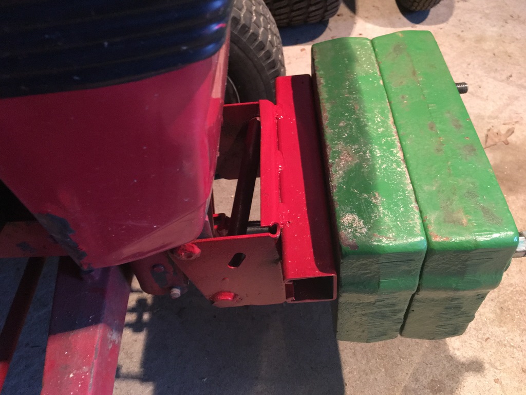

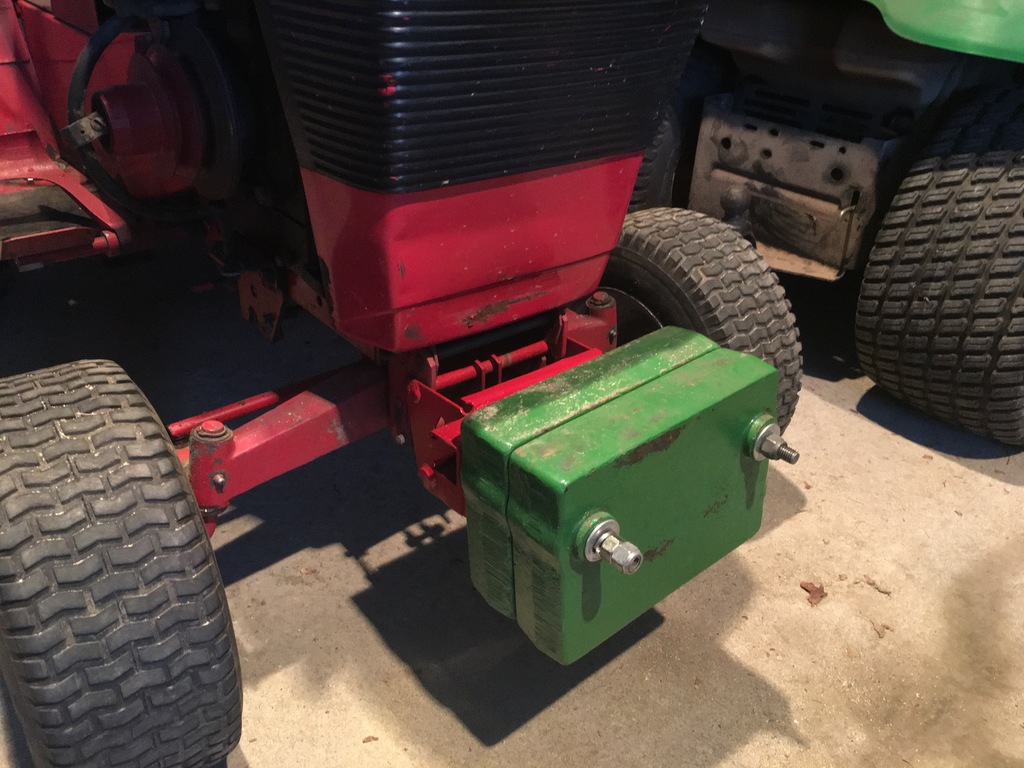

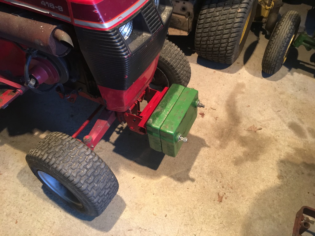

T-Mo-(Moderator) 4,871 #1 Posted January 1, 2017 I have these John Deere weights that were originally for the 108, 111, 112L and 116 John Deere lawn tractors. They were bolted to the back hitch plate on those lawn tractors. They're 42 lbs each. I bought them as they can also be used as front slab weights for the JD round fender tractors as they have the same bolt pattern. I ended up mounting them on the front of my John Deere GX345 when I take it to a plow day. Anyways, I decided they would be good for front weights of a Wheel Horse. So I bought a scrap front tach-a-matic hitch off of ebay and welded a couple of unistruts that I had laying around and mounted it on the front of my 416-8. I have to see if the hitch can hold the 84 lbs, but I think it will. Excuse the green paint, I haven't had time to repaint the weights, and they're probably get painted black anyways to be more universal as they still will be mounted from time to time on the GX. 9 1 Share this post Link to post Share on other sites
AMC RULES 37,259 #2 Posted January 1, 2017 Poor thing... face just looks mad. 3 Share this post Link to post Share on other sites

SylvanLakeWH 31,670 #4 Posted January 1, 2017 Cool Idea. But...Is that what they mean by a severe case of "ganGREEN"?? 4 Share this post Link to post Share on other sites
Hacksawhero123 351 #5 Posted January 1, 2017 (edited) Unistrut is one of those great inventions that once you are familiar with it, you wonder how you got by without it. Great looking bracket T-Mo. Mark Edited January 1, 2017 by Hacksawhero123 3 Share this post Link to post Share on other sites
c-series don 12,076 #6 Posted January 1, 2017 PLEASE paint them soon!!!! 3 Share this post Link to post Share on other sites

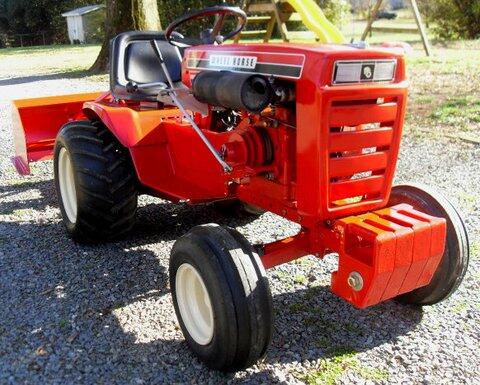

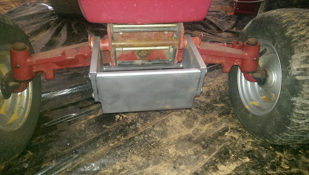

WVHillbilly520H 10,378 #7 Posted January 2, 2017 @T-Mo, I used JD suitcase weights, but built my own bracket/bumper to hang from the the attach-a-matic, different approach same results and 125# hanging off there hasn't hurt anything yet, to counter balance the tiller, plow and weighted box blade,Jeff. 5 Share this post Link to post Share on other sites
fast88pu 3,393 #8 Posted January 2, 2017 15 hours ago, WVHillbilly520H said: @T-Mo, I used JD suitcase weights, but built my own bracket/bumper to hang from the the attach-a-matic, different approach same results and 125# hanging off there hasn't hurt anything yet, to counter balance the tiller, plow and weighted box blade,Jeff. Do you still make these? 1 Share this post Link to post Share on other sites
WVHillbilly520H 10,378 #9 Posted January 2, 2017 27 minutes ago, fast88pu said: Do you still make these? Sorry I don't ,but I do have the blue print here on a couple different threads if you can't find it P.M. me,Jeff... @T-Mo didn't mean to hi-Jack your post I really like your weight/hanger too, I really need to make something like the factory version for the bagger 520... 1 Share this post Link to post Share on other sites

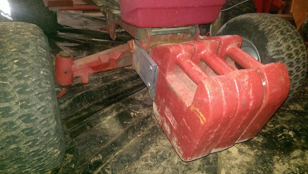

kpinnc 18,724 #16 Posted June 23, 2022 On 6/19/2022 at 9:11 PM, c-series don said: 857lover you do realize that this post is from 5 years ago? Always better than posting the same questions over and over! Found my weights on Ebay years back. About 120lbs. Made a bracket to fit in the mule drive so they can move as needed- though they rarely leave the Bronco... The two outer weights come off for some adjustability. Heckuva lot easier to move to another tractor that way too. 3 Share this post Link to post Share on other sites
