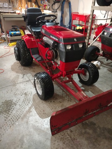

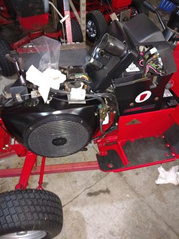

Tried to finish snow plowing. The 520H  died again. This time, new fuel line, filter, carburetor cleaned.  The float floats. The fuel pump pumps gas. To be continued :laughing-rofl:

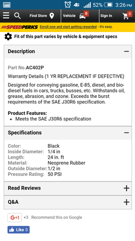

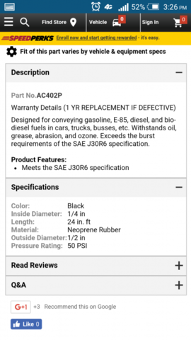

Supposedly the black "rubber" neoprene fuel line from Advance (and other auto parts retailers) I got this spring/summer is now ethanol compatible vs old black rubber hose, Jeff.
