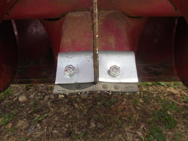

These "wipers" close the gap on the single stage blowers.   I use pieces cut from an old rubber bed liner.  Some use flat belting.
The are put on both edges of the auger and they are custom cut to fit the clearance on your blower.  I back mine up with 1/16" steel.

Ahhh. I see what you're talking about now. Not was I was thinking after all. Thanks for the pic. So there's nothing special to buy, I'm guessing? Just a piece of maybe 1/4" rubber sandwiched under some sheet metal?
