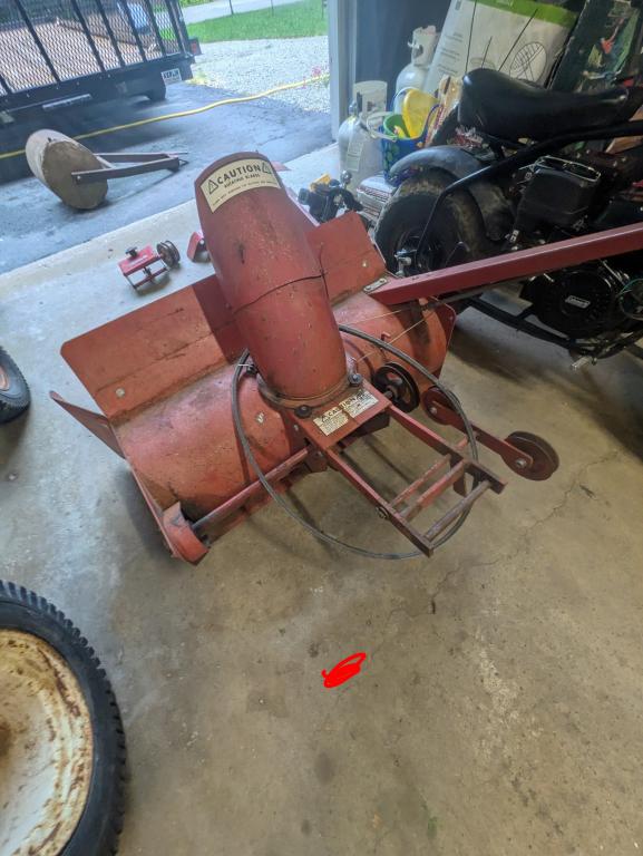

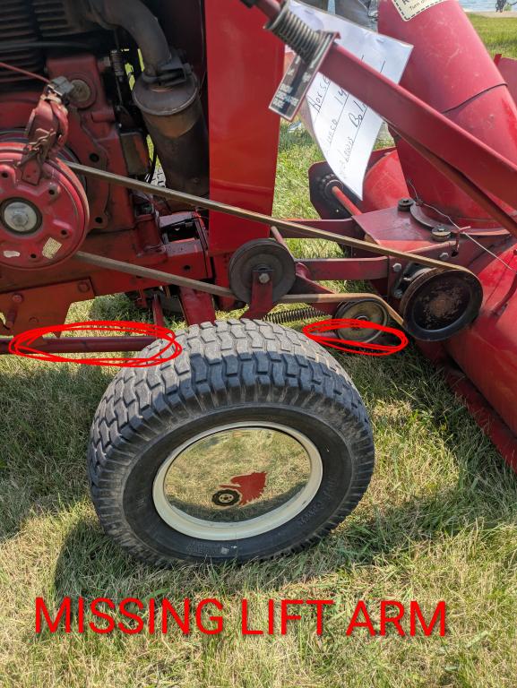

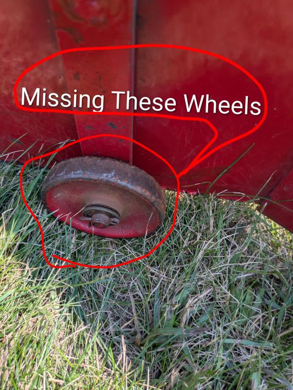

I recently purchased my first wheel horse with a number of new attachments, And included in that bundle was a Wheel Horse snow blower. I would love to use it, But as it seems, Its missing a few key components to use it. Its missing the 2 side caster wheels, Along with the lift rod. does anyone know where i could potentially pick up either of these things?

Heres What my plow looks like.

Ive also heard though that theyre so heavy theres no point getting a lift rod???

You need the lift rod in order to lift it. Do you have the Flag connector which is a separate part from the lift rod?
Yes they're heavy but not that bad if it's connected to the correct hole on the bell crank lever. Lots of people connect them to the wrong hole so that makes the mechanical advantage less than what it should be. Then complain the thing is too heavy to lift. Assist springs can also be added to lighten the load if necessary.

The lift rod (usually made of ¾” ID pipe) with a “flag” fixture links the mid-tractor rock shaft with the blower body. The rod pushes the bottom edge of the blower forward causing it to pivot upward. Normal lift distance (when properly adjusted) is around 3”. Do you have the model # of the blower?

You could start by calling vendors in our classified vendors list, starting with A-to-Z and K&B Horse Parts and placing a “Wanted” ad in the classifieds.

Skid shoes can be made from a piece of angle steel to be used in place of the steel wheels. WH changed to skid shoes on the blowers too
no i don't have the flag or the rod.

Just freshly re-Surfaced our driveway, And i dont want it tearing up the driveway. Can i get like some caster wheels or like some small lawn mower wheels?
FarmallFarmer09
If anyone has one of these 1973 Single stage Snow blowers, Can you see if you could measure the I.D of the wheels, And let me know???
wallfish
The wheels would be harder on the driveway than skid shoes would be. :twocents-02cents:
Those wheels are only about 1/2" wide and skid hard when turning. Skid shoes will always slide right over the top and don't dig in.
off set casters far enough so they can spin around.
You can measure the pin on the blower to get the ID of the wheels
Wheelhorsepartsandmore.com sells lift flags

The shaft pin diameter is 1/2". And as @wallfish stated, those cast iron wheels DO scoot sideways as you turn. They are held on with a shallow groove snap ring; I had one wheel fly off 2 years ago. No more snap rings - cross drilled the shaft for a cotter pin & flat washer...

22 hours ago, wallfish said:
You can measure the pin on the blower to get the ID of the wheels.
Of course, Duh. Shouldve thought of that 😂
FarmallFarmer09
Dang what was i thinking 🤔? So ill find a way to make some sort of thing. Thanks.
