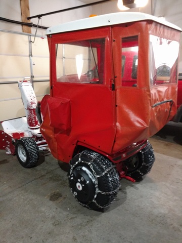

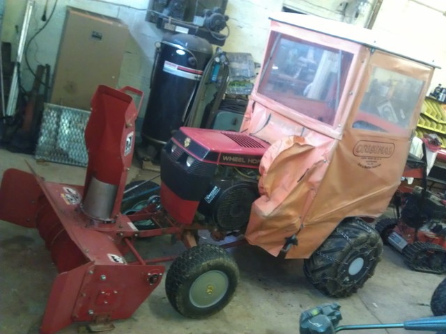

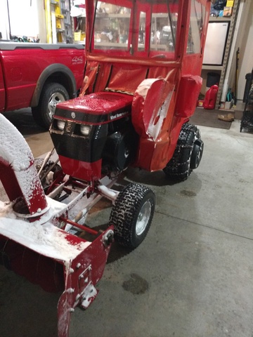

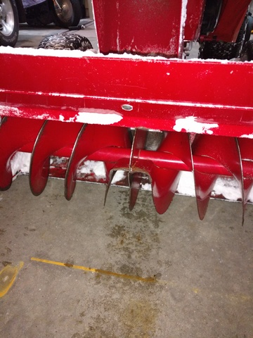

608KEB 812 #1 Posted December 17, 2016 After running the snowthrower this morning. I decided I need to install rubber paddles on the auger. The snowthrower doesn't throw it very far. Where can I find the rubber pads or a piece of thick rubber. Farm n Fleet? Of course I have to throw a pic of the (ultimate snow machine) in. That's what my son calls it. 1 Share this post Link to post Share on other sites

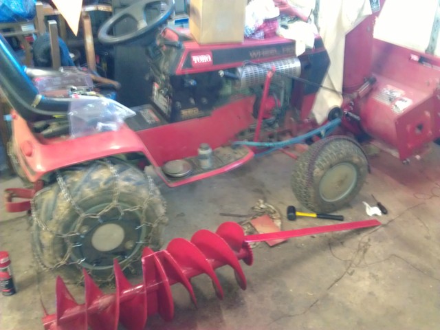

WVHillbilly520H 10,378 #2 Posted December 17, 2016 IDK what "very far" means, but 30' to the side is really good and it also has to do with the snow type and how you keep the blower loaded with ground speed and always run WOT, also the top deflector setting makes a difference with throwing distance, and solid stone guard really helped on my single stage the rubber paddles are really for the 2stage impeller fan to drum, but I think @Ed Kennell did an auger paddle extension on his single stage, but my single did almost as good as (my 2stage 2cd pic) in throwing distance,Jeff. 7 Share this post Link to post Share on other sites

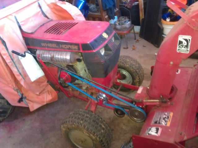

WVHillbilly520H 10,378 #13 Posted December 19, 2016 This is the correct belt routing, and even before I rebuilt this single stage 2 years ago it would throw (depending on snow type) 15' no problem every time (unless very wet or plow banks) to 30' plus it really is the 2stage without the impeller fan to blow it up and out the chute, but because I used it on 1/4 mile long dirt/gravel driveway for years the auger is chewed up and the main auger drive sprocket was shot along with the idlers, I cut the welds and machined another sprocket to fit on the auger and welded it back (they "Toro" say it's not replaceable without buying a new auger) but with that being done all new bearings ,chain ,sprockets and the solid stone deflector it's consistently a 20' + thrower now, so double check ALL of your sprockets and chain tension, that could be where the problem lies,Jeff. 1 Share this post Link to post Share on other sites

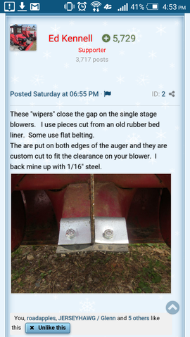

WVHillbilly520H 10,378 #14 Posted December 19, 2016 On 12/18/2016 at 7:37 AM, 608KEB said: O.k. so bottom line. Putting some rubber paddles on a single stage snowthrower isn't going to help? @Ed Kennell ,did it to his single stage... Share this post Link to post Share on other sites

608KEB 812 #16 Posted December 20, 2016 Thanks, I'll put something like that on and report back. Share this post Link to post Share on other sites

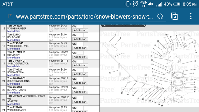

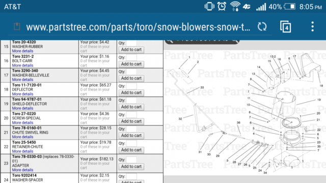

WVHillbilly520H 10,378 #18 Posted December 21, 2016 Here's the solid stone deflector...#19 Share this post Link to post Share on other sites
