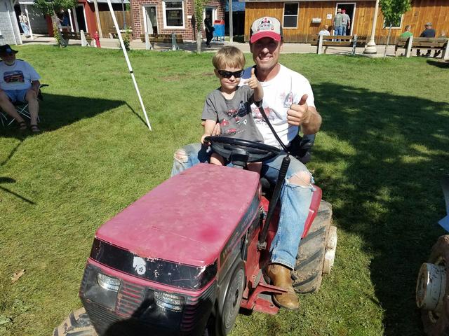

I ditto Dan's statements about the GT's.  I brought GhostRider (my 1994 WH 314-8 plow tractor) last year without incident.  Obviously everything around there is geared for the older tractors but the GT's are an exception.  That being said, bringing your older functioning examples would be a good call for that show given the focus on all things old.  However, I hate to say it but the early 80's was over 35 years ago! As a matter of fact a 1997 vehicle this January would fit the official 20 year old antique category for plates! :wacko:
Dan--what does that make you?:ychain:
GhostRider at Symco last year before its new "clothes"...

Well, your first chance at success is to have a tractor for him, either one currently in your herd or pick up one specifically for him.  That is my youngest Zach on my lap. He is 3 and has a 1970 GT-14 that he named Blackbeard. He is a tractor guy through and through:icecream:.  Every time he hears me start up his tractor, he runs out to "drive" it.  They love that sense of ownership.  I'm hoping to bring Blackbeard up to Symco this next year to display and to drive Zach around.  I hope we can meet you and your family there.

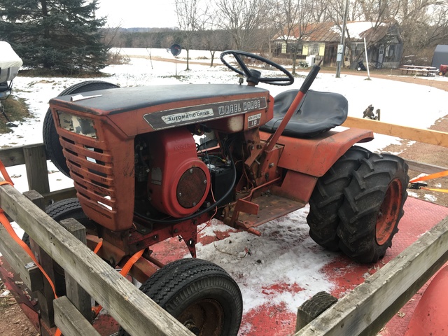

 It looks like the 8HP engine has no starter solenoid. It would not be a bad idea to spray the switch with some penetrating oil and clean the contacts because all that power is going through the switch to start the tractor. It also appears that the spark coil is living beneath the flywheel. If yours gives you trouble, parts are unobtanium---but you can convert it to the standard 'beer can ' coil ignition system as your tractor has points.  Been there done that on an electro 12

One more thing I need to ask.  Is this Charger 10 a 1969 or a 1972 model?
WHX??
Get us pic of that tag below the dash & try and get that service sticker right below it...just curious as to where horses might have come from in our area.
  • Like 1
pfrederi
If the Kohler is original engine it is a 1972.  1969 Chargers 10s had Techys
  • Like 1
Deadguy
That is not the original engine.  Some time in the past somebody replaced the original with a 8hp Kohler.  If the original was a Tecomesapart, that would explain it!
