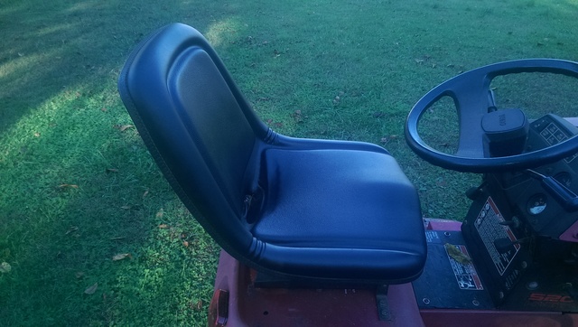

entropy 104 #26 Posted December 6, 2016 I like seat #2 as well. How much does that one cost? 1 Share this post Link to post Share on other sites
WVHillbilly520H 10,377 #27 Posted December 6, 2016 2 hours ago, entropy said: I like seat #2 as well. How much does that one cost? On sale at Northern Tool for $79+S/H normally $99+... Share this post Link to post Share on other sites

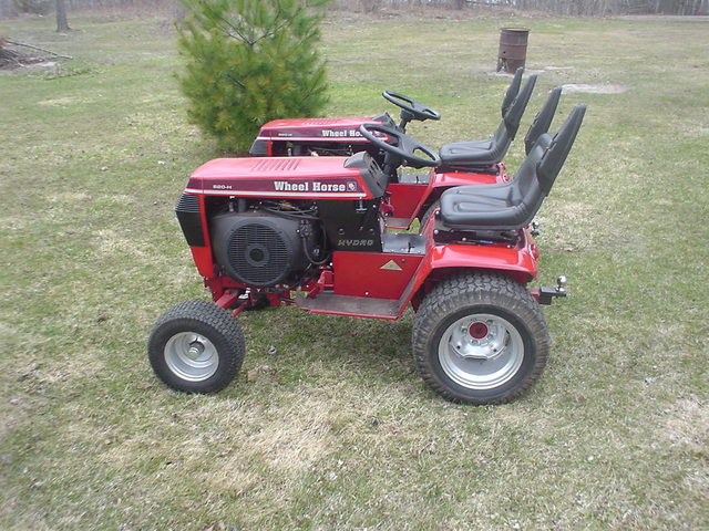

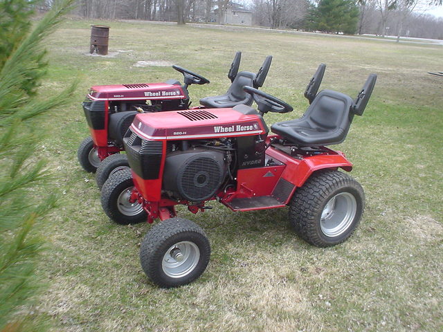

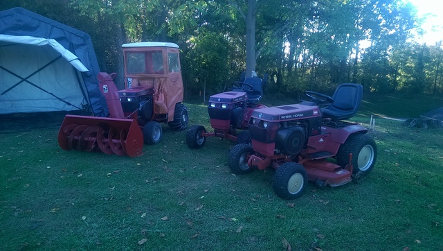

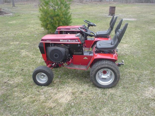

cleat 8,626 #28 Posted December 6, 2016 I also use seats like #2 with arm rests. These pics show 2 but I have the identical setup on all 4 of my 520's. Arm rests are nice but pricey, they cost about the same as the seat itself. Cleat 2 Share this post Link to post Share on other sites
entropy 104 #29 Posted December 6, 2016 Nice looking horses Cleat! It seems quite a few people want a nice 520 and you have 4 ??!! It seems the price you quoted is a good deal, but I am a cheap SOB and $79 gets my cheap-o-meter all a flutter, I am at bottom right. But my seat is absolute garbage on the 518!! Share this post Link to post Share on other sites

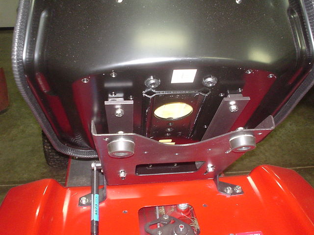

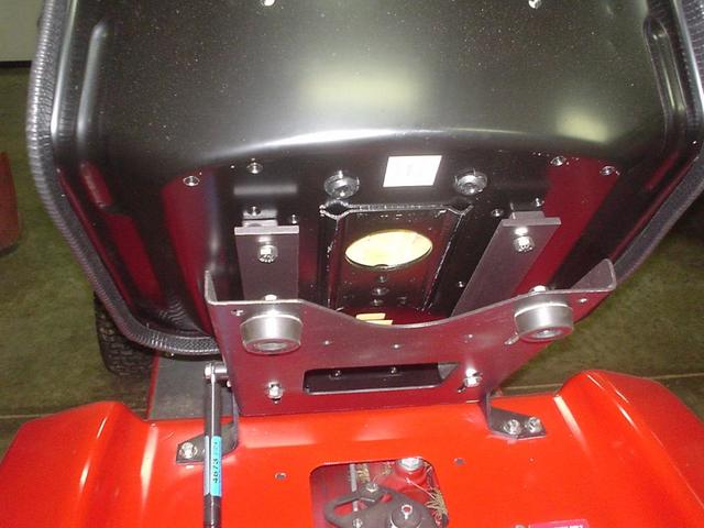

cleat 8,626 #30 Posted December 6, 2016 I paid $79.99 US for the Black Talon seats armrests on ebay no tax. The seats I got from TSC for $79.99 Canadian + tax (13%) These are not a direct bolt-on and I made up adapter plates. Here are the plans. Wheel Horse seat adapters.pdf You can just see the spacers here between the seat and spring. Even though these seats have a lot of different mounting holes, they do not have the proper ones for the 520. Cleat 1 Share this post Link to post Share on other sites
ACman 7,685 #31 Posted December 6, 2016 Seat #2 isn't on sale anymore and is $99.99+ shipping . Should have just ordered it when @WVHillbilly520H showed the add that would have sucked up the shipping costs . Seat #1 is still on sale at $10 off for 97.99+shipping . Even though my butt will never set in this seat , I want the right look . @cleat impressive collection you have there , hope mine turns out as nice as yours . Share this post Link to post Share on other sites
WVHillbilly520H 10,377 #32 Posted December 6, 2016 (edited) Cleat those seats are more of a CUB CADET Quiet Line design and a shorter back rest than the original '96 newer520/xi or Michigan V-818 seats, but as long as you're happy with them is all that matters, my '97 seat from day 1 was always slick to set in compared to the V-818 I got this summer, and the '95 520 with bagger I bought late this summer has the original seat which is slick and uncomfortable and has arm rests they look cool, but to me somewhat of a hassle every time I have to empty those bags just my ,Jeff. Edited December 6, 2016 by WVHillbilly520H 3 Share this post Link to post Share on other sites
ACman 7,685 #33 Posted January 10, 2017 (edited) And the winner is #2 but it is not a direct bolt on as stated in the first post . Neither of the Michigan seats are . Edited January 10, 2017 by ACman Share this post Link to post Share on other sites

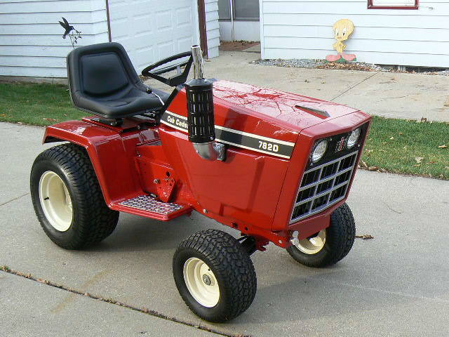

c-series don 11,110 #34 Posted January 10, 2017 Ok I probably shouldn't admit this in public but that is one beautiful Cub Cadet ! Since I'm confessing I kinda secretly want one of those but do not tell anyone 😬 2 1 Share this post Link to post Share on other sites

JCM 10,562 #36 Posted May 31, 2025 On 1/10/2017 at 6:22 PM, c-series don said: Ok I probably shouldn't admit this in public but that is one beautiful Cub Cadet ! Since I'm confessing I kinda secretly want one of those but do not tell anyone 😬 That IS a very nice Cub Cadet and it 's RED. Wheel color is You do have good taste Don. 1 Share this post Link to post Share on other sites
