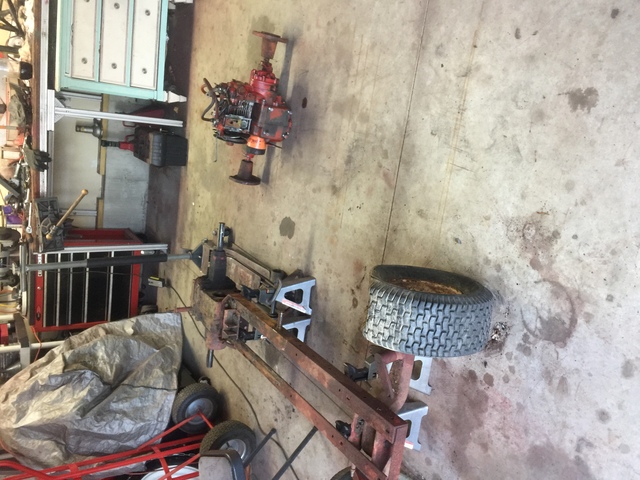

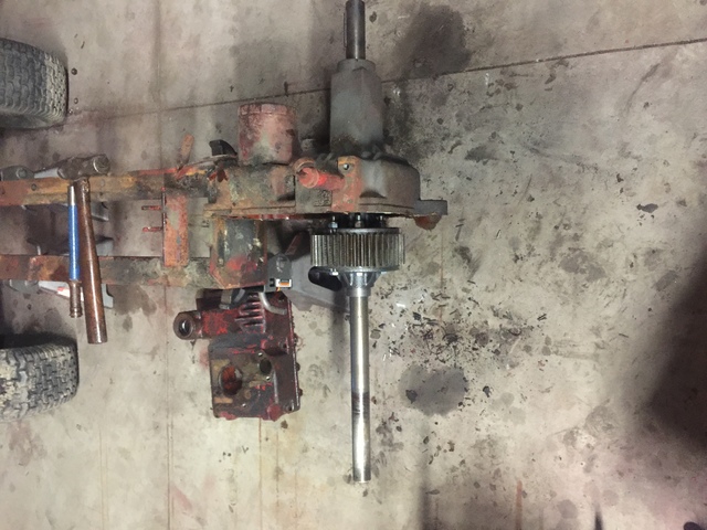

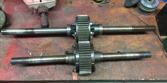

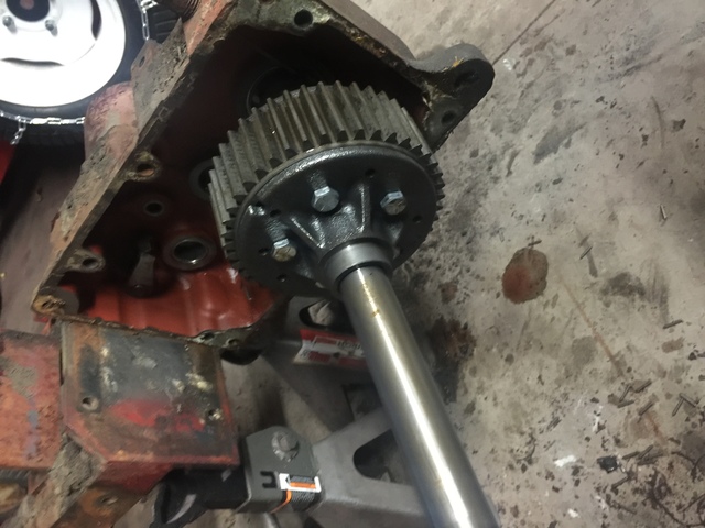

Aldon 4,834 #3 Posted November 20, 2016 (edited) The fact that you have searched and not found a thread with step by step pointers may mean you have opportunity to forge and document for posterity. It has been done but I also have not seen it documented well. @fast88pu has a GT14 that was similarly partially modified by the previous owner. He may be able to post pics in spring. Likely be in winter storage until then. If you don't use longer axles, then the axles will stop short of the end of the Hubs about an inch and a half. I assume this might make the rear a bit weak. Or your rear end will be much narrower. Either or. By plate for top, I assume you mean to adapt it for the fender and seat pan etc. Not sure anyone is going to be able to provide you a template. It will have to be figured out as you go. As @ztnoo mentioned I too am just getting started on this same conversion. I have a donor 1&1/8 axle 8 speed parted out and 2 hydro's similarly parted out. Been getting some coaching from @stevasaurus and will post a thread if I get to a significant milestone before you do. I have all new bearings, seals and gaskets and hope to get this put together over the holidays and try and get it installed in spring. My plan is to install with D series hubs and rims, also sourced to install 26x12-12 ags. Good luck on your conversion and if you get yours done first, post a how to thread for the next fella who like yourself is looking for tips and pointers. a couple of pics cuz the readers demand them LOL The tear down of hydrobl 1 and the second waiting anxiously for the same surgery. And the 8 inch did as well as limited slip Hydro diff. Note difference in width. Edited November 20, 2016 by Aldon 2 Share this post Link to post Share on other sites

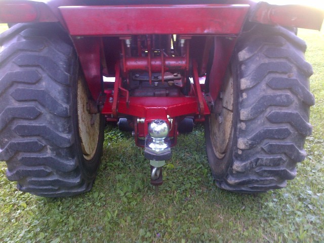

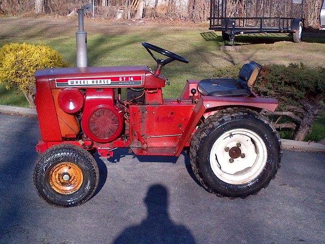

scotty 252 #4 Posted November 20, 2016 (edited) I was the one that did the conversion for the GT-14 that i sold to fast88pu. I used an 8 speed i believe it was from a c 175. The axles were a little short though. Didnt seem to effect anything when i owned it. It also has the inside rear weights.I did use the original GT-14 hubs too. If i remember right i used a piece of flat steel for the top transmission mounts.It was very solid. I did not get around to adding any kind of lift to it before i sold it though. Now i see this post it makes me want to make another one. Edited November 20, 2016 by scotty 3 Share this post Link to post Share on other sites

scotty 252 #15 Posted November 21, 2016 The only thing that i remember standed out about the clutch was having to make the clutch rod out of threaded rod that i bent with a torch. There was a few parts that were a pain to do on the conversion but everything worked out. Share this post Link to post Share on other sites
