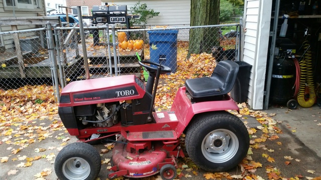

R.J. 4 #1 Posted October 28, 2016 Hello first time user . I have a toro wheel horse 244-H that i inherited so to say, I know nothing about its history. It has a 14 hp motor that i got running and it runs great but when i try to put in drive or reverse it bogs engine and will eventually die if not returned to neutral. It will also bog and die if i engage the mower deck. Looking for some help here as this looks to be a decent mower thanks in advance for any help . Share this post Link to post Share on other sites

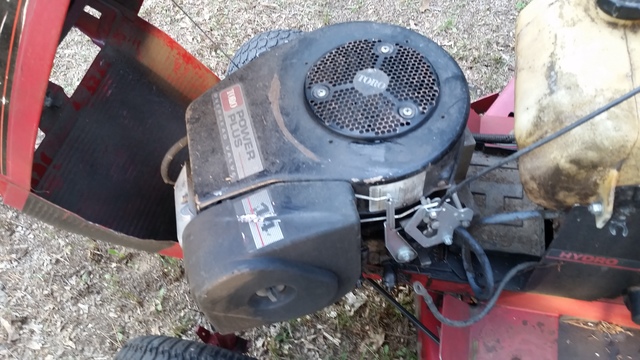

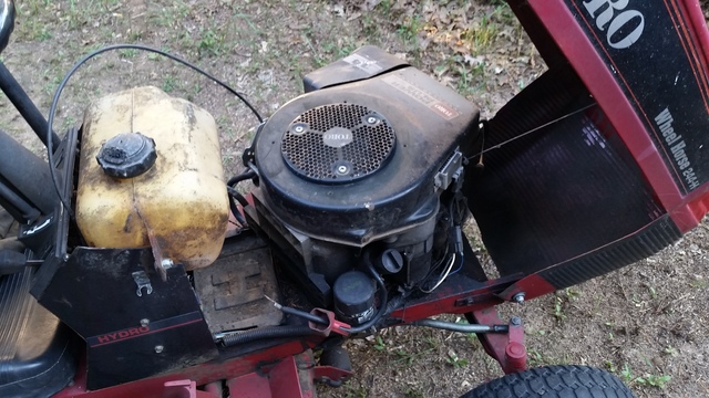

WHX?? 58,083 #15 Posted October 31, 2016 (edited) You can probably get those switches from Toro yet but they might be pricey. They are a pretty common micro switch I believe so should be all over Amazon or 'bay cheaper. Get the Toro P/N out of the IPL & try googling it. I have a 244 parts tractor I can let you have if they are still on it & good yet. @gwest_ca did a 244 have an Onan in it ? I could have swore my parts machine has a Briggs?? BTY RJ Edited October 31, 2016 by WHX8 1 Share this post Link to post Share on other sites
oldredrider 2,553 #16 Posted October 31, 2016 The 244 came with an Onan. While I don't recommend bypassing safety switches, none of mine have them! Like whx8 said, check with Toro for pricing. Or, do as you described (bypass and toggle switch). 1 Share this post Link to post Share on other sites
WHX?? 58,083 #17 Posted October 31, 2016 (edited) I recued it from a scrap yard because it has a lot of parts for my beloved 246 Edited October 31, 2016 by WHX8 Share this post Link to post Share on other sites
R.J. 4 #18 Posted October 31, 2016 WHX8 wish we wasnt so far apart lol . the oem pto switch is 59.99 and im just not willing to pay that for a switch and the neutral safety switch looks very much like a hvac sail switch for a inducer motor so i could make something work there . mine has 14hp onan motor Share this post Link to post Share on other sites
WHX?? 58,083 #19 Posted November 1, 2016 (edited) Yes by golly they are an onan @oldredrider......you must be a fellow 200 series fan! Wonder why a PO might have cocked the motor in it like that or is that's how it's supposed to sit? Kinda thought OEM might be a bit proud of theirs..... Check aftermarket RJ and if that don't pan out I'll see if mine are any good and you can have them for a beer & shipping if you like. Edited November 1, 2016 by WHX8 spell 1 Share this post Link to post Share on other sites
R.J. 4 #20 Posted November 1, 2016 not sure why on yours i know mine is not as cocked as that lol...and i was looking at aftermarket pto switches and there in the range of 10-30 dollars thats a little easier to swallow 1 Share this post Link to post Share on other sites
