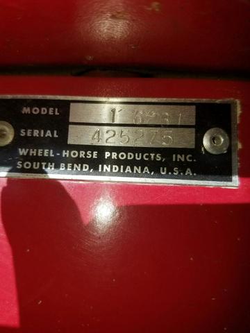

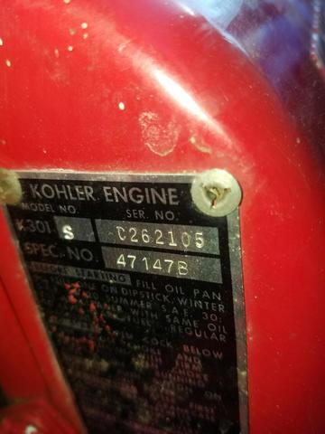

WHX?? 57,601 #27 Posted October 17, 2016 He just sent me a pic of the tags, here they are ...can't seem to find one off the deck but guessing it's 426 SD 2 Share this post Link to post Share on other sites
Rp.wh 1,104 #28 Posted October 17, 2016 (edited) I just sent them to jim let me know what you find it was told it is a 1968. Edited October 17, 2016 by Rp.wh 1 Share this post Link to post Share on other sites
WHX?? 57,601 #29 Posted October 17, 2016 (edited) Plans are Ryan is to borrow the fuel pump on the K241 10HP on the shelf and see if that's the issue. If is it there are resources in vendors on where to get a kit. Check the belts right away to see what kind of shape they are in, Will let you know about the battery size tonite, I just got one for the 1257 at FF. I think we are gonna run 10w30 in the motor per the Kohler manual for winter duty. Edited October 17, 2016 by WHX8 1 Share this post Link to post Share on other sites

stevasaurus 23,769 #35 Posted October 17, 2016 You might be right about the late 1968 model Jim. The 1968 Raider 12 model 1-6231 (according to the sheet) should have the Kohler K301S with Spec #4712B. I think the engine in Ryan's is original with the Spec #47147B. This engine came on the 1968 Electro 12. It could be they ran out or the #4712B's and had the #47147B instead. Maybe it was ordered that way. If you look at the Transmission Usage sheet, they also made a 1968 Raider 12 Model #1-6241. This is the sister that was made in Belgium and it came with the Kohler K301S Spec #47147C. Just thought I would throw out some issues to chew on before somebody else spotted it. Not sure what it all means, but you just gotta love Wheel Horse. Maybe @gwest_ca might have some ideas on all of this. 1 Share this post Link to post Share on other sites
gwest_ca-(File Mod) 12,410 #36 Posted October 17, 2016 Notice a Charger 12 and it's serial has been added to this list of late production Raider 12 serials that used the 47147b spec number. Just an effort to determine when the change in engines was made. Further down one shows up with a starter/generator but maybe it was repowered. This service bulletin dated March 1968 lists both spec numbers Garry 3 Share this post Link to post Share on other sites
WHX?? 57,601 #37 Posted October 17, 2016 42 minutes ago, gwest_ca said: Further down one shows up with a starter/generator but maybe it was repowered Interesting Garry @gwest_ca Are you adding those footnotes on the download page as you see what's reported? Who would figure that a higher S/N would turn up with a start/gen. Yes a dealer warranty repower possibly? One wouldn't think they would switch back to S/G motors on an assembly line for a short duration on later S/N's to use up leftovers?? Note that on that service note #93 it's dated March 1968 so that must mean they went to Bendix motors early in the year? I thought it was the last 1/4 of '68?? 1 Share this post Link to post Share on other sites
