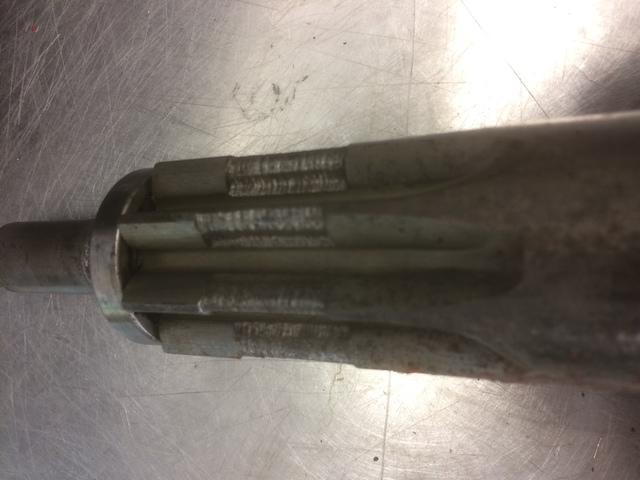

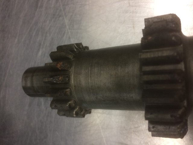

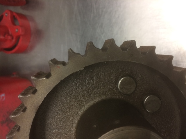

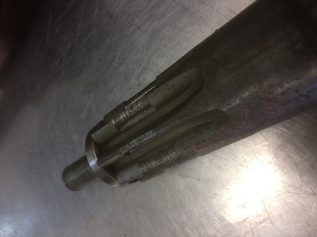

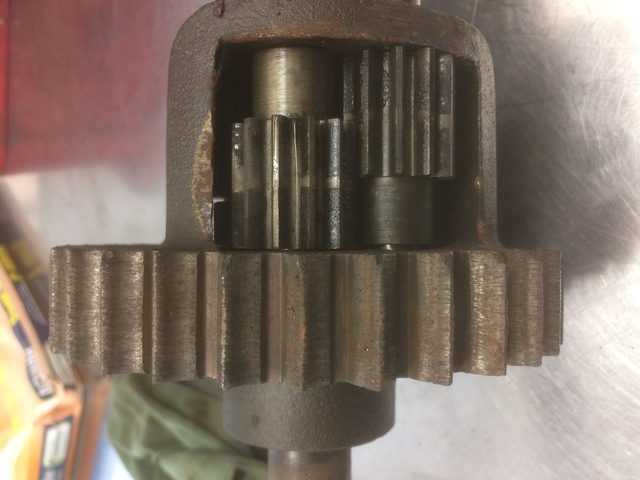

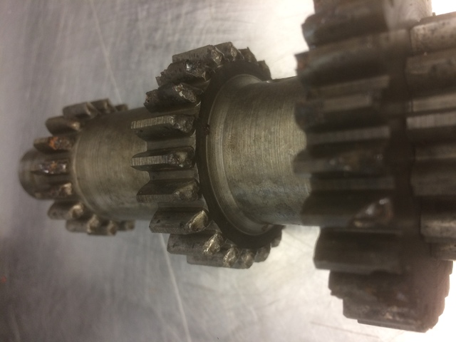

Skeeters65 45 #17 Posted September 26, 2016 Wow posting pictures here is easier than any other forum I'm on. Here are the affected gears. Let me know now if you guys think I should replace them and if so anyone have good ones? Thanks 1 Share this post Link to post Share on other sites
stevasaurus 23,619 #18 Posted September 26, 2016 Your cluster gear is bad...replace that. If you are just going to ride this around the yard and at shows, your mushroom gear and differential are passable. If you can find a differential and compatible mushroom gear, I would replace them. The spider gears (from the picture) are good from what I can see. I have a cluster gear if @Racinbob and/or @Jake Kuhn do not want to break up a trans. I do not have a differential or a mushroom gear. BTW...you can knock that race off the top of the mushroom gear. 1 Share this post Link to post Share on other sites
Skeeters65 45 #19 Posted September 26, 2016 Do the differential and mushroom gear need to be matching from the same transmission? What negative effects will I have from keeping the mushroom and diff gear? Share this post Link to post Share on other sites
Racinbob 12,799 #20 Posted September 26, 2016 How do your axles look? Remember that you can flip them around just by drilling a new hole for the roll pin. I should have everything you need but let me verify tomorrow. I don't remember the diameter of the gears off the top of my head. I may be able to use a large flat rate box. Stay tuned. Share this post Link to post Share on other sites
Racinbob 12,799 #21 Posted September 26, 2016 I agree with Steve on the mushroom gear and differential but I would replace them if possible. They aren't going to get any better and will cause more wear on the opposing gears. 1 Share this post Link to post Share on other sites
stevasaurus 23,619 #22 Posted September 26, 2016 Those 2 things will be the hard things to replace. The mushroom and the differential. Skeeter, it is the teeth on those 2 gears that have to match up...they made 2 different kinds. You can replace the differential only...or the mushroom gear only...as long as they are a match. Your mushroom gear is a 11/44 toothed gear...11 on the top and 44 on the bottom. I would have to go back through some of my post about this to tell you how many teeth you need on the differential...but you could count yours...that is what you need. To answer your question about the negative effects...it is about the slop you will have in the gears. Going forward should be OK, but you may notice the slop when you are going forward and then stop and go into reverse. Those gears will have some space between the teeth, and as long as you are just riding around...will be OK...I don't think those gears would last long moving snow with a blade. That is what I mean. 1 Share this post Link to post Share on other sites

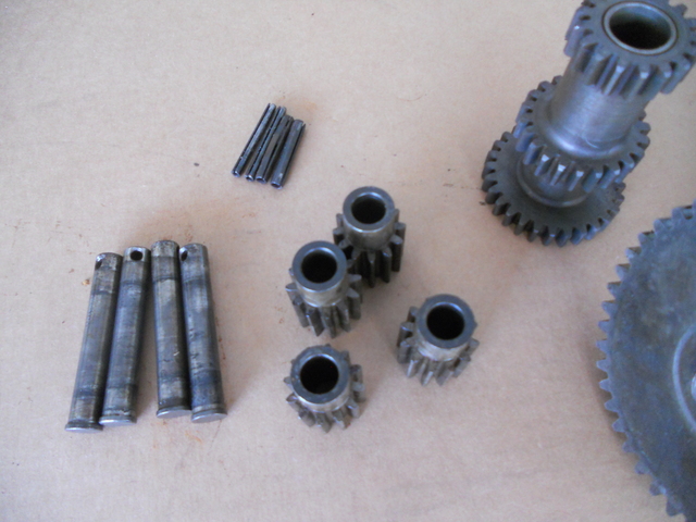

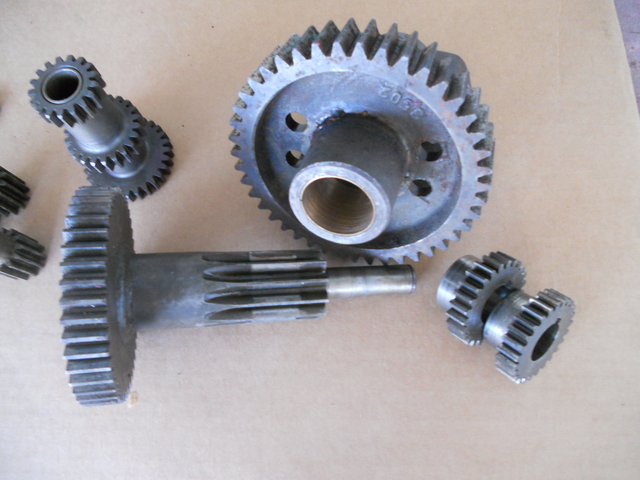

Racinbob 12,799 #23 Posted September 27, 2016 Here's what I have that would hep you out Skeeter. I also have a pair of axles that are pretty nice and could be used as is but if I were doing the transmission I would flip them. I suspect that your axles would be fine too. 2 Share this post Link to post Share on other sites

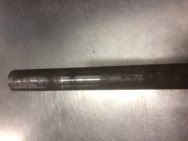

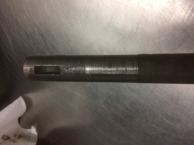

Skeeters65 45 #24 Posted September 27, 2016 Rob, THose look much better than mine. I will send you a PM. My outter axle shafts. 2 Share this post Link to post Share on other sites

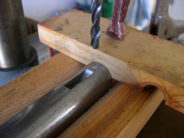

Racinbob 12,799 #25 Posted September 27, 2016 Kevin, as far as your axles go I'm sure there's some grooves where the bushing rides. Make a simple jig by cutting a V notch in a 2x4. Set it up in a drill press and use a small (1/8" or less) to make sure it's exactly centered. Clamp it in place and drill away. It's not hardened and drills easy. By flipping the axles you end up with the worn spot in the middle of nowhere and essentially you have a new axle. The axles I have may be a tad better but I would do the flip and drill thing to them as well. 1 Share this post Link to post Share on other sites
