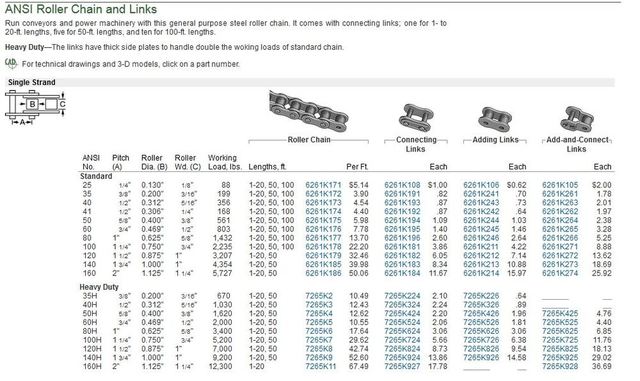

Cadmandu 67 #29 Posted September 9, 2016 Wallfish, and my German friend, thanks for all the great answers. 1) 50 lbs each side? 2) Do u need a special tire to fill with a liquid, what liquid and how? 3) Will I damage my asphalt drive way with chains and a blade? 4) What r roller chains Hossenfeffa: 1) I like the looks of the K301 so I will stick with the 85/86 312-8 still looking for one.How far back did the go? 2) Did the older carbs actually have adjustable needle jets like Kehin Carbs on my Honda Magna? 3) If you remove the vacuum fuel pump where do you mount the electric pump? Where do you get one? Any 12 vdc fuel pump do? 4) That splash lube design seems dangerous on hills. I have a steep back yard is it better to go up or across? Thanks guys great info hear. Share this post Link to post Share on other sites
pfrederi 21,295 #30 Posted September 9, 2016 At least 50lbs per side You can fill the tire with RV antifreeze (the pink stuff) windshield washer fluid, rim guard (aka beet juice..hard to find) You could add calcium chloride to water and use that like farmers did for years but i would no recommend it as it is highly corrosive . No special tire required Chains will mess up your asphalt if you spin the wheels. if you have a steep driveway use ag tires and only plan on plowing downhill. There are rubber chains available. #40 roller chain (looks like bicycle chain) Electric pumps push better than they pull so mount it near the tank . Pick one with 4psi or less. Share this post Link to post Share on other sites

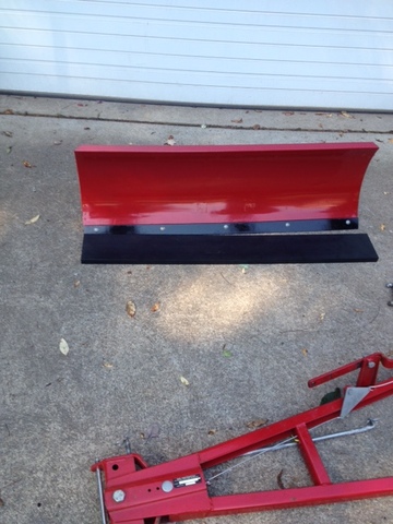

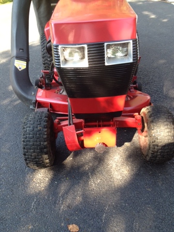

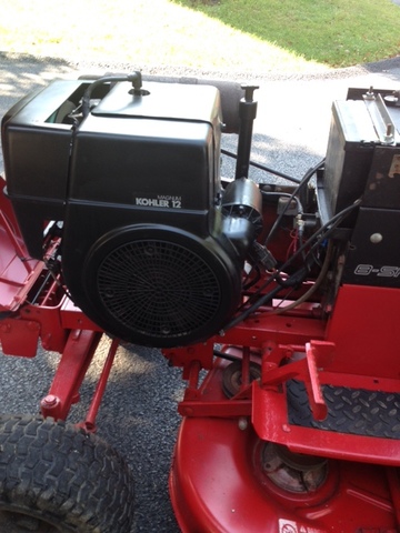

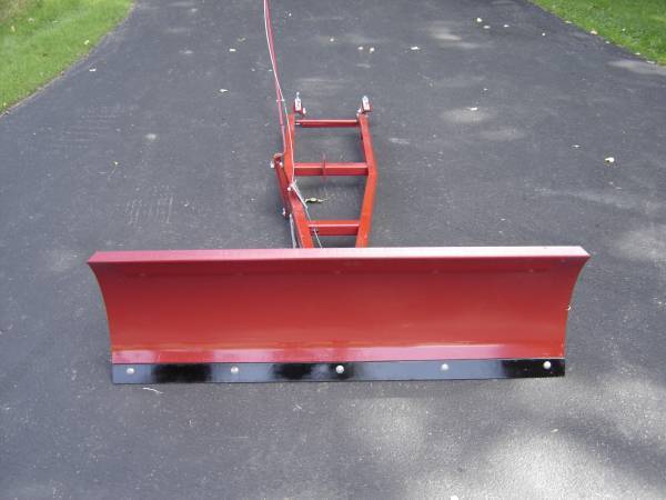

Cadmandu 67 #45 Posted September 10, 2016 Look what I bought today. 1988 312-8 Wheel Horse Garden Tractor $850.00 9/10/2016 Serial # 41953 Vin # 21-12K806 37” Mower Deck C side Ser # 11805 Model # 0537SC01 11 cu ft SOIC Bagger Ser# 61877 Model # 0711BC01 Magnum M12S Spec # 471527 Model # 471527 Serial # 1911409203 48” Snow Blade and rubber scraper $250.00 The blade will be here today and the tractor the middle of next week. Under 600 hrs on the meter. I am excited and he gave me a 48" chunk of rubber 1" thick and 4" wide for the blade. The blade is in the above pic. The link is up a few under is this a good buy. Runs strong, starts easy shift great Share this post Link to post Share on other sites
Ed Kennell 47,809 #46 Posted September 10, 2016 Looks good. Are those head light bezels chrome? Share this post Link to post Share on other sites
Cadmandu 67 #47 Posted September 10, 2016 Not sure, and it is not here to check. By the way it is a 1989 21-12k806. It is almost leaf season this bagger will be great I have 6 weeks of leaf blowing and tarping 3 hrs each week. Now I can ride and smile. Here is my rubber for the blade. Share this post Link to post Share on other sites

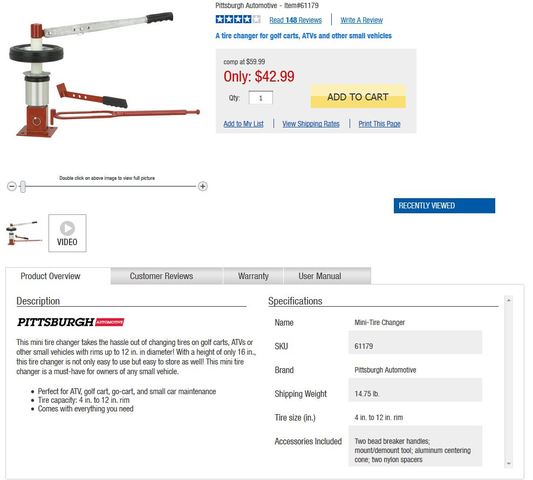

pfrederi 21,295 #50 Posted September 11, 2016 (edited) Rubber chains will work best on turfs Mounting...yu can take then to a tire place but by the time they demount the old and put on the new you will be at probably $10/tire. I bought one of these Harbor freight devices years ago and have used it many, many times. Not the best made tool in the world and I have bent some of it but it still gets the job done. (They have frequent coupon deals could be cheaper.) Edited September 11, 2016 by pfrederi 1 Share this post Link to post Share on other sites
