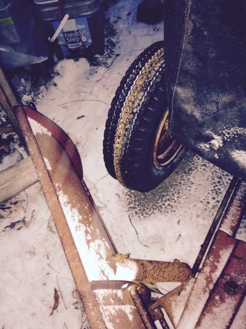

wallfish 20,238 #4 Posted January 23, 2016 #40 roller chain wrapped around the front tires. 2 Share this post Link to post Share on other sites
