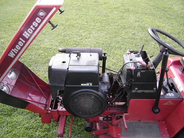

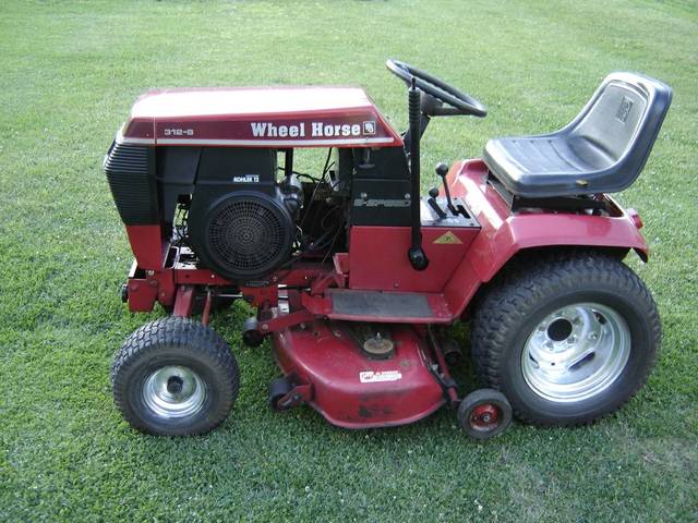

Cadmandu 67 #1 Posted September 5, 2016 Hi All, I am looking at my first Wheel Horse today. It has a Magnum 12 Kohler engine. He thinks it is a 1985 but the 85 and 86 should have a K301. So either it is a 87 or newer or an engine swap. My question is the K301 a better engine than the M12? Thanks 1 Share this post Link to post Share on other sites
JAinVA 4,638 #2 Posted September 5, 2016 The basic structure of the K series is same as the M series.If there is any advantage of the M over the K it would have to be the solid state ignition on the M.I have and have worked on both series and think either should serve you well.JMHO,JAinVA 1 Share this post Link to post Share on other sites
wallfish 20,057 #3 Posted September 5, 2016 (edited) Basically the same engine with different ignition systems. Edited September 5, 2016 by wallfish 1 Share this post Link to post Share on other sites
Hossenfeffa 49 #4 Posted September 5, 2016 Looks just like my '86 312-8, so it probably a transplanted m-12. If the serial numbers are still readable, you can check that way. Nothing wrong with the M series engines, but if the electronic ignition fails,(which is not often) it can be pricey to repair Share this post Link to post Share on other sites
Ed Kennell 46,247 #5 Posted September 5, 2016 My experience has been they both run well, but the Ms require more cranking to start. Not sure, but this slow starting may be due to fuel drain back to the lower under the seat fuel tank location with the M powered tractors. . 2 Share this post Link to post Share on other sites
Wheel-N-It 2,978 #6 Posted September 5, 2016 The Magnums are great powerplants that's for sure. ....... BUT, there is something the K's have in terms of easier starting and overall power that I don't experience with the Magnums. Its probably just me. The next member here could honestly say the exact opposite and I would not take issue with that. So should you buy the 312? If it runs well, drives well, and there is no problem with the transmission, then yes unless it's severely overpriced. 1 Share this post Link to post Share on other sites
wallfish 20,057 #7 Posted September 5, 2016 The slower start issue might have more to do with the carburetor than the engine itself. I think most of the Magnums came with a fixed jet carb and have bigger or more holes in the choke plate too. As a test, remove the air cleaner and choke it with your palm while starting and see if it starts much quicker than using the usual choke. Easier done with 2 people.. 2 Share this post Link to post Share on other sites
clueless 3,406 #8 Posted September 5, 2016 Looks like my 87 312-8, the mag seems to work just fine. Share this post Link to post Share on other sites
Wheel-N-It 2,978 #9 Posted September 5, 2016 That one has the dash warning lights, look behind the positive post on the battery. So that alone tells me this 312 came with the Magnum originally. 3 Share this post Link to post Share on other sites
jdleach 525 #10 Posted September 5, 2016 Definitely not an '85. 1985 312-8 models did not offer the soft-grip steering wheel, or tail lights. The tags on the tunnel cover where the shift levers are, and the front of the fender pan below the seat are both newer styles. The '85 models also did not have the "V" support for the grille. I would check the serial number, but I suspect the tractor is pretty much original, and most likely an '87. Battery is also wrong for the machine. Should be right-hand positive post. Battery is in backwards, and is a right-hand negative post type. The right-hand positive is harder to find, at least around these parts. As far as durability, never heard anything wrong about the M-Series. Personally, I don't like the squared-off covers. I also don't mind changing points on the K301, and the multiple adjustments on the carb. are also fine with me. Note too, that the belt cover on the deck is missing. About any model of 312-8 is a damned fine tractor. I spent around 4 hours on my '85 yesterday mowing waist high weeds at my rural property. Tractor has never been overhauled as far as I can tell, and is 31 years old. Never missed a beat, and did a beautiful job. Had to spend 15 minutes blowing the weeds and dust off with compressed air after I was done, and then give it a bath once I got home. The only thing worn out at the end of the day, was me. EVERYTHING ached when I got up this morning. 4 Share this post Link to post Share on other sites

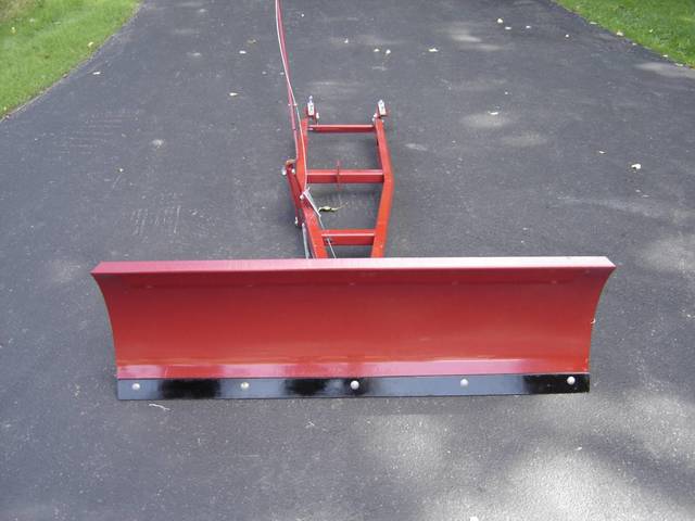

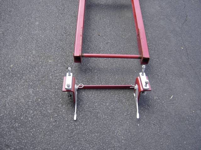

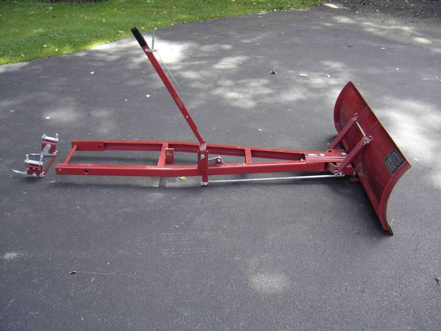

Cadmandu 67 #12 Posted September 5, 2016 Thanks guys, I went to look at the tractor today. It is a 1987 21-12K804 / 20467 He wanted 950.00 and I offered him 1K for it and a set of chains and this blade. He said noway, what is this all worth. I drove it and it ran and shifted well. One of the test lights was missing and like you guys noticed the deck covers. 1 Share this post Link to post Share on other sites
Wheel-N-It 2,978 #13 Posted September 6, 2016 (edited) How much did he want for the whole package? Also how many hours on the meter? Edited September 6, 2016 by Wheel-N-It Share this post Link to post Share on other sites
Aldon 4,832 #14 Posted September 6, 2016 The blade is in good condition. ~300. The piece that attaches to rear axle is 50-75 by itself in good condition. IMO 1k is fair for package unless low hours. Hard to say for certain just from photo. Could be worth more. If no hour meter it's harder to say without a closer inspection. 1k should not have been so low as to not elicit a counter offer from the fella. I wonder if he is a Redsquare fella himself? Share this post Link to post Share on other sites

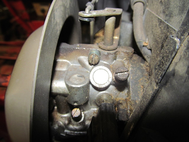

Ed Kennell 46,247 #15 Posted September 6, 2016 21 hours ago, wallfish said: The slower start issue might have more to do with the carburetor than the engine itself. I think most of the Magnums came with a fixed jet carb and have bigger or more holes in the choke plate too. As a test, remove the air cleaner and choke it with your palm while starting and see if it starts much quicker than using the usual choke. Easier done with 2 people.. My 1991 312H with the magnum12 has adjustable jets in the carb. I tried the full choke with my palm as you suggested John and I still had to crank is quite awhile. I did notice after a short crank, I had fuel on my hand dispelling my thought that the fuel was draining back to the tank. Here's the good news, with the air cleaner off, I noticed the throttle cable was improperly adjust causing the governor spring to actually put negative tension on the governor lever at idle throttle. I readjusted the throttle cable and the magnum now starts nearly as quickly as my Ks. Thanks John. Share this post Link to post Share on other sites
wallfish 20,057 #16 Posted September 6, 2016 3 hours ago, Ed Kennell said: My 1991 312H with the magnum12 has adjustable jets in the carb. I tried the full choke with my palm as you suggested John and I still had to crank is quite awhile. I did notice after a short crank, I had fuel on my hand dispelling my thought that the fuel was draining back to the tank. Here's the good news, with the air cleaner off, I noticed the throttle cable was improperly adjust causing the governor spring to actually put negative tension on the governor lever at idle throttle. I readjusted the throttle cable and the magnum now starts nearly as quickly as my Ks. Hmmm, guess I'll have to take a closer look at mine again. It's a M18 that starts slow and when I palm it, it starts right up, but maybe it's something else like you are explaining. Doubt it's the same thing since the throttle is usually at full when starting. Maybe an air leak??? I also thought the fuel was siphoning back to the tank too or the bowl was leaking but that's not the case. Do you usually start your engines at idle? Maybe I should try that too. Share this post Link to post Share on other sites
Ed Kennell 46,247 #17 Posted September 6, 2016 Yeah John, for cold starts, most of mine seem to start best at full choke and just a little throttle, then open the choke as soon as it fires.. If I get a contrary one like this mag 12 was, I try everything. I'm thinking because the throttle/governor cable was not set correctly, I may have actually been flooding the engine. The only other mag I had was a 1995 314H. I sold that one at the show this summer because it was slow starting... now I wonder? governor. Share this post Link to post Share on other sites
prondzy 3,889 #18 Posted September 6, 2016 I guess I'm not into WH that new, but unless it has 100 hrs on it, the tractor in my opinion isn't worth more than $400 tops, the blades can be bought for $100-200 all day long you can buy new chains for $50-$100 I think that this tractor is way overpriced but its my . I would say keep looking. 1 Share this post Link to post Share on other sites
