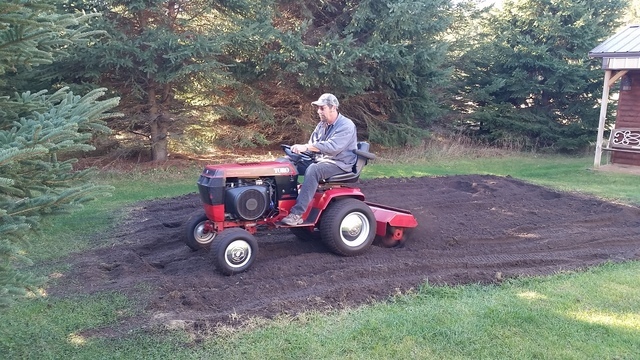

I have a 36"  one on my 520 and the Onan doesn't even know its ther but Steve does have a point about ground engageing stuff and mauals that one can't argue. No you would not be able to use on on all three unless you get real creative with some custom mounts. They weigh quite abit so make sure your rock shaft & cable are in good shape and always use a lift assist spring. The same tiller should work on any 3/4/500 series tractor.
  • Like 3
stevasaurus
Jim's right...these horses were made to do this kind of work and any one of the ones you have would be OK for sure.  I was just sayin' if the C-120 was a manual transmission...that is the one you want to use.   Another reason to equip the C-120...you might find a tiller for that easier...might be less money then for the 520...and if you decide to sell it, I think you will have a larger market.
    Is that a great picture of Jim trying to keep his lines straight of what??  :ROTF:
