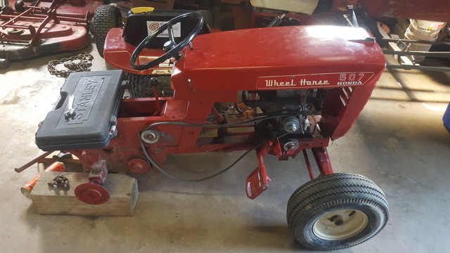

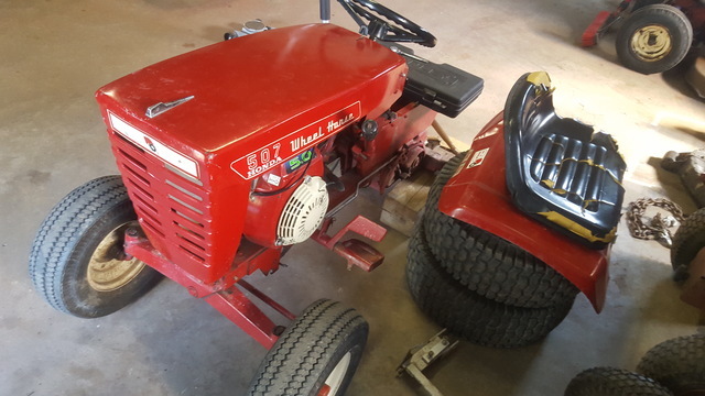

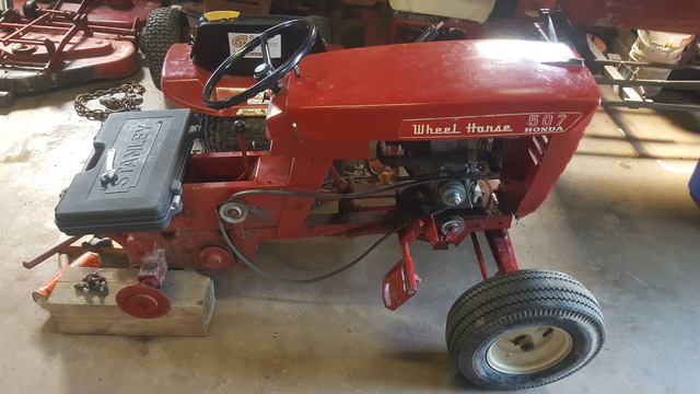

Lane Huls 146 #14 Posted August 11, 2016 The "507" in all its bad axle glory Share this post Link to post Share on other sites
