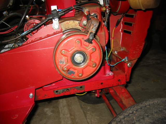

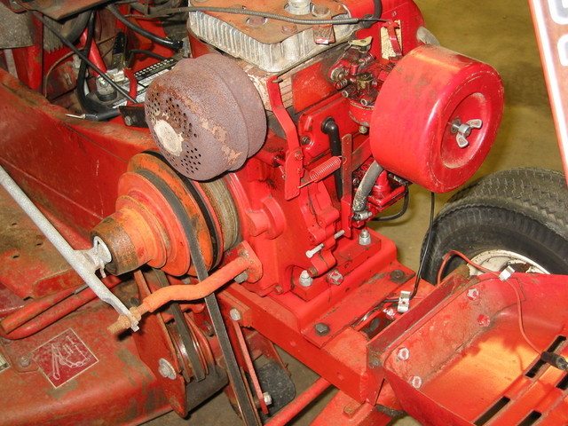

pfrederi 20,677 #8 Posted July 24, 2016 There were a couple of different Electric PTO clutches used over the years. Can you post a picture of yours??? Share this post Link to post Share on other sites
j main 5 #9 Posted July 24, 2016 Thanks guys for all your help each one of you are very kind Thank you I donot have away to take pics sorry Jeff Share this post Link to post Share on other sites

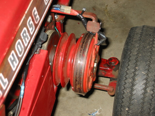

pfrederi 20,677 #10 Posted July 24, 2016 3 hours ago, j main said: Thanks guys for all your help each one of you are very kind Thank you I donot have away to take pics sorry Jeff Does your PTO look like this? 1 Share this post Link to post Share on other sites
j main 5 #11 Posted July 24, 2016 Yes the one in the pic is just like mine thats what I need Thank you for shareing this pic if any one knows where I may beable to find a used one I would be VERY greatfull Jeff Main Share this post Link to post Share on other sites
pfrederi 20,677 #12 Posted July 24, 2016 If it is a bearing they are replaceable. First off try this test with the engine not running. turn the ignition switch to run. Then turn on the PTO switch, you should hear a loud click as it engages.. No click there may be a bad electrical connection or the field coil may be dead. If it clicks then we will proceed to pull the Clutch and check the bearings. 2 Share this post Link to post Share on other sites
ztnoo 2,302 #13 Posted July 25, 2016 I'm seeing lots of electrical tape and a modular connectors which supplies 12V DC to power the PTO electric clutch. I would be taking a very close look at all the wiring and connectors. An old and ignored, or convoluted, half-assed repair may not supplying voltage, or it even may be going to ground. A close examination of all of those electric components may reveal an obvious problem. It may also may not reveal a visible problem. I'd start with a thorough and complete inspection and cleaning of connectors, and look for intermittents and bare sheathing on the clutch wiring. And use dielectric grease upon reassembly on the connectors. At the very least it will eliminate some possible problems. 1 Share this post Link to post Share on other sites

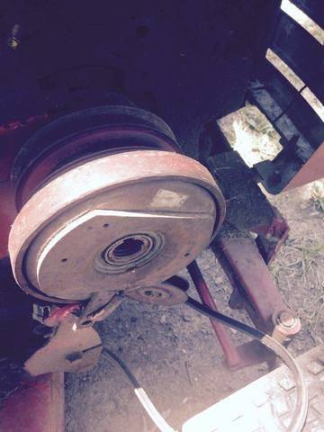

j main 5 #17 Posted July 26, 2016 Hi Guys Finally fig this out this is what mine looks like my shaft is 1inch PLZ PLZ HELP ME I have looked all over today and found out to top it all off mine is on repairable I did get this parts number is what I need 101473 but was told this part is discountinued my luck dose any one know where I can find A NEW ONE at? Thank you Share this post Link to post Share on other sites
953 nut 66,651 #18 Posted July 26, 2016 Did you read the post I gave you about these clutches? In reply # 32 @pfrederi gave you the information on a bearing that will work! 1 Share this post Link to post Share on other sites
j main 5 #19 Posted July 27, 2016 Yes mine is total shot and cant be rebuilt I checked into it any ways Ineed this part Been looking ALL over no luck the part number is 101473 and its discontinued I dnt know what eles to do been VERY stressed out over this Thank you for all your help Jeff Main Share this post Link to post Share on other sites
pfrederi 20,677 #20 Posted July 27, 2016 (edited) Yours is the older style that requires a 1"NC bolt to push it off the crankshaft. (Just thread the bolt into the open hole in the end of the PTO and it will pull the PTO unit off the crankshaft. The bearings in it are replaceable. Did you ever test the field coil as I suggested above? If it has to be replaced you can use the newer style as shown in my pictures above. What you do need to know if you want to replace it is the diameter of your crankshaft 1' or 1-1/8" Another alternative (cheaper maybe) is to replace it with a manual PTO. Edited July 27, 2016 by pfrederi Share this post Link to post Share on other sites

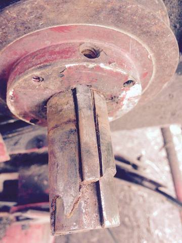

j main 5 #21 Posted July 27, 2016 Heres a pic what my shaft looks like Share this post Link to post Share on other sites

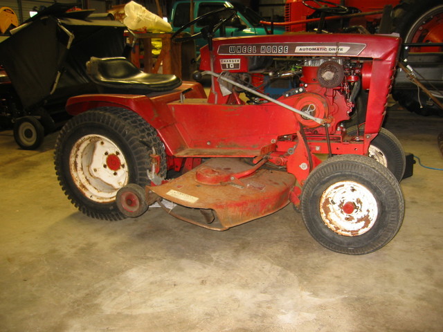

pfrederi 20,677 #22 Posted July 27, 2016 That is mess. Place a want add here and search ebay Clutches show up fairly often. (After you get over sticker shock you may want to consider going to manual PTO) You are going to have to remove the remains of the Electric PTO clutch sleeve and a new key would be in order. This is a picture of a manual set up on a Charger 10 yours would be the same. 1 Share this post Link to post Share on other sites
