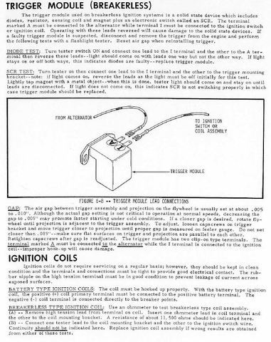

pfrederi 21,172 #5 Posted July 7, 2016 You can test the coil easily with a multimeter. Trigger testing requires pulling the flywheel. 3 Share this post Link to post Share on other sites

tbarnhart 240 #9 Posted July 8, 2016 I'm guessing, from reading the manual that pfrederi posted above that your readings are probably 11.4-11.7 Kohms. I would say that that is good. The ground of the coil as well as the ground of the trigger module is important, so that may have been the problem. It's also possible that even though the trigger module is working now, it may be intermittent or sensitive to heat. It's not uncommon for electronics to work when cold, but fail when hot. You could reinstall the original coil and see if it changes, and run it for a few minutes to let the ignition system get up to temp and see if anything happens. If you have to replace the coil, they're probably easier to find than the trigger module. Keep us updated. 3 Share this post Link to post Share on other sites
Aldon 4,833 #10 Posted July 8, 2016 7 minutes ago, tbarnhart said: I'm guessing, from reading the manual that pfrederi posted above that your readings are probably 11.4-11.7 Kohms. I would say that that is good. The ground of the coil as well as the ground of the trigger module is important, so that may have been the problem. It's also possible that even though the trigger module is working now, it may be intermittent or sensitive to heat. It's not uncommon for electronics to work when cold, but fail when hot. You could reinstall the original coil and see if it changes, and run it for a few minutes to let the ignition system get up to temp and see if anything happens. If you have to replace the coil, they're probably easier to find than the trigger module. Keep us updated. Great Post. My thoughts as well. Share this post Link to post Share on other sites

pfrederi 21,172 #17 Posted July 20, 2016 You have to pull the flywheel then it is easy. Check out the test you should do once it is off...(above) Share this post Link to post Share on other sites
