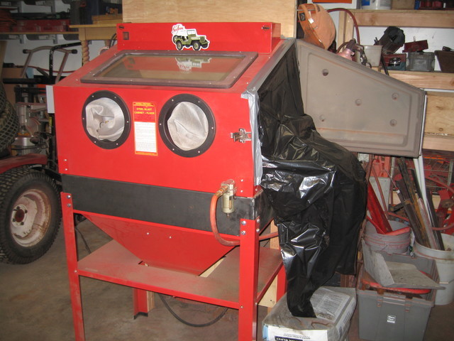

Here's a few mods to my harbor freight blast cabinet. Added 6" to the bottom. Also taped a garbage bag over the door opening when doing my 1045 frame.
  • Like 8
Is the extra depth for additional height of pieces needing blasted or for additional media capacity?
Just now, Aldon said:
additional height
:text-yeahthat:
  • Like 1
