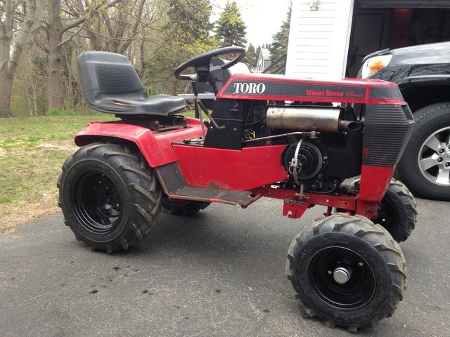

image.thumb.jpeg.42fd16b0f6f34c34ceb90ba7545561f8.jpegI would take a look at the pto clutch adjustment. The pto is right under the exhaust, so this is best to do when the engine is cool to prevent burns. There is a threaded section on the engagement rod, jut give it one turn at a time until the pto lever has a nice snap upon engagement. Have had the same issue, and it is a high pitch squeal from the clutch on the pto slipping. Gluck! (Sorry it's upside down, but u can see the adjustment if you do a handstand)

I turned your picture around for you.  :)

thanks - the adjustment was a little sticky but its a winner.  I appreciate your help!  god bless the internet...
