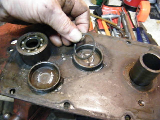

Are you supposed to tack weld bearings
WHX??
Noooo they should not be welded at all... just a good snug friction fit on both the shafts and the receivers in the side plates. Once you get things cleaned up and the new bearings in hand. Check  for that fit.

ooooo....these are not the bearings welded but a sleeve or race for the bearings???
Racinbob
Yes, that's correct. Pop those bearings out of there and you'll see. :)
There may be a thin washer thingy under one or more of them. Make note of where it was.

Here's a good shot of what is holding the bearings in place as well as the...................thingy...............I'm talking about. :D

1.  Do not weld anything in the transmission!!
2.  Bearings need to be flush with the top of the ring they sit in.  Pinching the shafts may occur if they are not right.
