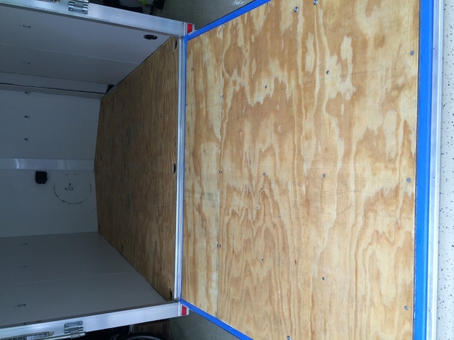

Fun Engineer 863 #53 Posted May 27, 2016 Monstaliner arrived yesterday, trailers in the garage ready for floor prep and sealing. Monstaliner recommended I seal the plywood with oil based polyurethane to reduce the amount of liner absorption into the wood. So I have to sand and clean the floor twice Trailer project will have to wait a day as we're heading down state to spoil our new grandson. Share this post Link to post Share on other sites

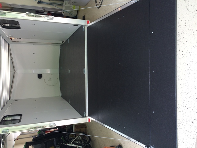

Fun Engineer 863 #54 Posted May 27, 2016 (edited) Step one. Remove tie-downs, clean floor with acetone, sand and apply sealer. Here's a pic with the trailer floor sanded and half the ramp done. And here's a shot with sealer. Edited May 27, 2016 by Fun Engineer 7 Share this post Link to post Share on other sites

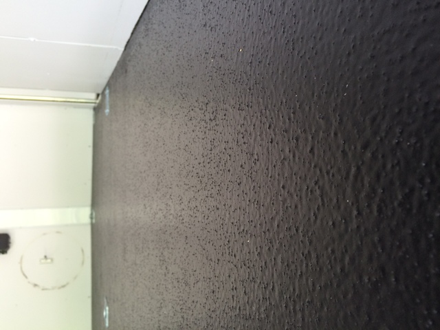

Fun Engineer 863 #55 Posted May 29, 2016 (edited) So here are the results of my two coats of Monstaliner installation. Not sure why these all load sideways. Not sure why the finished product has a sand texture to it. It is supposed to be more of an orange peel texture that you can make rougher with additional rolling. I'll have to give them a call on Tuesday to see why it turned out this way. At least it will be more slip resistant Edited May 29, 2016 by Fun Engineer 4 Share this post Link to post Share on other sites
Racinbob 13,125 #56 Posted May 29, 2016 I don't believe I thought what I just thought for a moment. 'Why is he doing the wall?' Looks great. 3 Share this post Link to post Share on other sites

JPWH 6,544 #58 Posted May 29, 2016 I like the texture. Floor looks nice. 1 Share this post Link to post Share on other sites

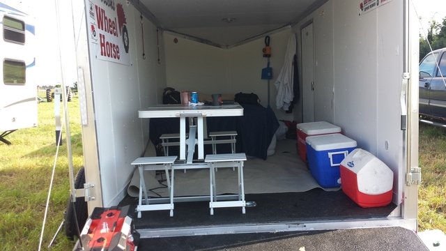

WHX?? 58,043 #60 Posted May 30, 2016 Looks nice....not as rough as the herculiner but still non skid. I probably should have removed the tie downs like you did. I just went around them. Went to local big box and picked up a cheap area rug to roll out if we have to tramp in it. Couple of bungees to hold it up out of the way 4 Share this post Link to post Share on other sites

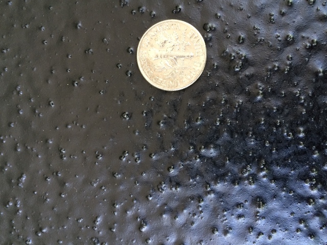

Fun Engineer 863 #65 Posted June 16, 2016 So after 5 phone calls and numerous emails I finally reached the CEO on his private cell phone. I don't think he realized that he includes it in all his email correspondence. Don't know why I didn't catch that earlier. I told him that I think I figured out that the pigment wasn't mixed properly even though I mixed it according to the instructions. I took my wife's small jewelry file (don't tell her I borrowed her tools) and filed a couple of the pieces of grit left on the can. They turned to powder immediately. Heres what he think happened. The is bought in small pellet form and ground up, screened and then added to the bed liner. He thinks the screen has a hole in it or that the batch I received was near the bottom of the vat and was contaminated. He's checking with customer service to see if they have had other complaints. I have to believe they have. Either way he's sending me an additional gallon of product to apply after I sand the existing surface. Not happy that I have to remove the tie-downs and mask everything off again but that's the way it goes. At least I'll have three layers of bed liner. This is going to have to wait until after the show as I'm heading south to spend some time with my Colorado son and our other son and their new baby this weekend. As always I'll post pictures of the refurbished floor when completed. Right now I'm in grandson and wax the tractors mode. Cheers, Share this post Link to post Share on other sites

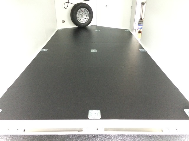

Fun Engineer 863 #69 Posted August 17, 2016 Trailers home from the factory and looks great. Half the trailers new;) Got it all waxed today and tomorrow the third coat of Monstaliner goes on. Had them install a cabinet and ramp door spring cover while in the shop. Will post pics when I finish the floor. 5 Share this post Link to post Share on other sites
Fun Engineer 863 #70 Posted August 30, 2016 Been so busy that I forgot to post pictures. Having an awful time power washing the house this year. The maple trees are stressed and producing a lot of air born sap mist that is settling on everything. That and the pollen has created a real mess on the siding with mildew and dirt. Done with my whine. Here's some pics. Also coated the roof with Henry Solar-Flex Roof Coating to reflect the heat and to reduce the amount of aluminum staining on the sides of the trailer. 3 Share this post Link to post Share on other sites

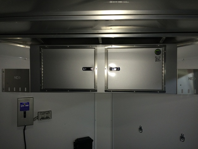

WHX?? 58,043 #71 Posted August 30, 2016 (edited) Glad to hear you got the dent fixed! Those cabinents are cool Dave, where did you get them? Look like some kind of factory option?? Camped in mine at the Le Suer show & worked great! I think tent camping is over for me! I still have to do the @Shynon bug screens. I also had a air mattress that I used for the first time. Problem is the air matress has a built in pump that runs on 115 vac. Brought an extra truck battery & connected it to a small inverter which worked good. Also ran cell phone chargers & camp tunes off it. I think what might be in the future is to mount a battery box on the tougue & wire it to the inverter in a cabinent inside. Maybe a battery isolater wired to the RV connector so the battery charges when the truck is running. Maybe even do a permanent power thing like yours in case we camp where power is available?? Also need to get a permanent spare tire (I borrow the one off another trailer) and mount it somewhere...preferably outside tho. Edited August 30, 2016 by WHX7 1 Share this post Link to post Share on other sites
Shynon 7,656 #72 Posted August 30, 2016 Dave, trailers looking really nice 1 Share this post Link to post Share on other sites
Fun Engineer 863 #73 Posted August 30, 2016 (edited) Thanks Jim and Tom. The cabinet is aluminum made by NEO in their trailer factory. They're custom made to fit each of their trailer models. I think this one is 48"w X 17" h. It has CNC aluminum hangers with shelves on each side. Lots of room inside. That also make universal cabinets. You'll love camping in the tramper. Way better than tenting. Jim Check out this site www.tnttt.com. Go to the cargo trailer conversion forum for trailer ideas. It's mind boggling what some people have done to their trailers. Edited August 30, 2016 by Fun Engineer 2 Share this post Link to post Share on other sites
