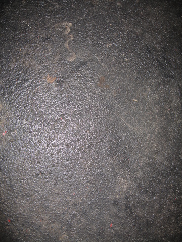

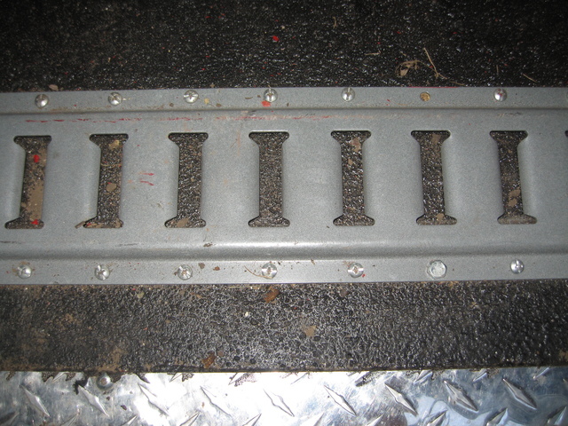

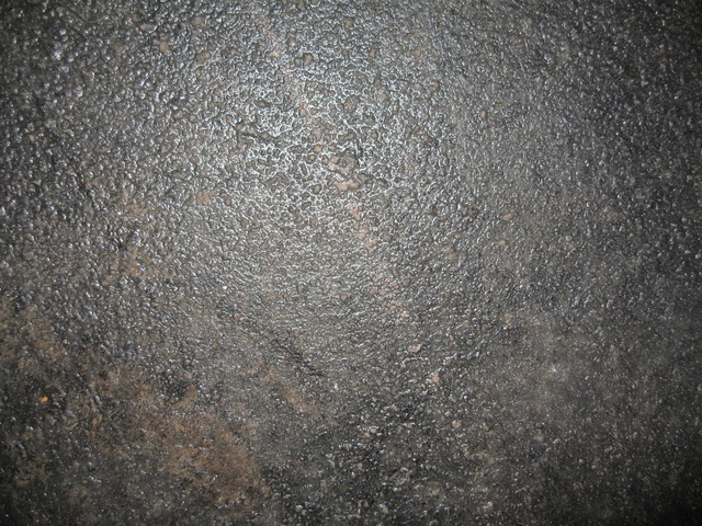

Shynon 7,545 #2 Posted May 1, 2016 (edited) I have herculiner roll on truck bed liner on my floor, took 2 gallons for a 16ft enclosed trailer. e track on the floor, mine is used for storage and camping at the shows. Rougher texture can be swept out, sometimes use a vacuum. Oil drips cleaned up with some orange cleaner. Best picture I have. Edited May 1, 2016 by Shynon 7 Share this post Link to post Share on other sites

Shynon 7,545 #8 Posted May 2, 2016 I put down my herculiner 1st then put down the e track. 2 years no marking or tears of any kind. Rough texture,not slippery, also on the ramp gate. Share this post Link to post Share on other sites

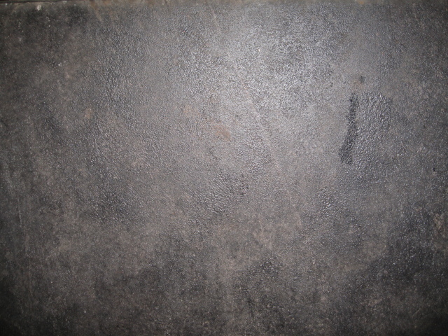

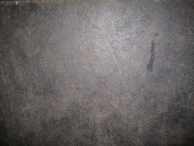

Shynon 7,545 #21 Posted May 4, 2016 Excuse the dirty floor still in storage mode. 2 Share this post Link to post Share on other sites

WHX?? 55,878 #23 Posted May 4, 2016 12 hours ago, Shynon said: Excuse the dirty floor still in storage mode. Nice flecks of RED dirt Tom 2 Share this post Link to post Share on other sites
Fun Engineer 863 #24 Posted May 5, 2016 (edited) That looks good Tom. Did you have to use the narrow roller they provide or did you use something else? Seems like that would take forever. And were you able to adjust the amount of texture via the roller or is it just one texture? I appreciate everyone's thoughts and opinions. Dave Edited May 5, 2016 by Fun Engineer Share this post Link to post Share on other sites
