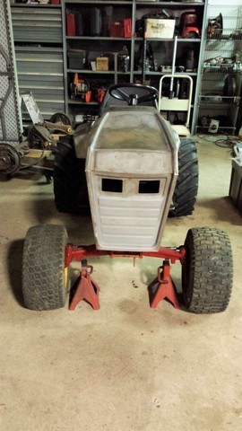

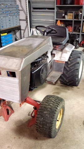

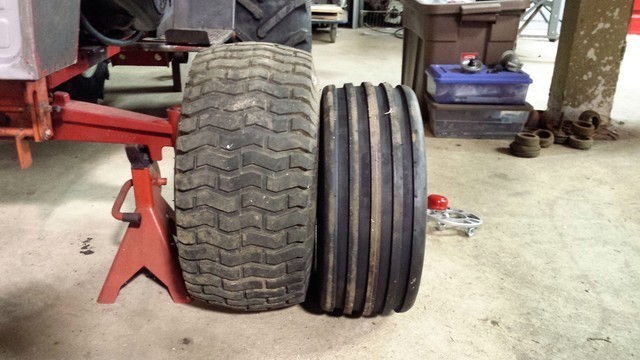

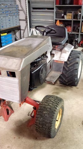

Yes, It will be wider. I've had mine mocked up with that combination (also a black hood with a swept axle) And they were 42"ish wide, they also won't clear the tie rod require a spacer.
I have 10.5" wide rear wheels made from blanks with 26-12x12's so I'm not sure how wide yours is in the back. Measuring out from frame rail it's just over 17" to the edge of tread on the front wheels.

   Thanks for the pictures! bds1984 asked a question I have wondered about.Like him I found 4 18x8.50 x16 inch golf cart tires and rims.For the price they are hard to beat.I like the idea of  larger tires for loader service in soft ground.Would you let us know the brand of ags on the rear.They look like Carlisles.Thanks again for you post.Your horse looks so good unpainted I would think about clear coating the bare metal.Kinda reminds me of the bare metal WW2 aircraft.JimAnderson

Thanks Jim, They are the Carlisle tru power.  Really wanted the firestones,but I  just couldn't justify the price difference.
