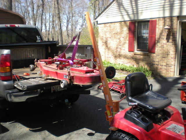

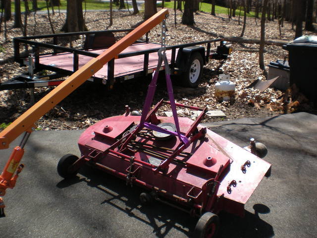

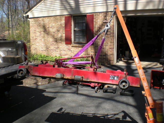

One Way to Handle a 60" Deck

What? No pics of the front wheels of the tractor off the ground? :lol:
  • Like 3
AMC RULES
Easy pick, looks like you've got this John.
No riggers necessary.   :handgestures-thumbupright:

shallowwatersailor
That's why I have Mrs. Sailor sitting on the hood.  :ROTF:  Actually I left the snow blade on and elevated so that the additional weight would transfer to the front. It worked!

Wishin4a416
Yes sir John! More than one way to skin a cat. The older I get, the more I look for the easy way of doing things.

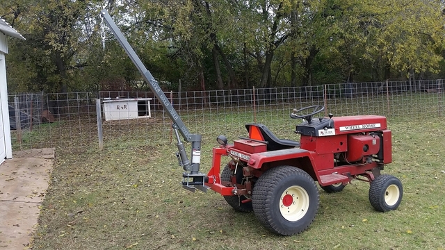

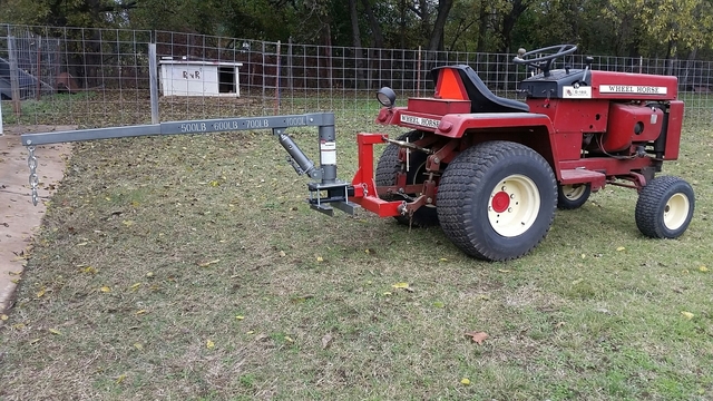

elcamino/wheelhorse
John Do, you have a picture of how the crane is mounted ?
  • Like 2
JAinVA
I second Jim's question.That looks like something all us oldsters could use. Love those HF cranes.I have had one mounted to my log splitter for ten years.Electric winch and skidder tongs means no liffing more than the old body can stand .JAinVA

shallowwatersailor
Here is the thread in Tom and Scott's vendor section that has a few views. They made the 5xi 2" receiver, and I had Tom make the mount for the crane. I have been very happy with both.
