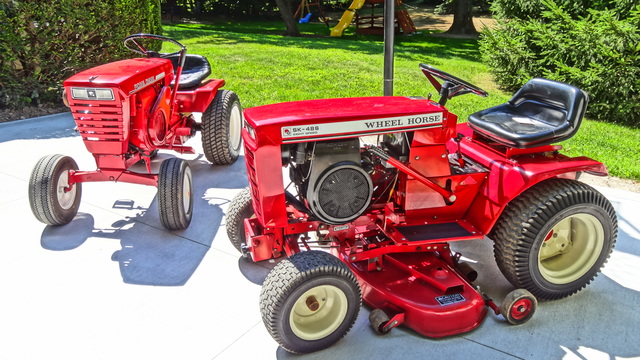

Al C. 1,480 #1 Posted April 14, 2016 I picked up an SK-486 about a year ago. It is in great condition with about 1300 hours on the meter. The only problem I have with it is that it's steering is very stiff. It takes two hands and a good bit of effort. Meanwhile, my 1067 steers like a feather with a single finger. Is the difference related to the wider front tires and larger engine (heavier) on the 486, or is there likely something I can correct on the 486 to make the steering lighter? 3 Share this post Link to post Share on other sites

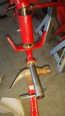

cleat 9,405 #14 Posted April 15, 2016 (edited) All of my 520 now have a thrust washer under the steering spindle that did not come with a thrust bearing. If they come with a thrust bearing (swept axle 520's) then they get cleaned and regreased. All steer easy. For non-reduction though I must say the 416 steers easier and it has not been upgraded yet. You can just make out the teflon washers under the spindles. This makes a world of difference, I am sure a bronze thrust bearing would do the same thing. Edited April 15, 2016 by cleat 3 Share this post Link to post Share on other sites
Al C. 1,480 #15 Posted April 15, 2016 Thank you! ... everyone for the ideas and suggestions. My wife and I are on a road trip. Great traveling!!! I will start taking things apart when we get home. There are a lot of ideas here that I haven't tried yet, so I am optimistic. Interestingly, the steering wheel on the 1067 is two inches larger in diameter than the 486. I'm guessing this probably makes the 1067 a little easier also. There will be pics and results once I start taking things apart. Share this post Link to post Share on other sites
Kegler 68 #16 Posted April 15, 2016 Looks like a calendar shot ! 2 nice horses. Since it is better with no load I would check the spindles, and even the tie rod ends, for ware and binding. Good luck. Share this post Link to post Share on other sites
PaulC 342 #17 Posted April 15, 2016 really is a very cool picture with very nice horses you have there. I did a similar upgrade to what Cleat did but i used needle bearing thrust bearings i got from mcmaster carr, 3/4" bore is whats needed. I installed them on 2 417's that were steering very hard and it improved them greatly, one more then the other and with no front mounted attachments its like it has power steering. i did have to grind the top of one or two of the axels to accommodate for the thickness of the thrust bearing but it was well worth the effort. http://www.mcmaster.com/#standard-rolling-element-thrust-bearings/=11zufc2 there is the link to the page to give an idea of what i used. Share this post Link to post Share on other sites

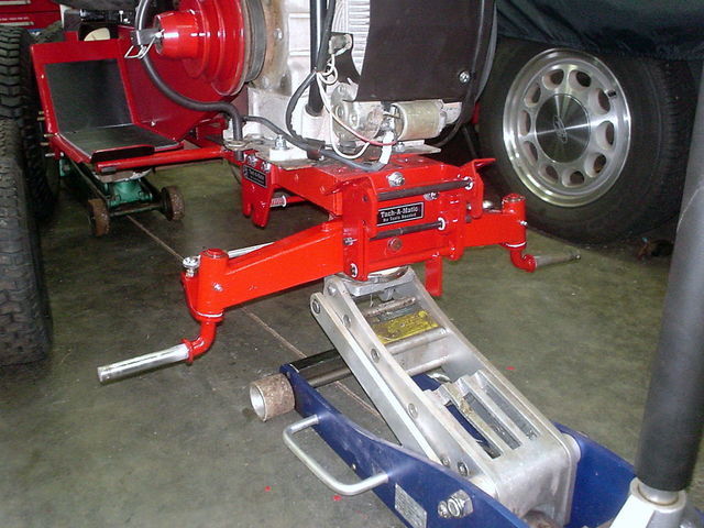

Al C. 1,480 #22 Posted April 22, 2016 Well, we are back from our road trip and yesterday I had a chance to do some work to lighten the steering on my 486. I decided to start simple and test some probable causes before getting into the more complicated. To start, I lifted the front end, took weight off the front wheels, cleaned and thoroughly lubed (without taking apart) all of the spindle and pivot joints. They were pretty dirty but not dry. I flushed them with WD-40 and then packed them with fresh grease. Without weight, the wheels now swing side to side with a feather touch! I thought I had solved it. So I lowered the tractor and tried it out. No improvement! Before taking everything apart I decided to test reducing the traction/friction on the front turf tires. I cut two, two inch diameter discs out of a two by four and put them under the front tires to simulate a narrower profile tire. Sure enough there was a big improvement. Then I looked up some of the technical data about the 486 and the 1067 that I am comparing it against. Here is what I found: SK 486 1067 Tractor Weight 655 597 Mower Deck 200 0 Total Weight 855 597 Steering Wheel Diameter 13 15 Wheel Dimensions 16x6.5-8 16x5.5-8 Wheel Profile Flat Round Next, I am going to remove the spindles, add a washer, clean and grease them. But I am beginning to think that the 486 steers harder because it is heavier, the tires have a much flatter footprint, and it has a smaller steering wheel than the 1067. I'll let you know the results. 1 Share this post Link to post Share on other sites
gawald 30 #23 Posted April 22, 2016 I had a D180 that had been used hard before I got it. The front steering system was in bad shape. The vertical spindles that went into the front axle had thrust bearings to make steering easier. There was a flat washer on the bottom of the spindle, a needle bearing assembly (looks like flat donut with cylindrical rollers in it), and a top flat steel washer next to the front axle. My needle bearing assembly was destroyed with all the rollers missing. Since I worked for the Torrington Company who made the bearings, I called the plant and was sent two needle thrust bearings and 4 washers directly from the plant. Steering was great after that. This was over 30 years ago but as I recall the spindles were 1" in diameter. Loved my old D180 but sadly had to sell it when I moved. Use of needle thrust bearing assemblies compensates for heavy weight. The bronze bushing idea is good too, but a thrust bearing should give less steering friction. PS: the steel washers are specials - thin and heat treated to make the raceways for the thrust bearing. 2 Share this post Link to post Share on other sites
Tankman 3,528 #24 Posted April 23, 2016 (edited) I purchase, and keep on hand, various diameter thrust washers. I find the Teflon washers interesting. Going to stock some and try 'em out. Might have to find a Vic Tanny's and start curling weights just in case the Horses decide they don't want to turn. Right now the Stallions are behaving. I get excellent service (fast) and thrust washers here: http://qbcbearings.com/BuyRFQ/ThrustB_Washer_SL_SB_I.htm# Edited April 24, 2016 by Tankman 3 Share this post Link to post Share on other sites
ronhatch 410 #25 Posted April 23, 2016 (edited) Going to install my new thrust BALL bearings on my C-101 tomorrow. We''ll see how it helps I thought that Teflon washers would work well too, but I would stack 2 of them together so they slide against each other rather then against the relatively ruff surface of the axle or spindle. Edited April 23, 2016 by ronhatch 1 Share this post Link to post Share on other sites
