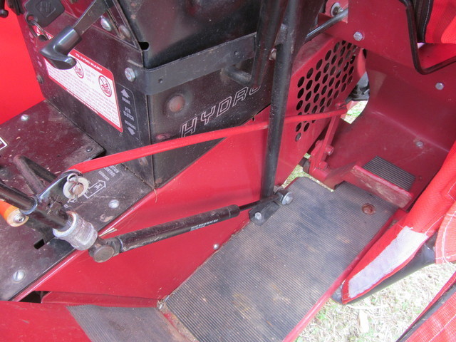

Ed Kennell 47,959 #4 Posted April 5, 2016 This may give you a better idea of the area that is blocked by the belt guard and support bar. The hood and muffler also block a lot of the upper half of the rear cylinder. The front cylinder is completely open. 3 Share this post Link to post Share on other sites

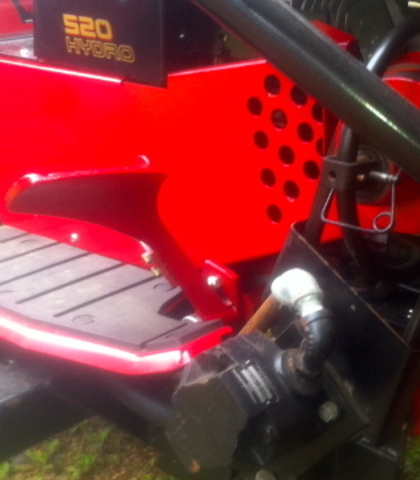

varosd 1,185 #8 Posted April 5, 2016 http://i1125.photobucket.com/albums/l581/varosd/photo1-1.jpg[/IMG] 1 Share this post Link to post Share on other sites

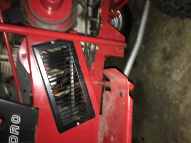

WHX?? 58,388 #16 Posted April 5, 2016 there was a pic here of a guy that cut it out and put a heating grille over it but I'll be darned if I can find it... 1 Share this post Link to post Share on other sites
WHX?? 58,388 #17 Posted April 5, 2016 This thread has some in it too Scott http://www.wheelhorseforum.com/topic/62196-plastic-belt-cover-on-pto-520h/#comment-581548 Share this post Link to post Share on other sites
Ed Kennell 47,959 #18 Posted April 5, 2016 Yeah, I've seen that grill picture also Jim. Your picture really does show how much the rear cyl is blocked by the hood stand, muffler, and belt guard. 1 Share this post Link to post Share on other sites

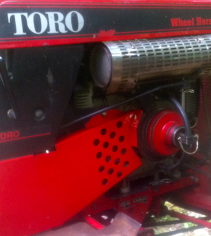

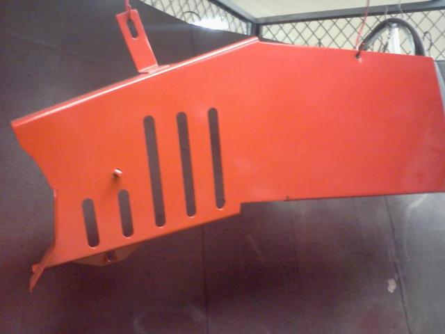

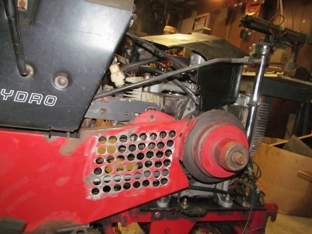

AMC RULES 37,261 #21 Posted April 5, 2016 A few examples that have been shared here... 4 Share this post Link to post Share on other sites

WHX?? 58,388 #24 Posted April 6, 2016 19 hours ago, WHX61/3 said: put a heating grille over it but I'll be darned if I can find it... 19 hours ago, Ed Kennell said: Yeah, I've seen that grill picture also Jim AMC Rules found it Ed...gotta love that mod! I showed it to my guys here at the heating shop and they got a charge out of it & suggested one with dampers for cold weather running... 3 Share this post Link to post Share on other sites
TDF5G 2,074 #25 Posted April 6, 2016 (edited) On 4/5/2016 at 5:58 AM, varosd said: http://i1125.photobucket.com/albums/l581/varosd/photo1-1.jpg[/IMG] I don't own a 520 series but the stamped custom vents would be my favorite. They look cool! It seems there are differences of opinions on venting the rear cylinder, although some claim it isn't necessary, it sure won't hurt anything either. Edited April 6, 2016 by TDF5G 1 Share this post Link to post Share on other sites
